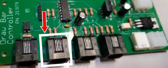

Install the Power Drawbar Foot Pedal
  1. Put the foot pedal in the desired location (near the front of the machine).
  2. Route the foot pedal cable around the back of the machine and up through the energy chain.
NOTICE! Don't route the foot pedal cable underneath the machine. If you do, it could interfere with the casters on the coolant tank, which may cause damage to the foot pedal cable.
  1. Remove the four screws on the corners of power drawbar's main control box that secure it to the Z-axis motor mount. Then, set aside the screws.
Figure 6: Power drawbar's main control box.
  1. Connect the RJ-11 connector from the foot pedal's cable to the DB2 port on the power drawbar control board.
Figure 7: DB2 port on the ATC control board.
  1. Replace the power drawbar's main control box on the Z-axis motor mount.
  2. Use cable ties to organize the cables.
