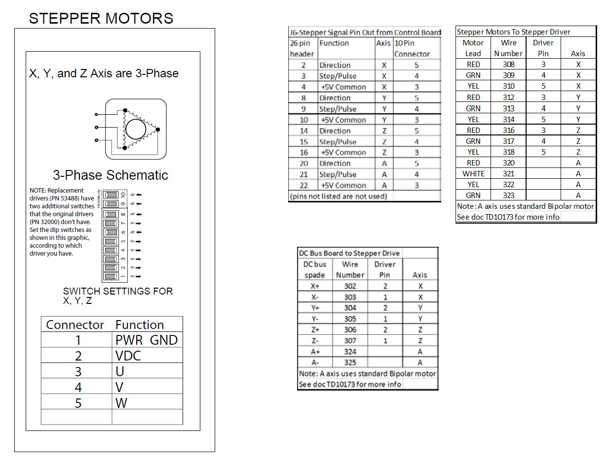

PCNC 1100 Knowledge Base
Stepper Connections - PCNC 1100
