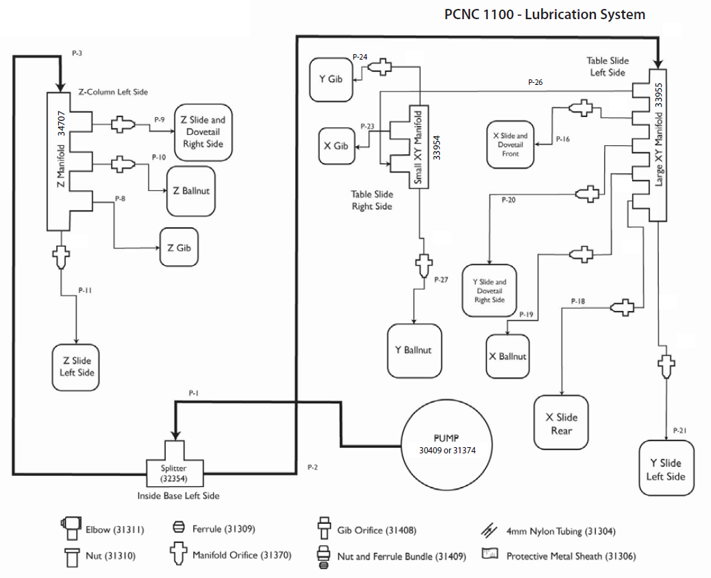

PCNC 1100 Knowledge Base
Lubrication System - PCNC 1100
