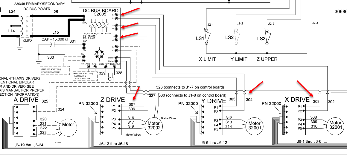

      1. J6-1 - J6-6 (X-axis)
      2. J6-7 - J6-12(Y-axis)
      3. J6-13 - J6-18 (Z-axis)
PCNC 1100 J6 Ribbon Cable
      1. 302/303 (X-axis)
      2. 304/305 (Y-axis)
      3. 306/307 (Z-axis)
PCNC 1100 Stepper Driver Power Wires

Inspect the DC-Bus board
    1. If the green LED is not illuminated: Go to All Axes Won't Move When Commanded - PCNC 1100

  3. Based off of the chart, measure the resistance of windings at the green connector on the axis driver.
Axis
Probe
Resistance
From (black probe)
To (red probe)
X
308
308
309
309
310
310
0.5-2.0 Ω
Each wire
>1 M Ω or OL
Y
312
312
313
313
314
314
0.5-2.0 Ω
Each wire
>1 M Ω or OL
Z
316
316
317
317
318
318
0.5-2.0 Ω
Each wire
>1 M Ω or OL
Resistance across leads on all phases for X, Y and Z should be about the same. Deviation may indicate a problem. This does not apply to the A-axis.
