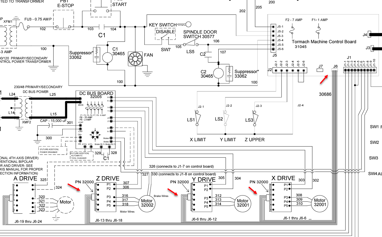

PCNC 1100 J6 Ribbon Cable
      1. 302/303 (X-axis)
      2. 304/305 (Y-axis)
      3. 306/307 (Z-axis)

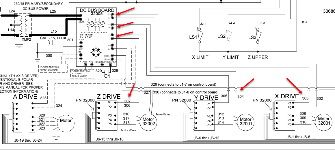

PCNC 1100 Stepper Driver Power Wires

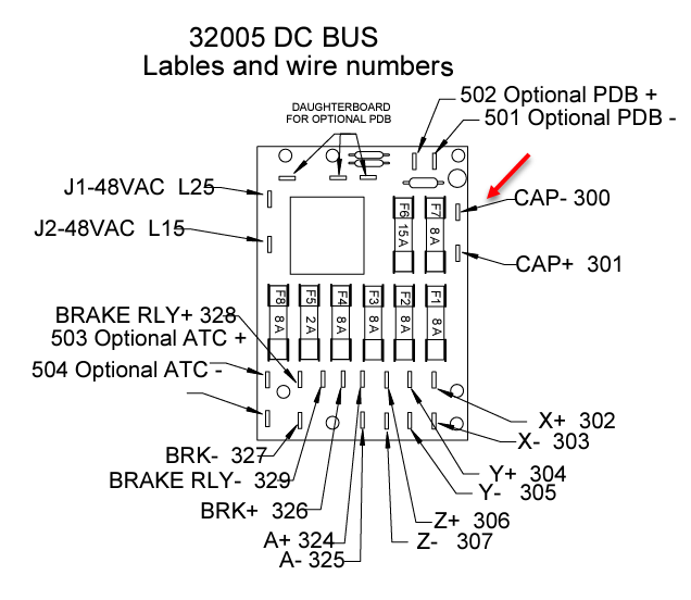

Inspect the DC-BUS Capacitor (C1)
Reason: The C1 (DC-BUS) capacitor is defective.
  1. Power off the machine. Then, unplug the green power connectors on all of the axis drivers (X, Y, Z, and A).
  2. With the electrical cabinet door open, power on the machine.
  3. Examine the green LED on the DC-BUS board, and then twist out the Emergency Stop button and press the Reset button. The green LED should come on.
  4. Push in the Emergency Stop button.
    1. If the LED goes out in two seconds or less, the capacitor is defective and must be replaced. If the LED takes five seconds or more to go out, the capacitor is OK.
  5. If the results are not conclusive, power off the machine. Then, unplug the green power connectors from the axis drivers (if they're not already unplugged).
  6. Power on the machine). Then, carefully measure DC voltage on wires 202 (common) and 203 on the DC-BUS board.
    1. If there's a DC voltage of a nominal 65 Vdc (55-75), this indicates the capacitor is OK.
    2. If there's a DC voltage of a nominal 40 Vdc (35-45), this indicates the capacitor is defective.

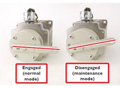

  1. Ensure the machine is referenced. Put the brake into the maintenance position to manually disengage the brake. Check if the noise continues, if so proceed to the machine specific sections.

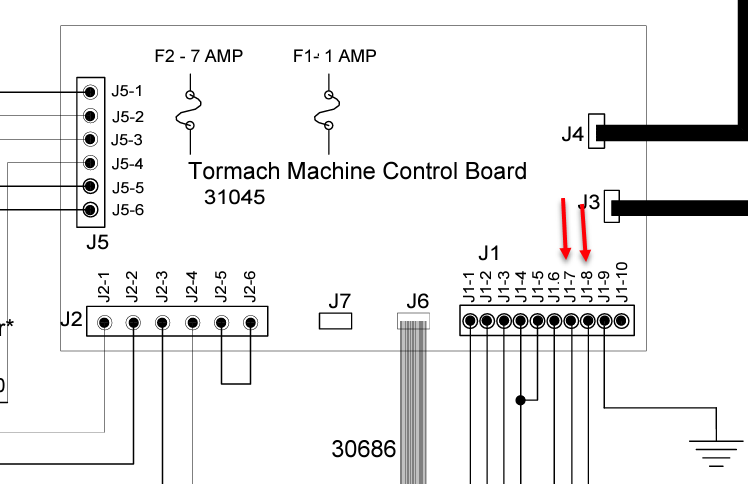

  1. With a multimeter, check for 24Vdc between wires J1-7 and J1-8 on the Machine Control board.
  2. If 24 Vdc is not present, the relay on the Machine Control board has failed and the Machine Control board needs to be replaced. If 24 Vdc is present, the brake has failed and needs to be replaced.
