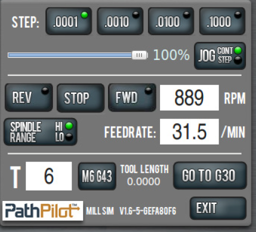

The Manual Control Group’s buttons and slider allow the operator to perform tasks related to manual control of the mill, including jogging the mill axes, changing the current tool number, feed rate, or spindle speed, and starting or stopping the spindle (see Figure 2).
Figure 2
Jogging Controls

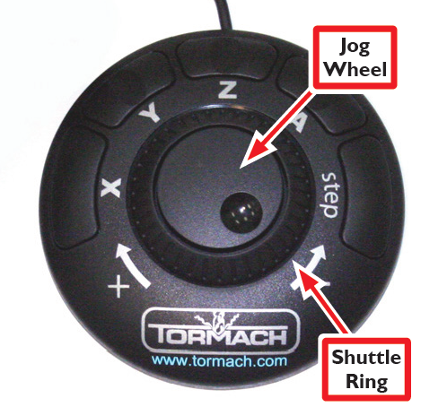

Figure 4: Jog Shuttle
Jog Shuttle
The Jog Shuttle (PN 30616), shown in Figure 4, is an optional accessory that many operators find increases productivity, especially on short-run jobs requiring extensive setting up of the workpiece and tooling.
The X, Y, Z, and A buttons are used to jog the X-, Y-, Z-, and A-axis respectively. An illuminated LED light beside an axis DRO on the PathPilot interface indicates which axis is selected for jogging. The the Step button on the Jog Shuttle cycles through the available jog step sizes. The active size is indicated by an illuminated LED light on the Step Size buttons on the PathPilot interface.

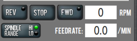

Figure 5
Ensure the Spindle Range button’s LED light (see Figure 5) correctly corresponds to the spindle belt position, either Hi or Lo; click to toggle between the two positions. For more information on the procedure to change belt position, refer to “Changing Spindle Speed Range” section later in this chapter.
NOTE: A mismatch between the Spindle Range button and actual spindle belt position will result in the commanded speed being different from the indicated RPMs. See table below for available speed ranges for each spindle option.
To specify spindle RPMs, click the DRO. Using the keyboard, type the desired RPM and press Enter.
  • Click FWD to run the spindle clockwise
  • Click REV to run the spindle counterclockwise
  • Click Stop to stop the spindle

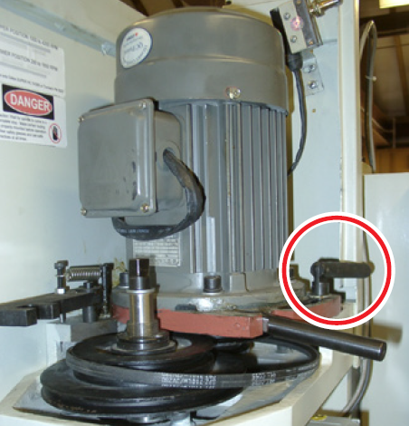

The range change is performed by moving the spindle belt from the top pair of pulleys (high speed range) to the lower pair of pulleys (low speed range).
To change belt position:
att_9_for_4455038995.png WARNING! Electrical Shock Hazard: Be sure to power off machine before making any electrical modifications. Failure to do so may result in serious injury or death.
  1. Power off mill according to power off/on procedure detailed in chapter 3, Installation.
  2. Open spindle door.
  3. Unlock motor mounting plate:
    1. On a PCNC 1100: Use the rear handle (see Figure 6)
Figure 6
  1. Pull spindle motor forward. The spindle belt slackens.
  2. Move the spindle belt from one pulley to another. (see Figure 6)
  3. Re-tighten the spindle belt so that there is approximately 1/8”-1/4” of belt deflection midway between the pulleys with a firm finger press.
  4. Lock the motor mounting plate and stow handles (if equipped) in the vertical position.
