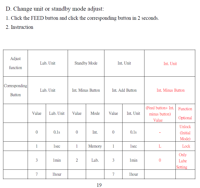

Unlock the Oiler
To access the configuration, you have to press the FEED and Interval Down Arrow at the same time.
Once accessed the setup mode, you have to use the last arrow to select the “-” Symbol, release the feed button to confirm the setup.
Change from Seconds to Minutes
Press the feed button then the interval up button until it reads “3”. Let it sit to go back to the display.
