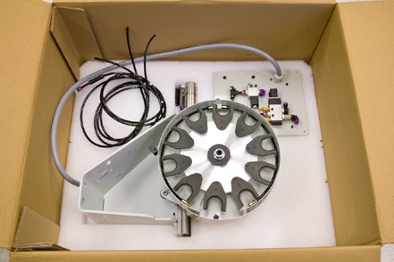

Unpacking and Checking Shipment

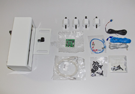

Upon receipt, carefully unpack the ATC and inspect to ensure damage did not occur in transit and also to account for all parts. If any damage is apparent, or parts missing, please contact Tormach immediately.
With an assistant, lift the ATC onto a sturdy surface or workbench to prepare it for use.
QTY
PN
ATC assembly
¼” air lines, one w/ check valve and push fitting
32226
ATC square tube mount
Hex standoffs with M8 and M10 studs
Flange nuts and washers
20
Nylon M6x16 hex bolts
32269
USB cable
ATC communication RJ-11 cable (512-515)
32783
Main power cable (503,504) terminated with 4 pin Molex and spades
35433
PDB power cable (501,502) terminated with PDB connector and spades
35434
VFD interconnect wiring kit (532-535)
33213
Coolant hose mounting plate w/ fasteners
Power drawbar power supply board
31980
Operator Manual
The following items may or may not be included, depending on machine age and power drawbar installation:
  1. Drawbar with eight spring washers
  2. Power drawbar control circuit board (if required based on age of your power drawbar installation).
  3. DC Bus Board (PN 32005)
Check these items. Notify Tormach of any damage incurred during transit or missing parts so any claims can be made within the shipping carrier’s deadline.

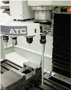

The Tormach Tooling System ATC is designed for machines with the power drawbar (PN 31706) installed. PCNC 1100 milling machines with serial numbers 1325 and lower will need to have the spindle drive upgrade (PN 31090) installed before installing the ATC. PCNC 1100 machines with serial numbers 999 and lower will also have to have the Series 3 upgrade kit (PN 32010) installed before installing the ATC.
All machines will need to have the power drawbar installed before installing the ATC. See the power drawbar manual (included with the power drawbar package) for installation instructions. PCNC 1100 machines serial numbers 1999 and lower will need to replace the old DC Bus Board (PN 30661) with the new bus board (PN 32005).
Mount ATC
Mounting and aligning the ATC to the mill is a job that is best done with two people. The ATC carousel assembly, which weighs approximately 50 pounds, is cumbersome to lift and position accurately especially when working over the mill’s chip tray. Installation goes smoothly when one person holds the ATC in position while an assistant tightens the fasteners that connect it to the square tube mount.

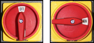

Power Off/On Procedure
Power Off
1. Push red E-stop button in
2. Click Exit on screen; when prompted click OK to power off
3.Turn Main Disconnect Off
Power On
1.Turn Main Disconnect On
2. After software loads, turn red E-stop clockwise to release
3. Press green Start button
4. Click Reset on screen

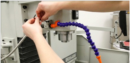

  2. If fitted, relocate coolant hose to spindle head.

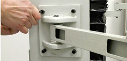

  1. If fitted, remove the left hand machine arm from mill.

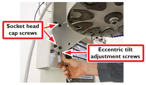

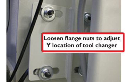

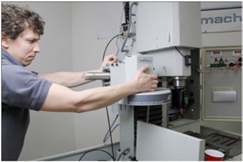

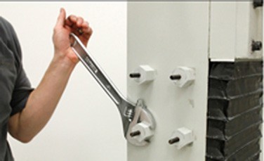

  1. Thread the M8 side of hex standoffs into mill column and tighten securely with a wrench.

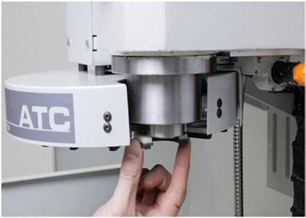

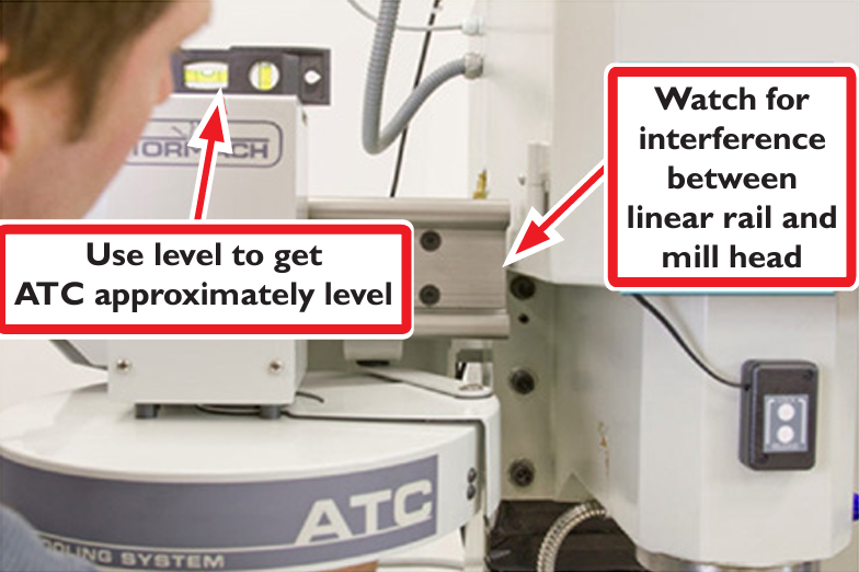

  1. Hang the tool changer square tube mount on the M10 studs. Secure with flange nuts and washers. The slots are wider than the stud to allow for minor deviations in hole locations, and to facilitate a small degree of tilt.

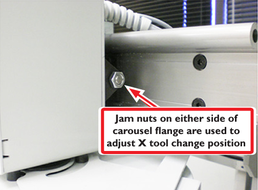

  2. With the assistance of another person, fasten the ATC to the mount using the 4 M10 socket head cap screws and flange nuts.
  3. Due to stack up of part tolerances, flexibility, and backlash in the linear bearings, the changer might settle slightly, or sag from horizontal on its mounting system. This is normal. Compensate for minor sag by tilting the mount slightly so the tool tray appears level using a bubble level.
NOTE: Be sure to adjust the mount so that the mill spindle cover sheet metal clears the ATC linear rail. The mount will be fine tuned later in the procedure. Do not tighten the flange nuts down at this point, as you will likely be sliding the ATC a bit before final tightening. Lightly snug the fasteners for now.

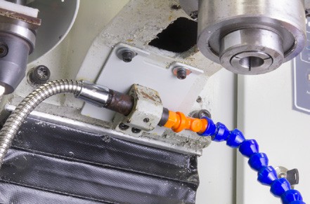

  1. Reroute the coolant hose by mounting the coolant hose clamp to the included coolant plate. Attach the plate to the underside of the spindle head using the two threaded holes on the underside of the spindle head casting.

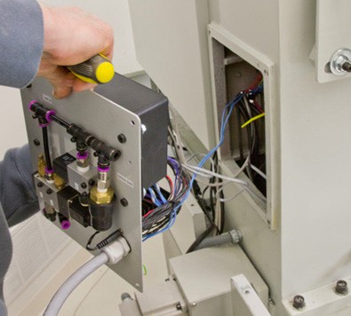

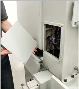

  1. Remove the four column cover plate screws from base of column at the back of the mill. The Z column cover plate will be replaced with the ATC control module. Save the screws.

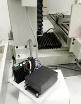

  1. Lay the ATC control module plate with solenoid side down on the chip tray or the Y axis bearing box temporarily.

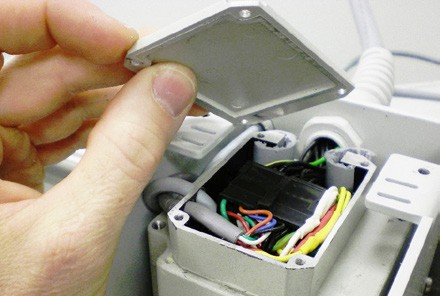

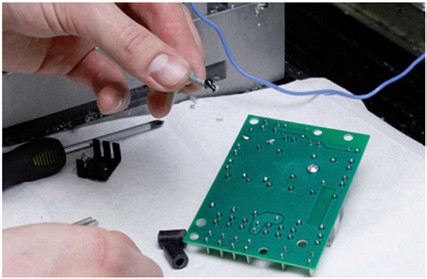

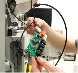

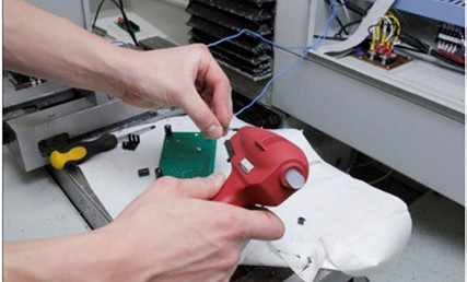

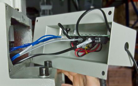

  1. Remove the power drawbar electrical housing (Z axis motor connection box cover plate).
NOTE: If you purchased a power drawbar before June, 2011, you may need to change the power drawbar control circuit board.
Circuit boards labeled Rev 1.2 will need to be replaced. In this case Tormach should have included the updated circuit board with your ATC.
Circuit boards labeled Rev 1.3 and higher do not need to be removed from the housing.
  • To replace an old (Rev 1.2 or earlier) circuit board, disconnect and remove the old circuit board, taking note of the locations of the connectors. While not necessary, you may find it easier to remove the air lines and the cable carrier as well.
  • Replace the old drawbar board with the new one. It is easiest to replace the solenoid leads (red and black wire) before re-mounting the circuit board. The solenoid leads go to the opposite side of board from other connectors. This is the only connector on that side (2 pin nylon).

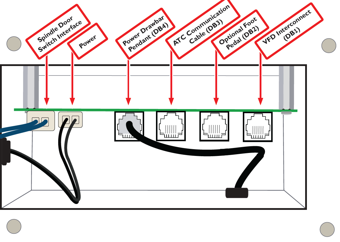

Connect the black VFD interconnect RJ11 cable (with the spade terminal ends) to the DB1 connector on the power drawbar control board, and the ATC communication RJ11 cable to the DB3 connector as shown in the following figure.
  1. Remove the old AC adaptor power supply and replace it with wires 501, 502. These wires will be routed to the new DC Bus Board.
NOTE: If power drawbar and ATC were purchased together, you will not have an AC adaptor power supply.

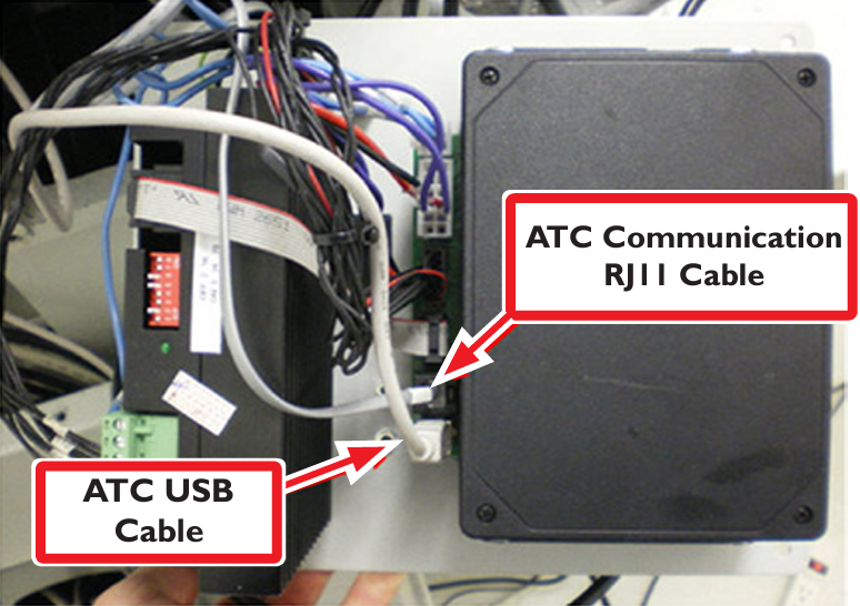

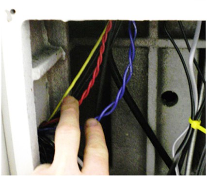

  1. Route all wires (the two RJ11 cables, the blue spindle door switch interface wires, and the power wires 503, 504) through the mill column.
IMPORTANT: Twist blue spindle door switch interface wires to power drawbar circuit board (105, 105A) and red wires (105A, 106) inside column. These wires carry 110V AC and may cause EMF that disturbs USB signal transmission. Twisting wires cancels this EMF.
  1. Re-secure the drawbar electrical housing to the Z axis motor connection box cover plate.

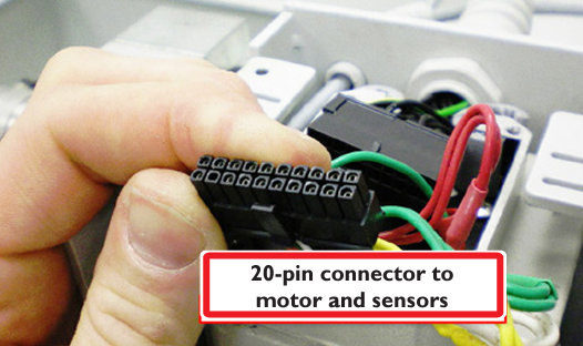

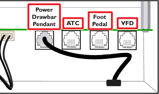

  2. Connect the ATC communication RJ11 cable (from the DB3 connector on the power drawbar circuit board) and the USB cable to the ATC control board.
  1. Drop any slack wires from the ATC control module into the Z column, and secure the ATC control module to the back of the mill using the saved M5 screws and into existing column holes. Be sure that extra wire slack does not contact the Y axis ball screw.

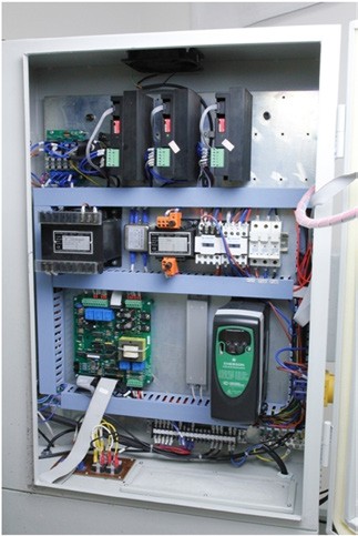

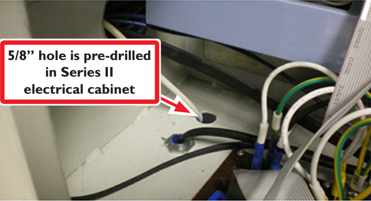

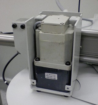

  1. Route the USB cable through the bottom hole of the electric cabinet into any USB port. Do not use the blue USB ports.
image-20241204-155110.png CAUTION! Do not connect the USB cable to the controller until after the software installation is complete.
NOTE: Series 1 machines were not manufactured with this hole. If you have a pre-Series I machine, drill a 5/8” hole in the bottom of your electrical cabinet to route the USB cable to your PathPilot controller.

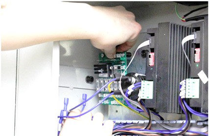

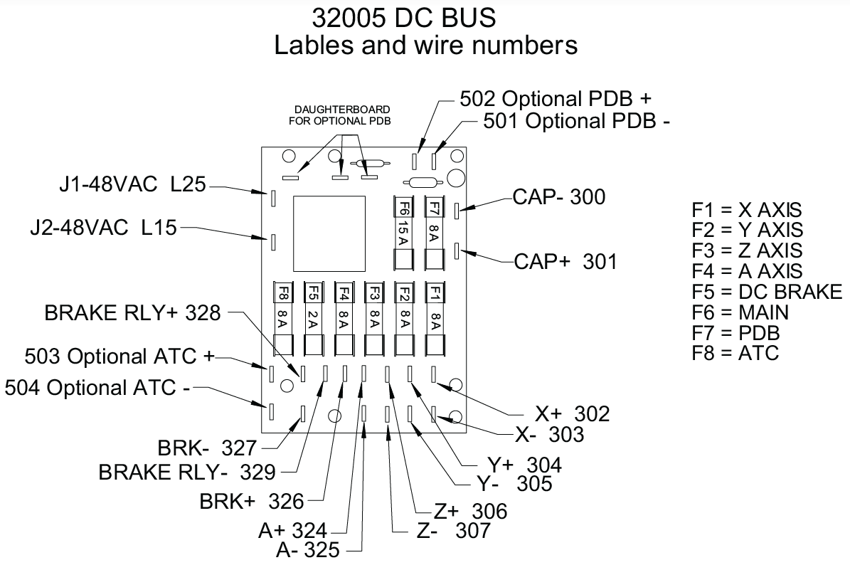

  1. Run the blue ATC control board power leads (503, 504) and the power drawbar circuit board power leads (501, 502) through the wire channels from the hole to the bus board at the top of the cabinet.
  2. Series 3 1100 machines come with the correct DC Bus Board for use with the ATC. Series 3 owners can skip steps 12-13. Do make sure to install the 5x20 mm fuses in the DC Bus Board ATC and PDB fuse holders. This applies to all model machines.
  3. PCNC 1100 machines serial numbers 1999 and lower: Replace the old DC bus board (PN 30661) with the new bus board (PN 32005). Ensure all fuses are present on the DC Bus Board before installation (there should be no empty fuses). When removing the old DC bus board, catch the standoffs and save the screws. Replace with the new board on the same standoffs. It is extremely helpful to tack glue the standoffs in place before mounting the board. An easy way to do this is to put a dab of hot glue on the fasteners before inserting them through the board holes and standoffs.
NOTE: Refer to the DC bus board layout diagram on the following page when transferring wires.
  1. Double-check the polarity of the capacitor, stepper driver, and ATC connections before powering up the machine. Reversing polarity will destroy the stepper drivers and ATC control board.

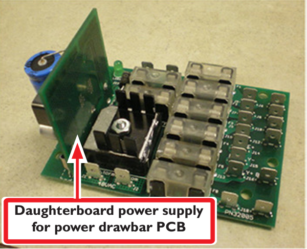

  2. Install the power drawbar daughterboard power supply (PN 31980) by sliding it onto the spade connectors on the new DC bus board (PN 32005). This board supplies the 12V needed by the power drawbar.

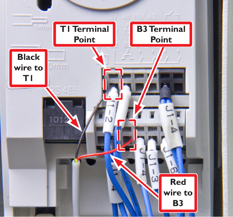

  1. Route the RJ11 VFD interconnect cable along the bottom wire tray to the VFD. Remove the VFD cover by unscrewing the Phillips fastener on the face of the cover plate.
  1. Insert the black and red wires of the RJ-11 cable into positions T1 and B3 on the VFD. To make these connections, insert a small flat head screw driver in the hole just above the wire terminal to open the terminal.
  1. Tidy up the wires and replace the cable tray covers.

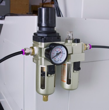

Air Line Connection and Requirements

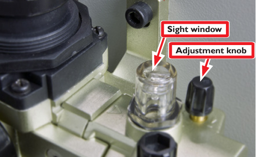

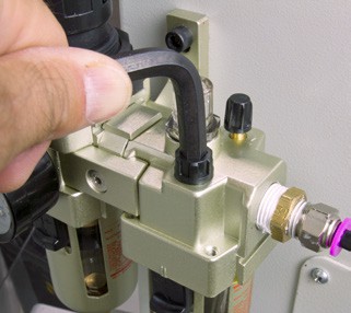

It is recommended to use a filter/dryer/lubricator on the air line used to supply the ATC. Air supply requirements depend on frequency of tool changes. For successful operation, your compressor will need to be able to maintain 95 PSI to the ATC. Typically consumption for frequent tool changes is less than 4 CFM at 95 PSI.
Please note that not all regulators are created equal. Inexpensive regulators tend to constrict air flow, which makes for longer make-up times as the power drawbar fires. While this is not a problem for the power drawbar when operated by hand (the user just waits the extra second or two for the cylinder to fully pressurize), it can cause problems when using the ATC, which only pauses 500 ms between the drawbar firing and the Z axis moving. Better regulators do not restrict the flow while regulating pressure.
Connect Air Lines
  1. Manually pull the tool tray to the retracted position by pulling on the motor enclosure or it will retract suddenly when you pressurize the air lines.

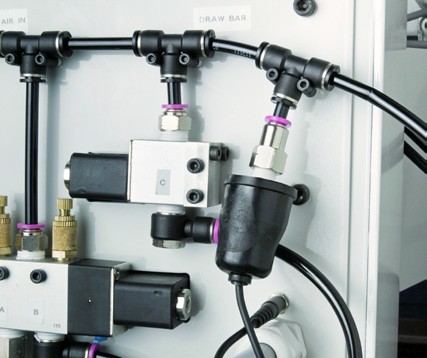

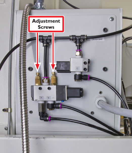

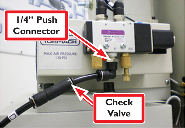

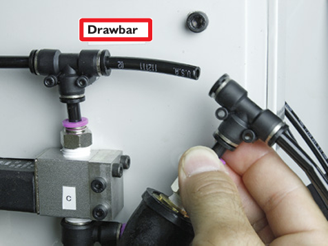

  1. Route the air lines. The lines are labeled at each end – connect them to the solenoids/fittings with the same labels.
  2. Connect the air line from your compressor to the left side input connector labeled “AIR-IN.” You can remove the push fitting and use a quick connect against the first tee if desired, but we’ve found it easier to run tubing to a quick connect fitting in an easier-to-reach location.
  3. Thread the ¼ NPT push fitting into the air input port of the power drawbar. Connect the power drawbar air line labeled “D” (with the attached check valve) between the “DRAWBAR” push fitting on the right side of the ATC solenoid panel and the drawbar input push fitting on the drawbar solenoid. The check valve allows air to pass in one direction only – if you install it backwards the power drawbar will not operate.

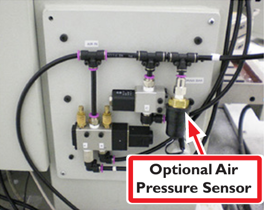

  1. If you have purchased the optional pressure sensor (PN 32329), splice it into air line D and insert the electrical connector into the jack on the column cover plate as shown in this photo:

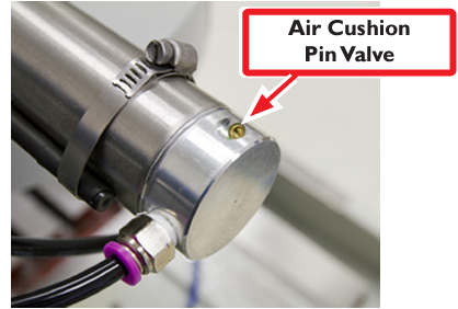

The tray solenoid valve has adjustment screws on the exhaust filters. These can be adjusted to control the tray in and tray out speeds. The screws have been pre-adjusted before shipping. Air cushion pin valves at either end of the air cylinder can be adjusted to control damping at extreme ends of cylinder travel. These are also pre-adjusted. Tool change time should not be adjusted to less than 8 seconds. Conversely, moving too slowly will trigger an ATC time-out error condition.

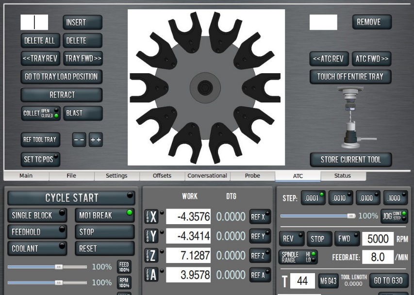

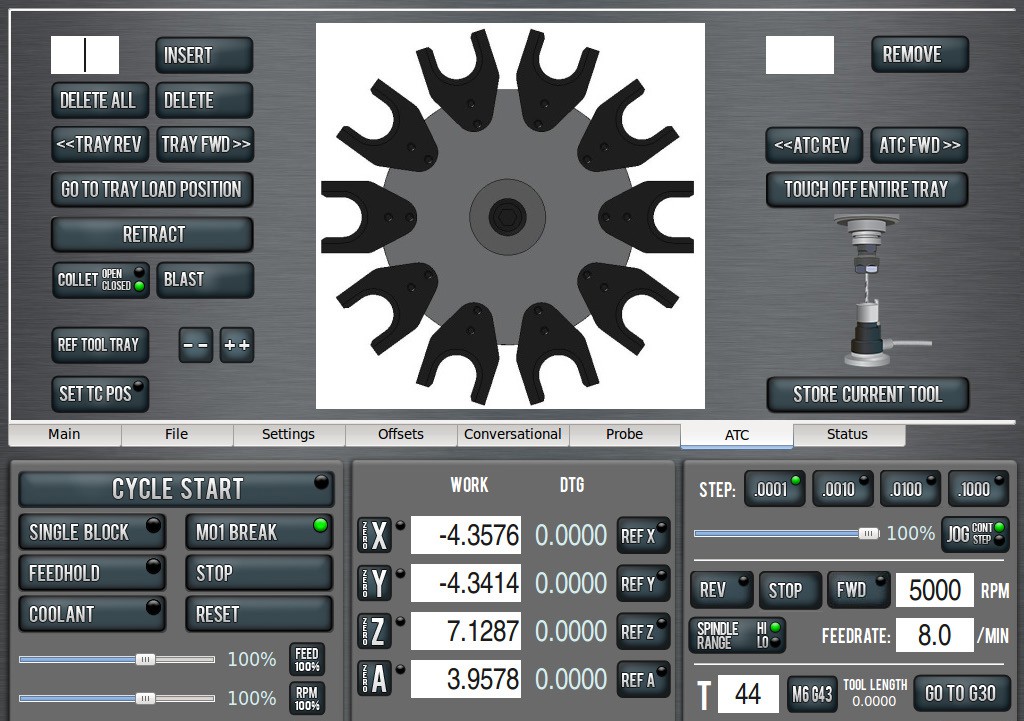

Connect the USB cable from the ATC controller to the PathPilot controller and power on the PathPilot controller. When the system comes up, power on the milling machine, bring it out of reset, and reference the axes. Enable the ATC by checking the ATC check button on the Settings Screen. You will see a new tab labeled “ATC” appear along the row of notebook tabs. If the PathPilot cannot establish communication with the ATC within a few seconds of enabling it, you will see an error message instructing you to check the cables or fuse for the ATC. Otherwise, if no error message is seen, the ATC is working properly. Switch to the ATC tab for the following steps.
NOTE: If there is a tool in the spindle, remove it and set the Tool digital read out (DRO) to zero before continuing with these instructions.
Verify the operation of the tool changer:
  1. Apply a thin film of way oil to the linear rails of the ATC slide assembly. Some chatter is expected until the oil has lubricated the linear bearings.
  1. With the tray out jog the Z axis down a couple of inches.
  2. Make sure when doing this that the spindle cover sheet metal will not hit the ATC linear rail. If there is interference, adjust the X position of the ATC by loosening the fasteners that attach the ATC to the square tube mount.
  3. On the ATC screen, click the “Go to Tray Load Position” button. The Z axis will move up to the reference position and the tray will move in.

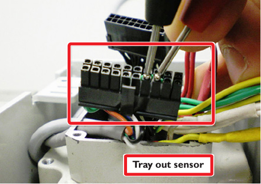

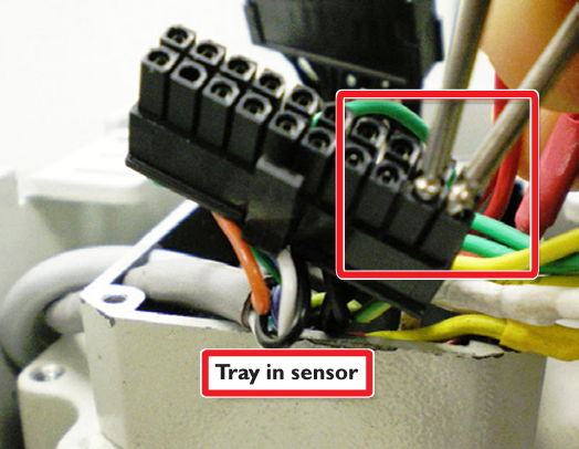

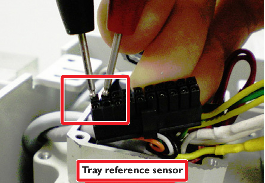

  4. On the status screen, verify that the tray in sensor is working by looking at the tray in LED – it should be illuminated. If it is not, please refer to the Maintenance and Troubleshooting chapter.
  5. Press the Retract button on the ATC screen. The tray should retract.
  6. Click the “Reference Tool Tray” button on the ATC Setup screen – it should find and center on its home switch. It will turn until it finds one end of the sensor, then reverse and find the other end of the sensor, and then center between these two spots.

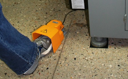

  7. Test the drawbar pendant with the spindle off.
  8. On the ATC screen, click the Collet Open/Closed button. The drawbar should operate accordingly.
  9. Click Collet Open/Closed button on the ATC screen. It should fire and latch. Now hit the top (Lock) button on the pendant. It should unlatch.
  10. Click Blast button on the ATC screen. You should hear the air start and stop at the nozzles in the tool tray.
  11. With a tool in the spindle and the tray in the out position, start the spindle at low speed in manual mode; on the status screen verify that the VFD Running LED is illuminated.
  12. Optional pressure sensor verification: If you have installed the pressure sensor accessory (PN 32329) you may verify that the Pressure Sensor LED on the Status is illuminated under low pressure conditions and dark under normal pressure conditions.

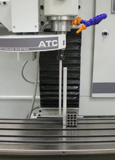

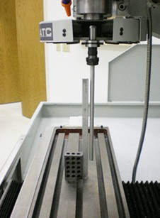

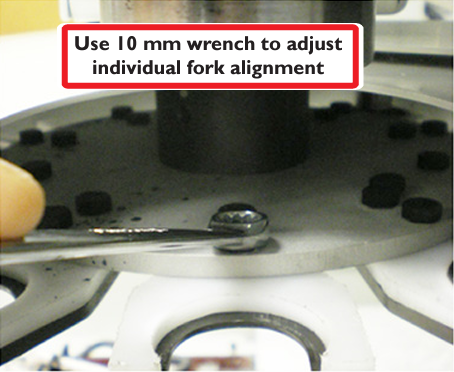

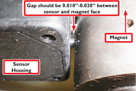

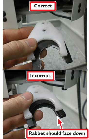

Align Tool Tray and Slots

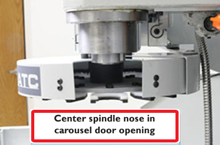

Accurate alignment of the tool tray and slots, and the drawbar throw, are the most important factors in assuring reliable and repeatable tool changer operation. Take your time, and take care to do this accurately. Videos of the alignment procedure can be viewed on our Web site: http://www.tormach.com/upgrades_tts_atc.html
  1. Before you begin the ATC alignment, we recommend replacing your old TTS collet with the new one included with this kit. If this is being installed on a new machine, then consider this collet a spare. Be sure to follow the procedure in the Power Drawbar installation document to properly set the drawbar preload.

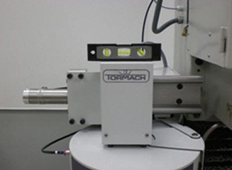

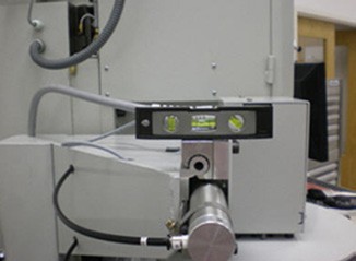

  2. It is helpful to get the ATC assembly approximately level using a bubble level before beginning the alignment procedure.
  1. Make sure the spindle is initially empty. There should be no tool holder in the spindle at this point.
  2. Click the “Go To Tray Load Position” button on the ATC screen. The Z axis will jog up and the tray will actuate in, opening the tool access door, and the drawbar will actuate.
  3. Verify that the spindle is roughly in the center of the carousel door opening. If necessary, move the ATC forward or backward by loosening the four flange nuts that hold the square tube mount to the column.
  1. Insert a long (12-14”) dowel or piece of round stock into a TTS tool holder. Insert the tool holder into the fork of the exposed tray slot. Note: the tool holder should NOT rest on top of the white plastic spring – the groove in the tool holder should slide along the metal portion of the tool fork. Using other vertical lines (edge of mill column, T slots in table) sight along the dowel and check whether the dowel and the spindle axis are parallel in both X and Y planes.
  1. If the dowel and the spindle axis are not parallel, adjust the tilt of the ATC in both X and Y directions until they are.
    1. Tilt in the Y direction is facilitated by loosening the flange nuts that hold the square tube mount to the column, then gently tapping the ATC trapezoid mount with a mallet.
    2. Tilt in the X direction can be adjusted by loosening the socket head cap screws that mount the ATC to the square tube, then turning the eccentric adjustment screws. This is best done with the ATC in the “Tray In” position, as the center of gravity of the unit in the “Tray In” position will allow you to use both adjustment screws to tilt the ATC.
c. Verify that the tool holder shank is parallel to the spindle axis in both X and Y by using an angle block or 1-2-3 block with a straightedge:
  1. Once you are satisfied that the axis of the dowel is parallel to the spindle axis in both X and Y, jog the spindle down to the top of the Tormach tool holder shank. Do not go all the way down to the shoulder yet. Verify by eye that it is roughly centered on the collet center opening.
    1. To adjust the alignment of the tool holder to the collet in the X direction, loosen the jam nut at the end of the tray cylinder rod and move it to a roughly centered position. Press “Tray In” to verify the adjustment. You will likely have to repeat this procedure several times to get the location correct.
b. To adjust the alignment of the tool holder to the collet in the Y direction, use the “--“or “++” buttons on the ATC Setup screen Alignment section. It is best to wiggle the fork with your thumb and index finger to feel the extremes of the carousel backlash against the spindle with your fingers to see that it is roughly centered left and right of fork while making this adjustment.
  1. Remove the tool from the tray, then jog the Z axis back down until the spindle is just above the tool fork. Visually check that the tray is level and on a parallel plane to the underside of the spindle. You should see the same distance between the tool fork and the spindle face around the perimeter of the spindle.
  2. Now, pull your hand away, and click “Reference tool tray.” It will return to the newly centered position. Once the first slot is oriented, all other slots will stop in the same relative position. The ATC will remember this offset indefinitely, until it is reset by the same procedure. This is now the reference location for the ATC.
We’re now ready to verify the alignment. First, verify that the power drawbar is adjusted correctly. The drawbar should be adjusted so that a tool holder will fall out of the spindle when the drawbar is actuated. Drawbar adjustment is discussed in the power drawbar installation manual.
Test ATC Alignment
  1. Click “Go To Tray Load Position” on the ATC screen.
  2. Push the TTS tool holder with dowel into the open slot in the tool tray.
  3. Slowly jog Z down until the TTS shoulder touches the spindle nose. It should slide smoothly on the TTS shank. If it doesn’t, the tray is misaligned (not centered or perpendicular to the spindle), or the collet hasn’t opened far enough to spring out for smooth entry.
NOTE: If tray is not properly aligned there will be noticeable movement at the end of the dowel as the spindle slides down over tool shank. This must be corrected by adjusting either the tilt or the XY location of forks to ensure trouble-free operation.
  1. Once you get aligned for a smooth descent, jog Z to the shoulder. When the spindle is resting on the tool shoulder, click the “Set TC POS” button on the ATC screen.
  2. You’ve now set the tool change location of the Z axis for all tool changes. This position is remembered as a machine coordinate, is saved at shutdown, and is
  3. independent of all work or tool offsets established during machining. As long as Z is referenced, the tool change will occur at the same place.
  4. After setting the tool change location, jog the Z axis back up off of the tool shank and remove the tool from the fork.
Now check the individual fork alignment. During shipping or assembly, the forks in the tool tray can shift a bit off center. The tool holding forks need to all line up the same way under the spindle. Jog the spindle up slightly, then on the ATC Control screen click the Tray FWD button to index the carousel to the next tool fork. Jog Z down to so the spindle is touching the top of the fork spring. Push the spring left or right until it is roughly centered using the thumb and index finger technique employed in step 7 in the previous section (Align tool Tray and Slots). If the alignment is off, you might have to jog up and loosen the nylon bolts a tad first. Jog up and tighten the nylon bolts at center until snug but not overly tight. Repeat to align all the slots.
You should only have to do this once. At this point all the forks will align identically to the spindle and work as SLOT 1 did. You may verify this by hitting the “Go To Tray Load Position” button and advancing through each of the tool positions. With the drawbar actuated, insert a tool holder in the slot, jog down towards Tool Change Z. When finished, click “Go To Tray Load Position” to move the spindle away from the tool, then manually remove the tool from the fork. Your system, once aligned and verified, is ready for use.
Foot Pedal Kit
The Foot Pedal Kit (PN 31728) provides easy foot-activation of the power drawbar for hands-free operation. To install:
  1. Remove the power drawbar electrical housing.
  1. Plug the foot pedal cable into the Foot Pedal connector port on the power drawbar control board (as shown in the figure below).
  1. Place the foot pedal in a position that allows for easy access during mill operation.

The Filter Regulator Lubricator (PN 32457) is recommended for proper conditioning of supply air for both the power drawbar and the ATC.
To install:
  1. Drill two holes into the back of the splash guard (or wherever is convenient for mills without a splash guard).
  2. Secure the FRL to the mounting bracket with your own equipment.
  3. Wrap the fittings on the two NPT reducers with Teflon tape and secure the fittings into the FRL valve housings.
  4. Splice the air supply line and insert a quick connect bushing (PN 32212) to each end of the open line.
  5. Connect the bushings to the NPT reducers.
  1. Open the FRL fill port with a hex key.
  2. Fill the port with standard air tool oil (using a small funnel if necessary).
NOTE: Before first use, air must be flushed from the FRL system.
NOTE: Proper function may be confirmed visually through the sight glass on the top of the FRL.
A droplet of lubricant will form on the bottom of the stem located inside of the sight window.
  1. Open the lube adjustment knob 1/2 turn (towards the +).
  2. Flush all air bubbles from the system.
  3. When air bubbles no longer appear in the sight window and a droplet of lubricant forms on the bottom of the stem, close the lube adjustment knob 1/4 turn (so that it is open approximately 1/4 turn from the closed position).
Pressure Sensor
Pressure Sensor (PN 32329) prevents the carousel from actuating during low air supply pressure condition.
  1. Splice air line D and insert the Pressure Sensor as shown.
  1. Plug the male end of the electrical connector into the jack on the column cover plate.

The Tormach Tooling System ATC will hold up to ten tools in a single tray. The ATC allows mixing manual and automatic tool changes within the same part program. If your program requires 11 or more tools, the ATC will change tools automatically for all tools in its tray, and pause for a manual change for tools that are not assigned to the tray. Any tool number between 1 and 256 may be assigned to a position in the tool tray – you are not confined to using tool numbers 1-10. This is convenient if you have a tool library already set up with tool numbers and heights measured in your tool offset table. There is no need to remember which slot a particular tool has been assigned to – simply call the tool number in G-code with an M6 command and the ATC will retrieve the appropriate tool.
Loading/Unloading Tools
There are two ways to load and unload the tool tray in preparation for machining using the ATC. In automatic tool loading via the Store Current Tool button, the ATC will load the tool that is currently in the spindle and store it in the nearest open tray slot. In manual tool loading, the tray will slide in and the tray door will open, allowing the operator to manually place tools into the tray. The following sections detail these two modes of operation.
Automatic Tray Load/Unload
The right hand side of the ATC control screen contains the buttons and a DRO used to store and retrieve tools. To load a tool into the tray:
  1. Load the desired tool into the spindle.
  2. Enter the tool number in the tool DRO (bottom right portion of screen next to the M6 G43 button). Do not forget to press “Enter” after typing in this number.
  3. Click the “Store Current Tool” button. The ATC will assign the tool to the nearest open slot and store the tool in that slot in the tray. The tool number will now be displayed on the tray image in the center of the screen. The spindle is now ready for the next tool to be stored.
To retrieve a tool from the tray there are two options. You can type Txx M6 at the MDI line (where xx is the desired tool number) or enter the tool number in the tool DRO and press the Enter key. This will retrieve that tool from the tray and leave it in the spindle. It also leaves it assigned to the tray.
To remove a tool from the tray, type in the tool number in the DRO next to the “Remove” button (remember to press enter after typing in the tool number), then click “Remove.” After the ATC fetches the tool you will be prompted to remove the tool from the spindle.
To remove a tool from the spindle, and delete its assignment from the tray, click “Remove.” You will be prompted to remove the spindle tool.
NOTE: Simply typing a new tool number into the tool DRO does not remove the tray assignment. You must use the “Remove” button to delete the tool’s tray assignment.
“ATC FWD” and “ATC REV” will return the spindle tool to the tray, then fetch the next/previous tool in the tray.
Manual Tray Load/Unload
If you want to load or unload multiple tools you may find it faster to open the tool changer door and load or unload them manually. The Manual Load/Unload buttons and DRO on the right hand side of the ATC screen will allow you to bring the tray to a loading position (door open), manually insert or delete, and assign or un-assign tool numbers to tray positions.
To load tools manually:
  1. Click “Go To Tray Load Position” to move the spindle head up and bring the ATC in to the door open position.
  2. Insert a tool into an open fork.
  3. Type the tool number into the DRO next to the “Insert” button. Remember to press “Enter” after typing in the number.
  4. Click “Insert” to assign the tool to the exposed tray slot.
  5. Click “Tray FWD” or “Tray REV” to advance to the next location if you want to load another tool.
To unload tools manually:
  2. If the exposed tool is the one you want to remove, simply click “Delete” to un-assign the tool from the tray.
  3. If the tool you want to remove is not the exposed tool, type the tool number into the DRO next to the “Insert” button. Remember to press enter after typing in the number.
  4. Click “Delete” to un-assign the tool. The tray will move to the tool to be removed.
  5. Click “Tray FWD” or “Tray REV” to advance to the next location if you want to unload the next or previous tool.
  6. When you are finished loading or unloading tools, call any tool (using the tool DRO or with an M6 command at the MDI line) or click “Retract” to return the tray to machining position.
NOTE: If you click “Delete” or “Insert” and the ATC is not in tray load position, it will move to tray load position automatically.

The procedure for adjusting the preload on the spring washers is outlined in the power drawbar installation guide. Because the spring washer preload also affects the operation of the ATC, certain parts of this procedure are worth repeating here:
  1. When adjusting the preload, make sure the regulator on your air line set to at or below the cut in pressure on your air compressor. For instance, if your regulator switches on at 90 PSI, and your regulator is set to 95 PSI, the actual air pressure at the drawbar could be anywhere between 90 and 95 PSI, depending on the tank pressure. This is bad: if you set spring washer preload when you have 95 PSI to work with, the drawbar will not properly release when PSI decreases to 90, increasing crash risk.
  2. The higher the working air pressure, the more preload you can get on the spring washers. If compressor can be adjusted to maintain 100 PSI, you can run with higher preload than you would at 90 PSI. Minimum recommended air pressure is 95 PSI, but if collet slips, increase supply pressure to get preload up. Do not exceed 120 PSI, the working limit for the power drawbar cylinder.
  3. Not all air regulators are created equal. We have found that inexpensive regulators tend to constrict air flow, which makes for longer make-up times as the power drawbar fires. While this is not a problem for the power drawbar when operated by hand (the user just waits the extra second or two for the cylinder to fully pressurize), it can cause problems when using the ATC, which only pauses 500 ms between the drawbar firing and the Z axis moving. Better regulators do not restrict the flow while regulating pressure.
  4. Collet slip is more likely to occur if your speeds, feeds, or fixturing result in machining operations with a lot of high frequency chatter (end mill “squeal”). We have seen even light cuts result in collet slip if the end mill is squealing or chattering excessively. Usually, such noise and vibration should be avoided for other reasons (poor surface finish, reduced tool life) and tweaking the spindle RPM or increasing the feed rate will tune the chatter out.

The TRAY IN/OUT sensors are normally open reed switches. TRAY OUT is visible under the band clamp at the end the pneumatic actuator. TRAY IN is hidden in a recess in the linear rail behind the pneumatic cylinder and is not visible unless the cylinder has been removed. The piston of this pneumatic actuator is magnetic – the reed switches are actuated when the piston inside the cylinder comes within 0.100” of the sensor.
When PathPilot is started the ATC goes through initialization, the TRAY IN and TRAY OUT sensors are evaluated. If the ATC software encounters a condition where both sensors return HI or both return LO, an error message is generated. Other checks in the software user the tray sensors to try to prevent crashes – for instance if the TRAY IN sensor is active the ATC will stop you from jogging past the tool change position (a soft limit is triggered).
Diagnostic LEDs are visible on the Status screen. These can be used to verify the sensors. If a sensor is not working as expected, the following possible causes should be investigated:
Defective Sensor
Any magnet can be used to verify whether or not the sensor is working. If you bring a strong magnet near the TRAY IN or TRAY OUT sensors they should return TRUE. If the sensor is working, you can skip to the “Sensor is out of adjustment” section.
If the sensor is not working, you will need to determine whether the sensor itself is defective or if there is a short in the wiring.
NOTE: The TRAY OUT sensor is held in place by a band clamp – if this clamp is over tightened it will prevent the sensor from working. You might try loosening the band clamp as a first step in diagnosing a bad TRAY OUT sensor.
To distinguish between a wiring problem and a sensor problem, you will need to Ohm out the sensor with a multimeter:
  1. Remove the motor cover, then remove the top of the stepper motor’s electrical junction box:
  1. Disconnect the 20 pin Molex connector. The female side goes to the motor and sensors:
  1. Touch your probe leads to the pins corresponding to the sensor of interest:
  1. When a magnet is near the sensor, the sensor should read close to 0 Ohms, otherwise it should read open circuit.
If the sensor reads appropriately at the 20 pin connector, then the overwhelming likelihood is that the 20 pin junction (male side – to the control board) has a faulty crimp. To be sure you can repeat the above multimeter tests at the control board (see schematic for appropriate pins).
If the sensor does not read appropriately you should remove the sensor assembly (which requires removal of the pneumatic actuator). As a final check you can ohm out the sensors when they are off of the machine. The sensor assembly is PN 32138.

Tray Reference
The TRAY REFERENCE sensor is a normally open reed switch housed in a black plastic enclosure on the underside of the carousel umbrella. It is used to provide a carousel home reference position. It reads a small neodymium magnet embedded in the hub.
The first tool change after the control software is started, or any time after the mill is e-stopped and then re-powered, the tray will reference itself. It spins quickly in one direction until is the sensor reads the magnet, moves past the magnet, then it reverses direction and moves slowly until it reads the magnet again. If the sensor is not working properly the tray will spin for 10 seconds or so, then time out and give an error message.
The sensor should be positioned as shown in the above photo – a small gap should be present between the magnet embedded in the hub and the sensor itself.
This sensor can be Ohmed out in the same way as the TRAY IN and TRAY OUT sensors:

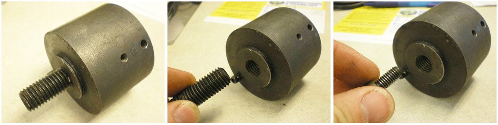

Hub Disassembly
  1. Remove the tool tray by removing the flange nut that attaches the tray to the hub.
  2. Use an Allen wrench to unscrew the stud that the flange nut was screwed on to.
  3. Behind the stud is a small (M4) socket head cap screw; remove this.
  4. Loosen the two set screws and remove the hub from the shaft.
