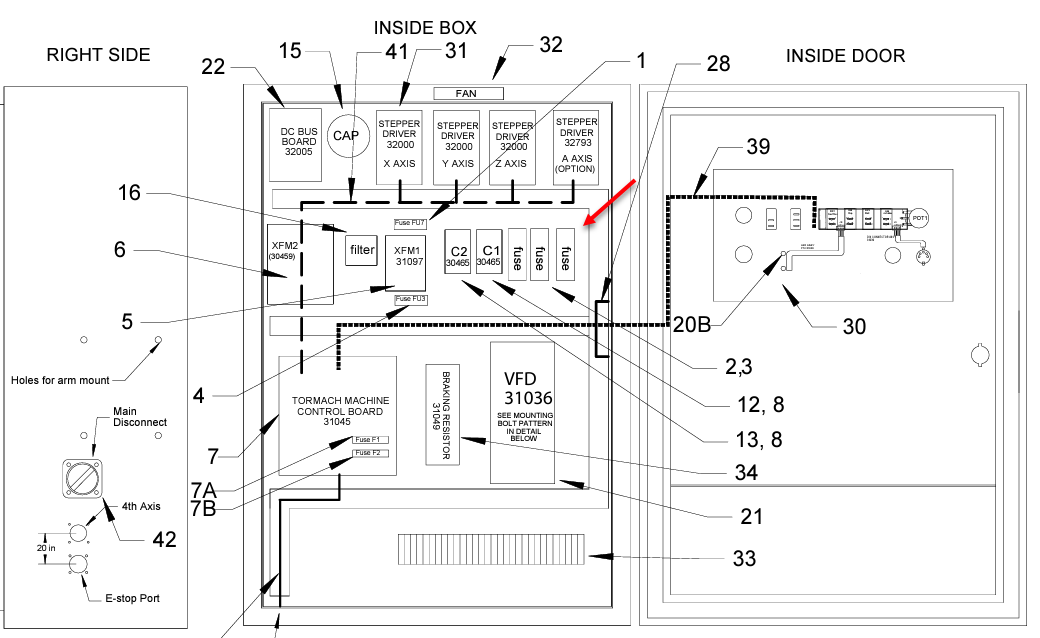

    2. Replace the FU6 fuse.
PCNC 1100 FU6 Location
