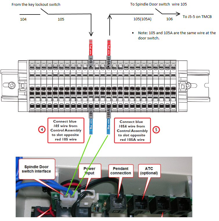

The Variable Frequency Drive (VFD) isn’t Getting Power
Examine the spindle door and its switch
Reason: The door is open or the switch is malfunctioning.
  1. Examine the spindle cover door to verify that it’s closed, being held closed, and the switch is being depressed.
  2. If your mill is equipped with door safety switches, make sure your enclosure doors are closed.

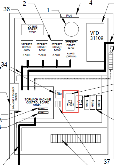

Manually Latch the C2
Reason: C2 is not latching or staying latched
  1. Locate the C2 Contactor and remove the cover by sliding it up. You should be able to identify either a dark blue or orange “button” in the center. Press the “button” and note the result.
PCNC1100
PCNC770
  1. If the C2 doesn’t stay latched, this indicates that either is an open circuit up stream of the C2 (spindle door, PDB (if applicable), spindle lock key) or the C2 is faulty.
    1. Inspect that the spindle door and spindle lock key are not in an open position.
    2. At the C2, measure between wire 106 and 100 for 120 VAC. Then, progress to the 107 to 100. If you read 0 Vac start to work your way back starting with the primary side of the door switch (105a to 100); then the primary side of the power drawbar (105 and 100); and finally the primary side of the spindle lock out (104 to 100). Doing this method you should discover the culprit.
c. Test the C2 by jumping wire 106 to wire 107 at the Machine Control Board. As long as you confirmed there was 120 VAC at wire 106, you now should see the coil immediately energize and latch. If not, the wires are disconnect or the C2 is faulty.
NOTE: Jumper wires should only be used for testing purposes.
  1. If the C2 Latches, this indicates that the signal to start the spindle isn’t making it to the C2. Using either an analog multimeter or general purpose you tester you can test wire 107 to 100 while commanding a spindle start. This can be very difficult to capture, but you should see a blip on your tests. If there is not a blip you should inspect the communication line to ensure the signal is making its way to the Machine Control Board.
