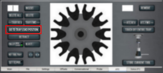

  3. Center the machine table: from the PathPilot interface, in the MDI Line DRO field, type G20 G53 G1 X7 Y-3.75 Z0 F20. Then select the Enter key.

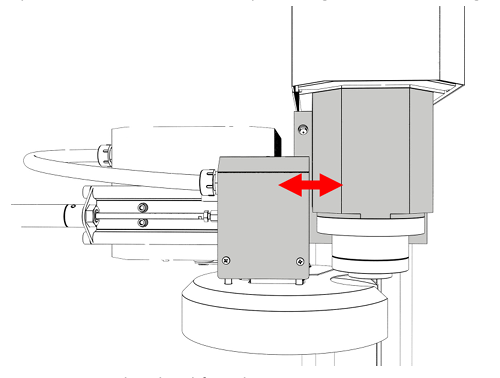

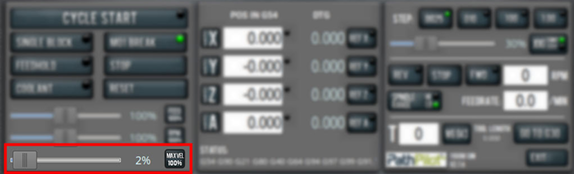

  2. Verify that the ATC is all the way forward (toward the spindle), and then slowly move the Z-axis down (-Z) to examine the clearance of the carousel door opening.
  3. Verify that the carousel door opening is approximately equal to the front back and left of the spindle mounting flange:
Figure 14: Distance between the carousel door opening and the spindle mounting flange.

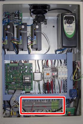

  2. Open the electrical cabinet door.

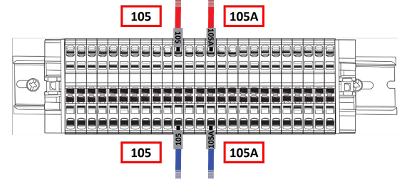

  3. Locate blue wires 105 and 105A on the terminal block in the electrical cabinet.
Figure 17: Current wire configuration on the terminal block.
  1. Remove blue wires 105 and 105A.
  2. Locate red wire 105A on the terminal block. Then, remove it.
NOTE: During the original procedure to install the Power Drawbar, wire 105 was given a new label, making it wire 105A.
  1. Connect red wire 105A to the slot opposite red wire 105 on the terminal block.
Figure 18: New wire configuration on the terminal block.

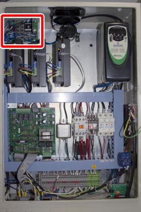

  2. In the Power Drawbar control assembly box, locate the power wire connector on the Power Drawbar board. Then, unplug it.
  3. Pull the loose power wire from the Power Drawbar control assembly box and out of the machine. Then, discard it.
  4. In the Power Drawbar control assembly box, locate the VFD interconnect cable (from DB1) on the Power Drawbar board. Then, unplug it.
  5. The existing power drawbar button and power drawbar control board aren't used with the M style ATC. If desired, you can remove them.

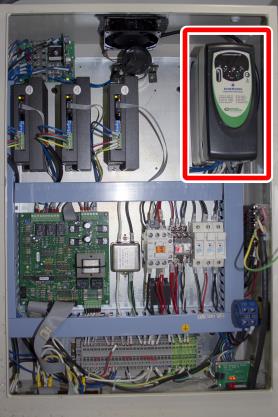

  1. Remove the wire trough covers in the electrical cabinet.
  2. Identify wires T1 and B5 on the ATC Legacy Adapter Cable. Then, route them through the wire troughs toward the variable frequency drive (VFD).
Figure 21: VFD in the electrical cabinet.

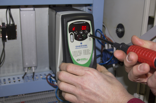

  1. Use a Phillips screwdriver to remove the cross-head screw on the VFD, and then remove the VFD faceplate.
Figure 22: Removing the faceplate from the VFD.

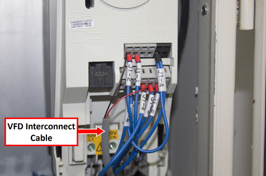

  1. If you previously installed the Power Drawbar board, you must remove the VFD interconnect cable. Identify it on the VFD and remove it. Then, pull the loose cable out of the machine, and discard it.
Figure 23: VFD interconnect cable connected to the VFD.

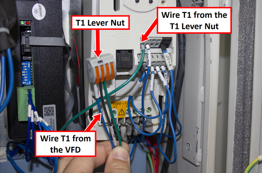

  1. Identify slots T1 and B5 on the VFD. You'll make connections in both slots to connect the ATC Legacy Adapter Cable.
Figure 24: Slot identification on the VFD.
  1. Remove wire T1 from the VFD, and then insert it in to the open slot in the T1 lever nut on the ATC Legacy Adapter Cable.
NOTE: If you have an (optional) load meter, your VFD has an extra wire in slot T1. Remove it from the VFD, and then insert it into the remaining open slot in the T1 lever nut on the ATC Legacy Adapter Cable.
  1. Completely push the lever down on the T1 lever nut to latch the wire. Verify that the lever is latched.
  2. Connect the loose wire from the T1 lever nut in to slot T1 on the VFD.
Figure 25: T1 lever nut connected to slot T1 on the VFD.

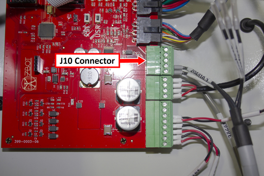

  1. Unlock and open the lid on the ATC main assembly with a large, flat-blade screwdriver.
  2. Identify the J10 connector on the ATC board, and then unplug it from the board.
Figure 28: J10 connector on the ATC board.

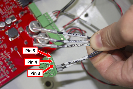

  1. Identify the loose ends of wires 403, 408, and GND.
Figure 29: Loose wires on the J10 connector from the ATC board.
  1. Remove the plastic wire protectors from the ferrule ends.
  2. Use a small, flat-blade screwdriver to connect the following wires to the J10 connector:
    1. Wire 408 to pin 3
    2. Wire 403 to pin 4
    3. Wire GND to pin 5 (depending on the age of your ATC, the GND wire may already be grounded to the ATC box. If so, there is no need to connect it to the ATC board.)
  3. Plug the J10 connector back in the ATC board.
  4. Close the lid on the ATC main assembly and lock it.

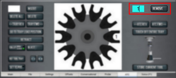

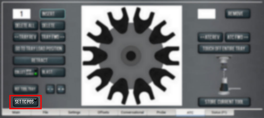

Verify the Installation

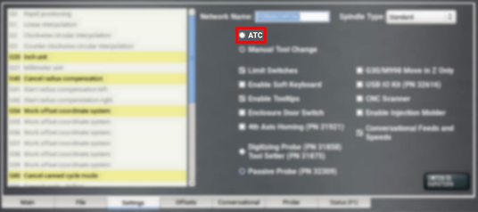

    3. Press the Reset button.
  1. If you have not yet done so, you must make sure that the PathPilot controller is updated to the latest version of PathPilot: From the Status tab, select Update. Then, follow the on-screen instructions.
  2. From the PathPilot interface, on the Settings tab, select the ATC radio button.
Figure 30: ATC radio button on the Settings tab.

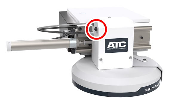

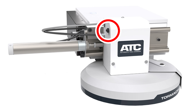

    1. Push and hold the open button on the side of the ATC.
Figure 31: Collet open button on the side of the ATC.
The collet opens.
c. Release the button.
The collet closes.

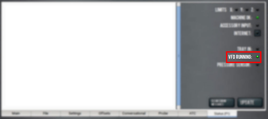

  2. Select FWD.
The spindle starts.
  1. From the Status tab, make sure that the VFD Running green light comes on.
Figure 32: VFD Running light on the Status tab.
NOTE: If the VFD Running light did not come on in the previous step, we can help. Create a support ticket with Tormach Technical Support at tormach.com/how-to-submit-a-support-ticket for guidance on how to proceed.

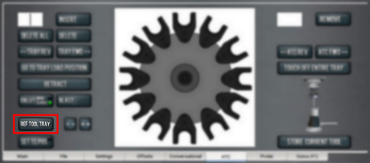

  2. From the PathPilot interface, on the ATC tab, select Ref Tool Tray.
Figure 37: Ref Tool Tray button on the ATC tab.
The tool tray spins.
NOTE: You're only required to reference the tool tray once, unlike the mill axes’ referencing procedure.
  1. Select Go to Tray Load Position.
Figure 38: Go to Tray Load Position button on the ATC tab.
  1. When prompted, select OK.
    The tool tray moves forward.

  5. If the tool's shank isn't aligned, do the following:
    a. Adjust the Alignment of the Tool in the Y Direction (toward or away from the Z column) Determine if the tray must move clockwise or counterclockwise. From the PathPilot interface, in the ATC tab, either select -- to step the tool tray counterclockwise or ++ to step the tool tray clockwise.
Figure 39: Moving the tool tray clockwise or counterclockwise.
b. Adjust the Alignment of the Tool in the X Direction (left or right) Determine if the tray must move left or right. Use two wrenches to loosen the jam nut on the end of the cylinder rod, making sure that you don't spin the rod end when adjusting the jam nut. Then, either turn the rod end one-half turn further on to the cylinder rod to move the tool tray to the left, or turn it one-half turn off of the cylinder rod to move the tool tray to the right. Once finished, tighten the jam nut.
Figure 40: Moving the tool tray left or right.
Repeat adjustments until the tool's shank is concentric with the collet in the spindle.

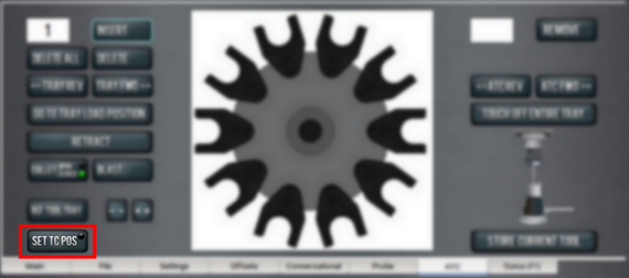

Set the Tool Change Height
Figure 41: Set TC POS button on the ATC tab.

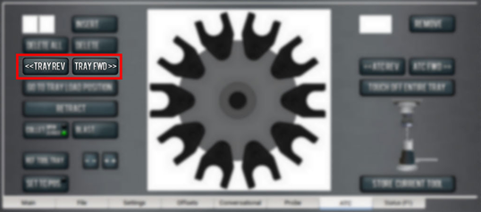

Adjust for Rotational Play
There's a small amount of rotational play built into the Automatic Tool Changer (ATC) carousel. This play allows for some misalignment during tool changes, and you must adjust for it in both directions. The taper on the tool shank also helps align the tool during a tool change.
To adjust for rotational play:
  1. From the PathPilot interface, on the ATC tab, select Tray Fwd to rotate the tray clockwise (forward) one full tool slot.
Figure 42: Tray FWD and Tray REV buttons on the ATC tab.
  1. Select Tray Rev to rotate the tray counterclockwise (backward) one full tool slot.
  2. Verify that the tool’s shank is aligned with the collet in the spindle.
  3. Depending on the alignment, do one of the following:
  • Aligned You have completed aligning the ATC. Remove the tool from the fork. Go to Step 5.
  • Not Aligned You must readjust the tool tray rotation. Go to "Adjust the Tool Tray Load Position".
  1. From the PathPilot interface, on the Main tab, drag the Maxvel Override slider to the left. This reduces the maximum velocity by the percentage shown.
Figure 43: Maxvel Override slider on the Main tab.
  1. Do a test tool change. Because the maximum velocity is reduced, it's easier to verify the alignment of the ATC and stop the machine if further adjustment is required.
Tip! Use the Spacebar key to pause the tool change, if needed.

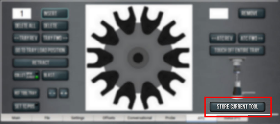

  3. Select Store Current Tool.
  1. Click Retract.
Figure 5: Collet open button on the side of the ATC.
The collet opens.
  2. Release the button.
    The collet closes.
NOTE: If installed, the Power Drawbar button's functionality is replaced by the button on the ATC.

  1. Load a tool into an open fork on the tray.
  2. From the ATC tab, type the tool number into the Insert DRO field. Then select the Enter key.
  3. Select Insert.
    The tool is assigned to the exposed tray slot.

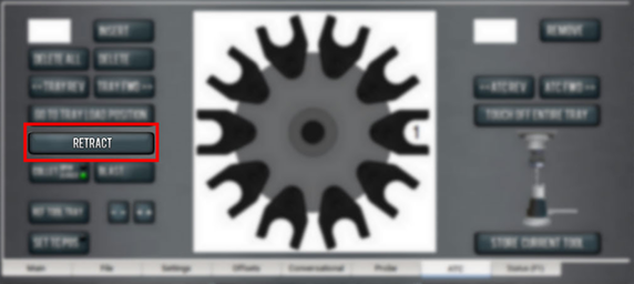

  4. Select Tray FWD or Tray REV.
  5. Select Retract.

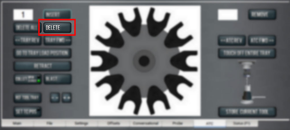

  3. Select Delete.
Figure 7: Delete button on the ATC tab.
  1. Select Retract.
Figure 8: Set TC POS button on the ATC tab.
Switch to Manual Tool Changes
From the PathPilot interface, on the Settings tab, select the Manual Tool Change radio button.
