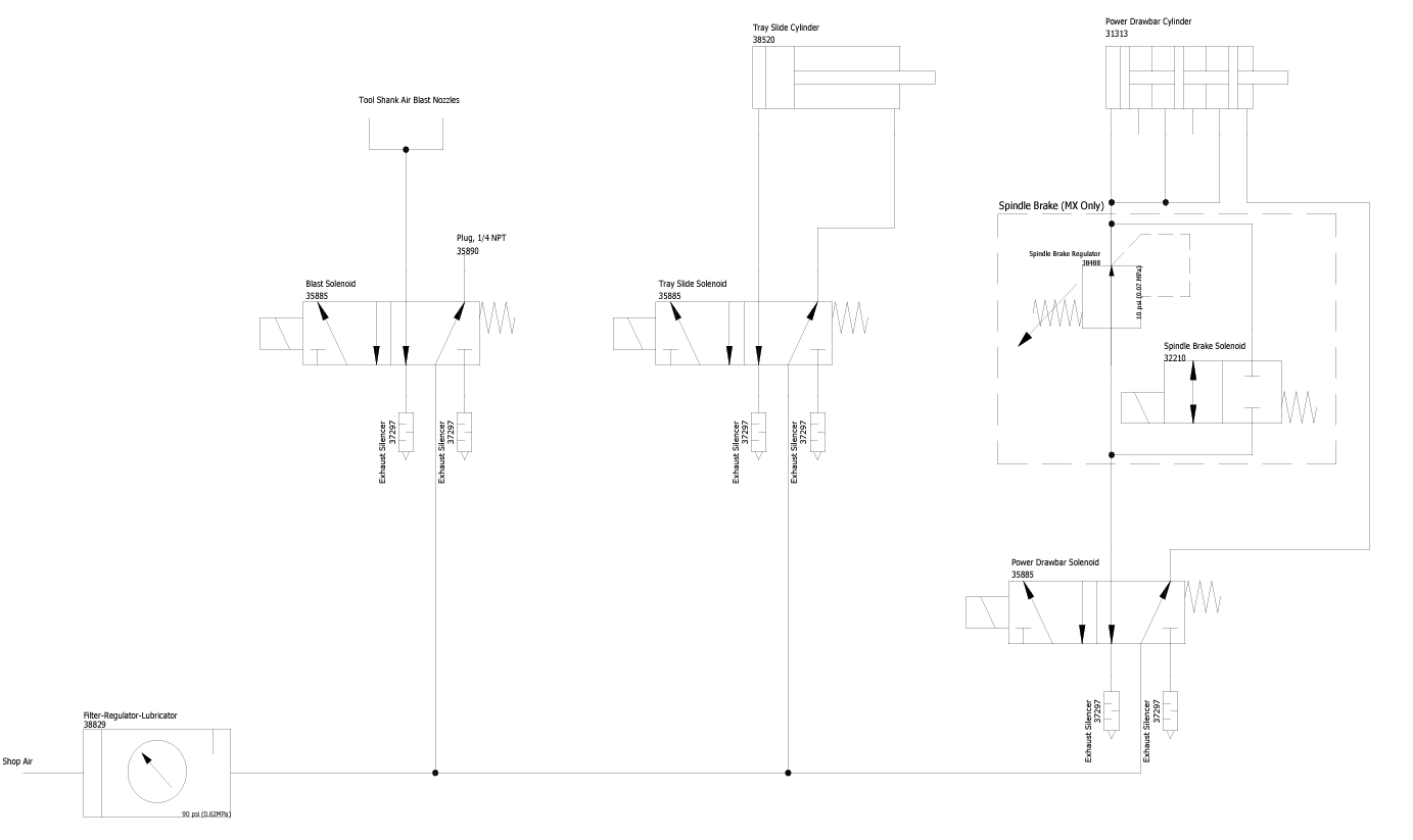

Air Requirements
  • Air Pressure Between 90 psi and 120 psi (620 kPa to 825 kPa).
  • Air Volume For successive back-to-back tool changes, at least 2 cfm at 90 psi is required.
    Use the pre-installed FRL Filter-Regulator-Lubricator for this purpose.

Make Air Connections
  2. Route the loose ends of the two 1/4 in. plastic tubes connected to the ATC main assembly through the enclosure knockout, up the energy chain, and toward the Power Drawbar. Then, pull the air line from the FRL back through the energy chain.
  3. Trim and connect the loose ends of the 1/4 in. plastic tubes in the following order:
Figure 13: Air in port in the ATC main assembly.
d. If you haven't already done so, connect your shop's air supply to the FRL.

Schematic
To view a PDF version of your manual, go to Tormach document TD10626.
