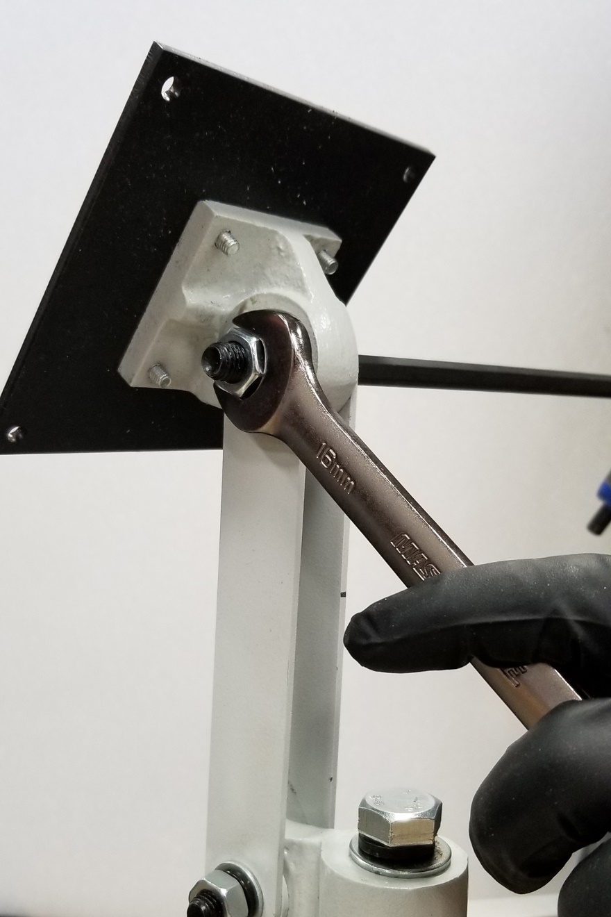

  3. Find the mounting pad on the machine stand.
Controller Arm Figure 1: mounting pad.
  1. Secure the square tube arm to the machine stand with two M8 socket head cap screws, two M8 flat washers, two M8 lock washers, and a 6 mm hex wrench. Verify that the white nylon washer is located toward the bottom of the mounting pad.
Figure 2: White nylon washer on the square tube arm.
Figure 3: Incorrect and correct orientations of the monitor bracket on the Controller Arm.
Figure 4: Tightening the monitor bracket in place.
