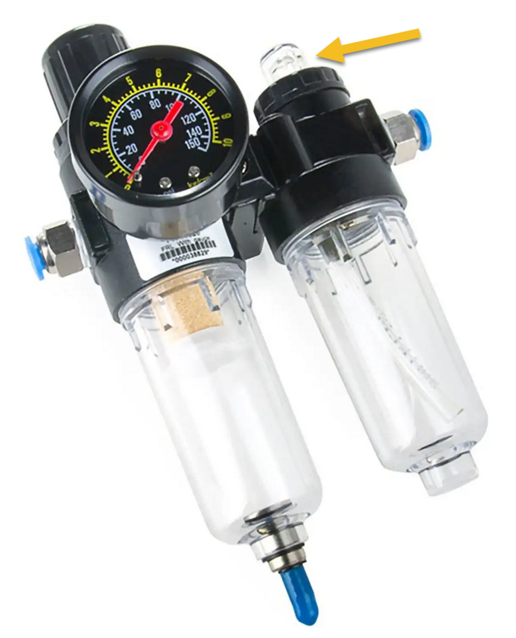

  1. Turn the lubricator adjustment knob all the way down (counter-clockwise).
Lubricator Adjustment Knob

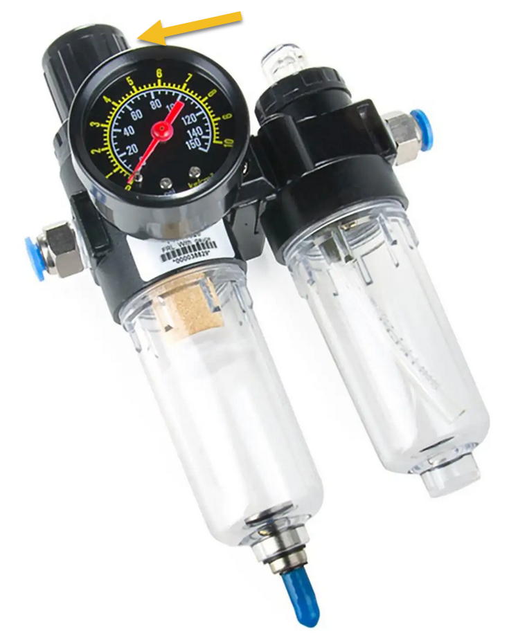

  1. Turn the air pressure regulator all the way down and disconnect the outlet air line from the push-to-connect fitting.
Air Pressure Regulator Knob
  1. Start to turn the air pressure regulator, which allows air to free flow out the outlet side, while watching the lubricator site window.
    NOTE: To prevent air tool oil from spraying, we recommend holding a paper towel or shop rag to the outlet side.
  2. When you see oil exiting the outlet side, and when a drop forms and falls rapidly in the side window, start to turn the lubricator adjustment knob clockwise. Stop turning the knob when you see one drip every five seconds.
NOTE: Because the machine uses a small amount of air for every air blast, it's better to set it up on the higher side of the drip rate.
