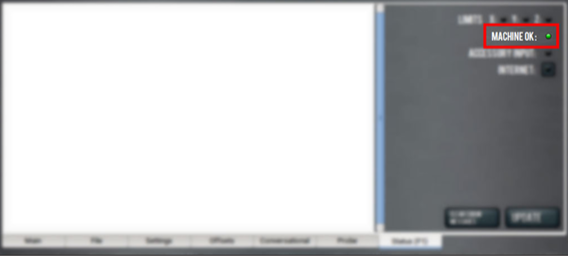

  1. Verify that the blue Reset LED on the operator box comes on. From the PathPilot interface, on the Status tab, verify that the Machine OK light changes from yellow to green.
    Once both are on, the machine is powered on and ready to operate.
Figure 5: Machine OK light on the Status tab.

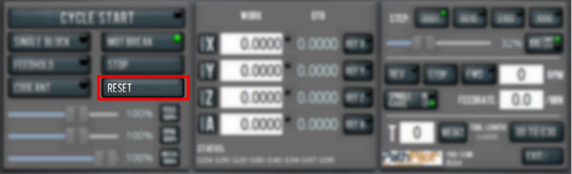

  1. Select Reset.
Figure 6: Reset Button

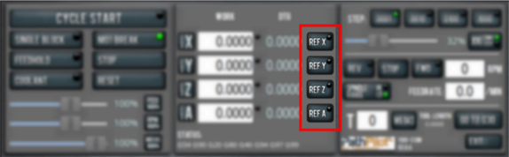

  4. Reference the axes: from the PathPilot interface, select Ref Z, Ref X and Ref Y.
Figure 7: Ref Z, Ref X, and Ref Y Buttons.
The machine moves to the reference position.

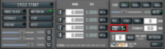

  1. Open the spindle door and locate the spindle belt.
  2. From the PathPilot interface, confirm that the Spindle Range button matches the spindle belt position.
Figure 10: Spindle Range button.
If necessary, select Spindle Range to match the spindle's belt position.

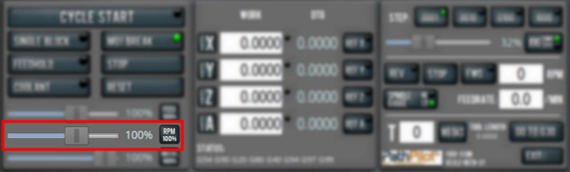

  2. From the PathPilot interface, confirm that the Spindle Override slider isn't set to 0% (when it's set to 0%, the slider is yellow). To clear the override, select RPM 100%.
Figure 11: Spindle Override slider.
NOTE: The Spindle Override slider changes the programmed spindle speed by a specific percentage. If it's set to 0%, the spindle won't move during the following steps in this procedure. For information, see “About Spindle Override”.
