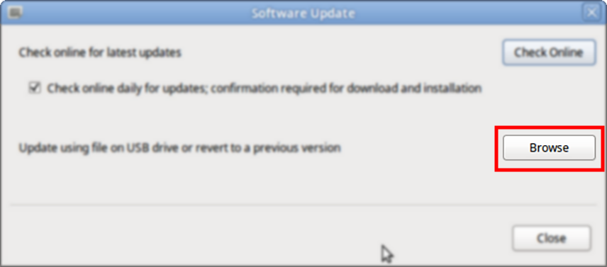

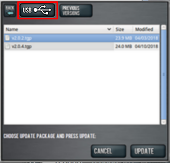

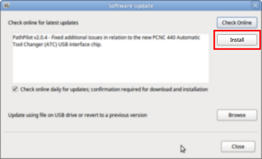

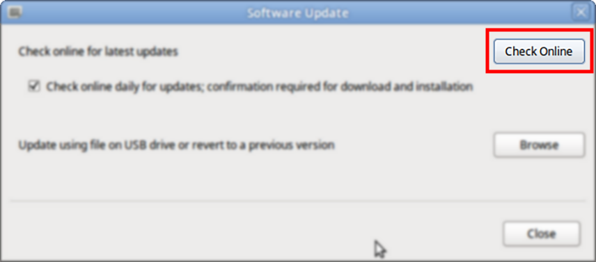

To update PathPilot, do one of the following:
  1. Select Install.
  1. The update file is downloaded, and a notification dialog box displays.
  2. From the dialog box, select OK.
  3. Follow the on-screen instructions to restart the PathPilot controller.
Figure 4: Update button on the Status tab.
Figure 5: Software Update dialog box.
Figure 6: Browse dialog box.
