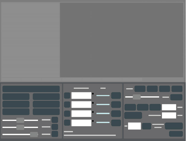

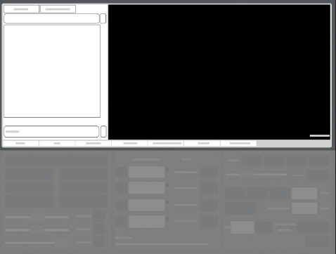

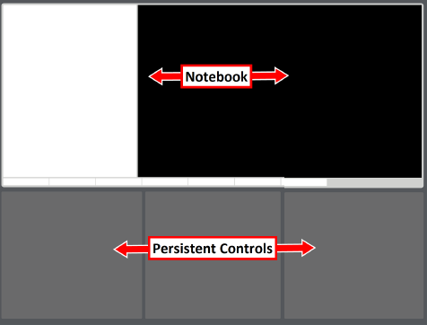

About PathPilot
Notebook Section

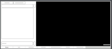

Main Tab
Access G-code files that are already loaded into PathPilot, and open or close them.
For information, see “Load G-code”. -
Send G-code commands directly to the machine using the Manual Data Input (MDI) Line DRO field.
For information, see “Manually Enter Commands”. -
In a G-code program, do tasks like finding specific terms in the code, reading the code, or viewing the generated tool path.
For information, see “Read G-code”.

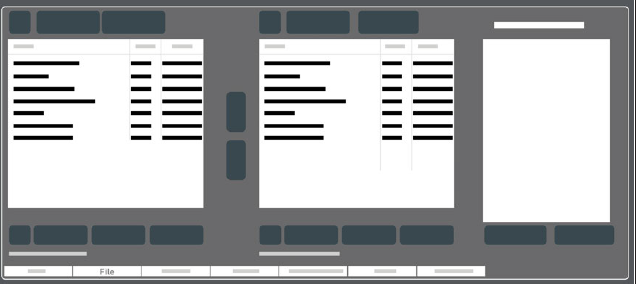

File Tab
Transfer G-code files into the PathPilot controller.
For information, see “Load G-Code”. -
Edit G-code files.
For information, see “Edit G-Code”. -
Load .nc files into PathPilot to run a program.
Move files within the system.
For information, see “Load G-Code”; “Manage System Files”.

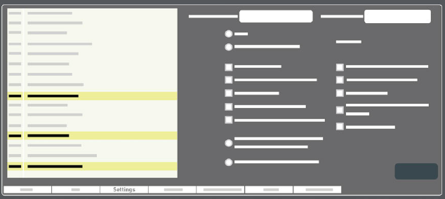

Settings Tab
Change the network name with which you're using PathPilot.
For information, see “Change the Network Name”. -
Change the screen's layout orientation (landscape or portrait).
For information, see “Change the Screen Orientation”. -
Configure PathPilot for the accessories you're using.
For information, see “Enable the On-Screen Keyboard”; “Enable the USB M-Code I/O Interface Kit”; “Use a USB Camera”; “Specify the Tool Change Method”; “Select the Spindle Type”; “Enable the Door Lock Switch Kit”; “Specify Probing and Tool Measuring Options”; “Use the RapidTurn Interface”; “Specify the 4th Axis Rotary Type”. -
Turn on feeds and speeds suggestions when using conversational programming.
For information, see “Enable Feeds and Speeds Suggestions in Conversational Routines”. -
Specify the way in which you want to use a G30 move.
For information, see “Limit a G30 Move”. -
Identify the available G-code modes that you can use.
For information, see “View Available G-Code Modes”.

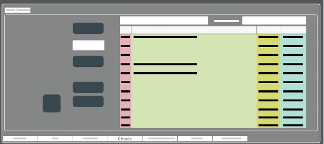

Offsets Tab
Make and restore backup files of your settings.
For information, see “Create Backup Files”; “Restore Backup Files”. -
Import and export .csv files of your tool table.
For information, see “Import and Export the Tool Table”. -
Work with a table of tool descriptions and tool offsets.
For information, see “Set Tool Length Offsets”. -
Use an Electronic Tool Setter (ETS) to measure tools.
Preset a G30 position.
For information, see “Use a G30 Position”. -
Read the currently programmed work offsets.
For information, see “View Work Offsets”.

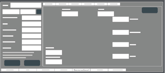

Conversational Tab
Use different functions to create simple G-code programs in PathPilot.
For information, see “Use Conversational Programming”.

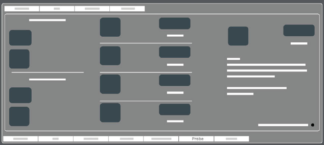

Probe Tab
From the Probe tab, you can do the following activities:
Configure and control a probe to help perform certain functions.
For information, see “Use a Probe with PathPilot”.

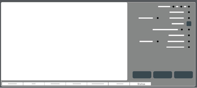

Status Tab
View diagnostic machine information.
For information, see “Troubleshooting”. -
Read error messages.
Configure your internet connection.
For information, see “Enable an Internet Connection (Optional)”. -
Update or install a previous version of PathPilot.
For information, see "Manage PathPilot Versions".

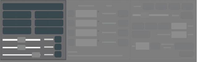

Persistent Controls
Program Control Area
Reset the machine.
For information, see “Bring the Machine Out of Reset”. -
Start, stop, or pause a G-code program.
For information, see “Start a Program”; “Stop Machine Motion”; “Use the Feed Hold Function”. -
Turn coolant on or off.
For information, see “Operate the Coolant Pump”. -
Use overrides to change the feed rate, spindle speed, and maximum velocity.
For information, see “Use the Feed Rate Override Function”; “Use the Maxvel Override Function”; “Use the Spindle Override Function”. -
Manually control a G-code program.
For information, see “Use M01 Break Mode”; “Use Single Block Mode”.

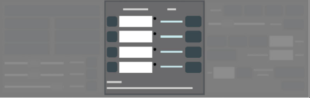

Position Status Area
Reference the machine axes.
For information, see “Reference the Machine”. -
Create work offsets.
For information, see “Set Work Offsets”. -
Understand how you're jogging the machine.
For information, see “View the Active Axis to Jog”; “View the Current Machine Position”; “View the Distance to Go”. -
Quickly determine which G-code modes are active.
For information, see “View the Active G-Code Modes”.

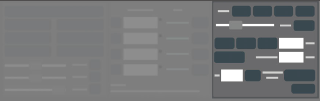

Manual Control Area
Move the machine axes.
For information, see “Jog the Machine”. -
Change the spindle speed or feed rate.
For information, see “Change the Spindle Speed”; “Change the Feed Rate”. -
View or edit information about the current tool.
For information, see “Change the Tool Number”; “Use a G30 Position”; “View the Tool Length”.

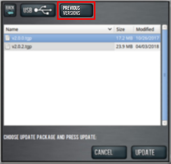

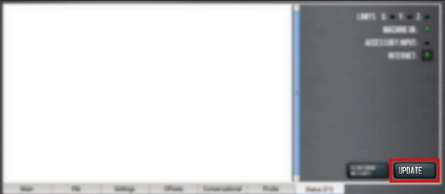

Confirm that the PathPilot controller is powered on and out of Reset mode.

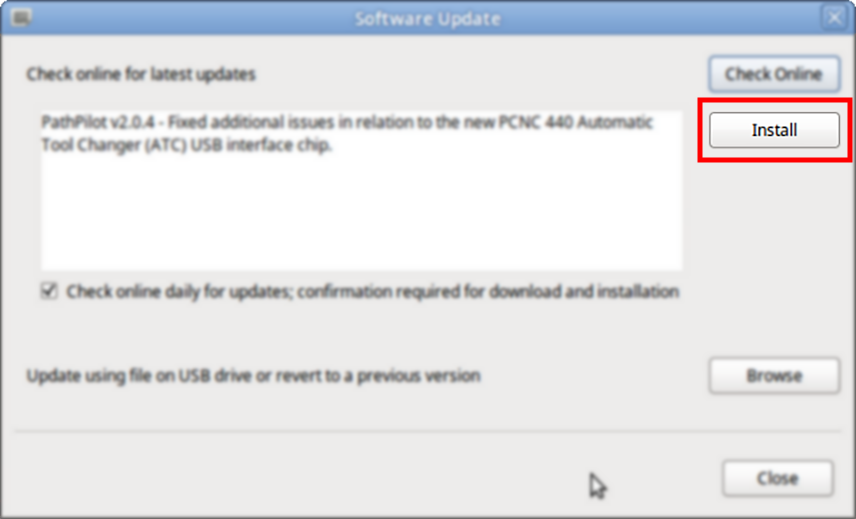

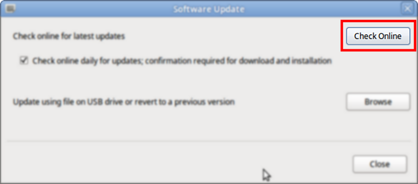

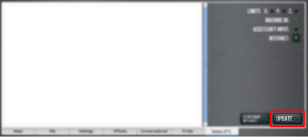

Downloading and installing an update file requires an Internet connection. From the Status tab, confirm that the Internet button LED light is on. (To configure the network, select the LED light.) Then, select Update.
From the Software Update dialog box, select Check Online.
Select Install.
From the dialog box, select OK.
The update file is installed on the PathPilot controller. -
Follow the on-screen instructions to restart the PathPilot controller.
From the PathPilot support center, download the most recent PathPilot update file.
Transfer the PathPilot update file to a USB drive.
Put the USB drive into the PathPilot controller.

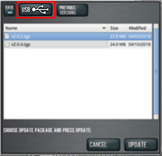

From the Status tab, select Update.

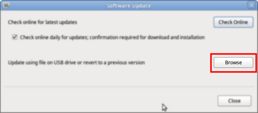

From the Software Update dialog box, select Browse.
From the Browse dialog box, select USB.
Select the desired update file, and then select Update.
From the Browse dialog box, select Previous Versions.
