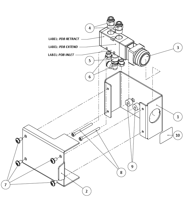

  1. Find the button box assembly provided, which includes the following:
6 ft
Tube, 1/4 in. OD, Nylon (PN 31457)
8 ft
Tube, 5/32 in. OD, Nylon (PN 35922)NOTE: You'll need two pieces of this tube to make the air connections. Cut it in to two 4 ft pieces before connecting the power drawbar button to the cylinder.
Bracket (PN 37333)
Button Box Base (PN 37291)
Button Box Cover (PN 37292)
Nut, Hex, M5 × 0.8 (PN 31201)
M5 × 6 mm Phillips Head Machine Screw (PN 37299)
Screw, Socket Head Cap, M5 × 0.8 - 12 mm (PN 31353)
Power Drawbar Button (PN 37296)
  1. Install the button box base on the mill head with two M5 × 6 mm Phillips head machine screws. Make sure that it's flush with the bottom of the spindle cabinet, as shown in the following image.
Figure 14: Button box base installed on the mill head.
  1. Remove the push button cap and the O-ring from the Power Drawbar button.
Figure 15: Power Drawbar button.
  1. Put the Power Drawbar button in the button box base, and then secure it in place with the O-ring and the push button cap that you removed in Step 4.
  2. Find the coolant hose mount bracket that you set aside in Step 1. Then, install it to the button box cover with two M5 × 12 mm socket head cap screws and two M5 nuts. Set aside the button box cover assembly.
Figure 16: Coolant hose mount bracket installed on the button box cover.
  1. Connect one end of the 5/32-in. plastic tube to the Retract port on the Power Drawbar button.
Figure 17: Power Drawbar button air line routing.
  1. Route the loose end of the Retract air line to the Power Drawbar cylinder, and then connect it to the lowest elbow fitting.
Figure 18: Retract fitting on the Power Drawbar cylinder.
  1. Connect one end of the remaining 5/32-in. plastic tube to the Extend port on the Power Drawbar button.
  2. Route the loose end of the Extend air line to the Power Drawbar cylinder, and then connect it to the top tee fitting.
Figure 19: Extend fitting on the Power Drawbar cylinder.
  1. Use the five cable ties to secure both air lines together.
  2. Connect one end of the 1/4-in. plastic tube to the Air Supply push-to-connect elbow on the Power Drawbar button.
  3. Route the loose end of the 1/4-in. plastic tube out of the enclosure and toward the air compressor.
  4. Put the 1/4 in. push-connect air fitting adapter on the loose end of the 1/4 in. plastic tube.
  5. Route the 1/4 in. plastic tube to your shop's air supply and connect it with the adapter.
  6. Replace the button box cover that you set aside in Step 6 with a Phillips screwdriver and four M5 × 6 mm Phillips head machine screws.

Power Drawbar Push Button
Parts List
ID
Power Drawbar Push Button Base (PN 38217)
Power Drawbar Push Button Cover (PN 38218)
Push Button Air Valve (4-Way, 5-Port) (PN 37295)
Fitting, Male Connector, 1/4 NPT to 1/4 in. PTC (PN 32212)
Fitting, Muffler (Flat), 1/8 NPT (PN 37297)
Screw, Socket Head Cap, M4 × 0.7 - 50 (PN 38220)
Power Drawbar Push Button Spacer (PN 38219)
Decal, Power Drawbar, Release Tool (PN 37340)
