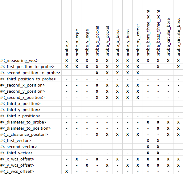

Parameters Used
The probing routines in Pathpilot make use of several parameters, which will need to be set appropriately for each use of a probing routine.
Parameter Use Chart
“X” indicates a required parameter for the given probing routine
“-” indicates an unused parameter for the given probing routine
“O” indicates and optional parameter for the given probing routine
