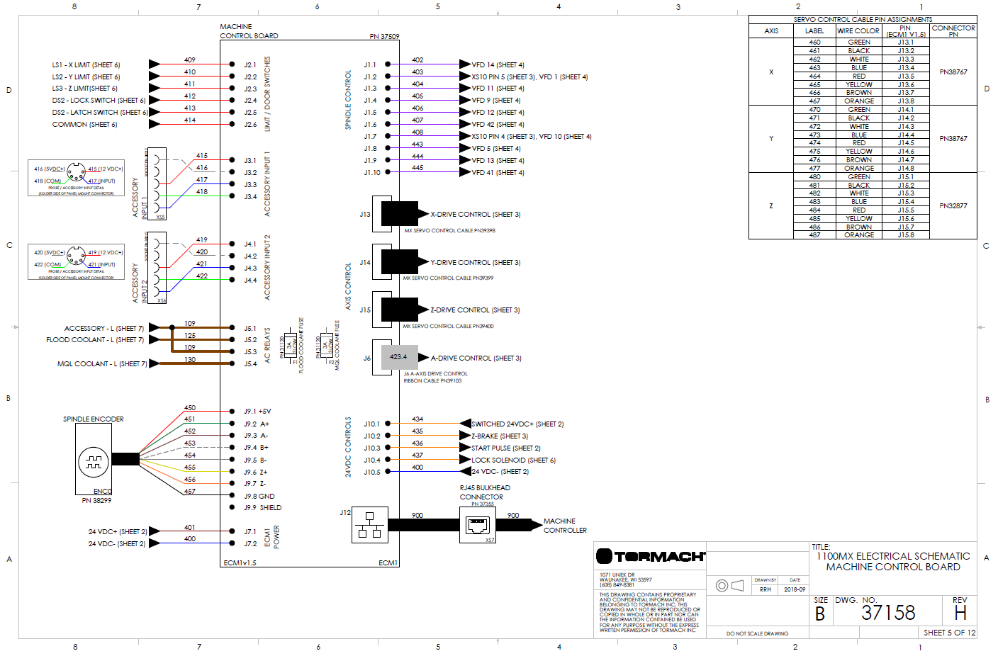

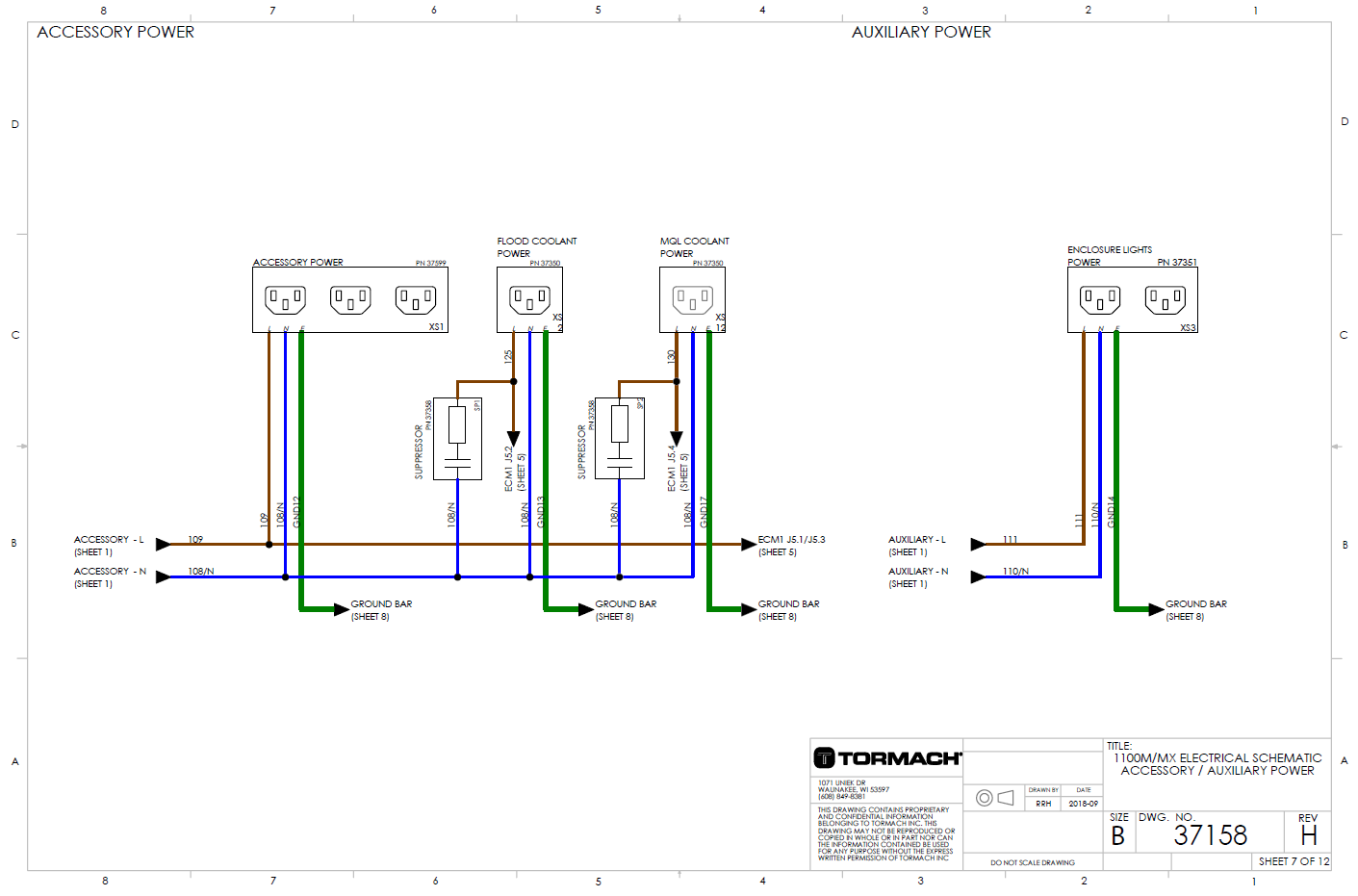

1100MX Knowledge Base
Diagrams and Parts Lists
230 VAC Power - 1100MX
24 VDC Controls - 1100MX
Axis Drive Bus - 1100MX
Spindle Drive - 1100MX
Limit/Door Switches - 1100MX
Grounds - 1100MX
Operator Box Layout - 1100MX
Wiring Table - 1100MX
Operator Console - 110MX
