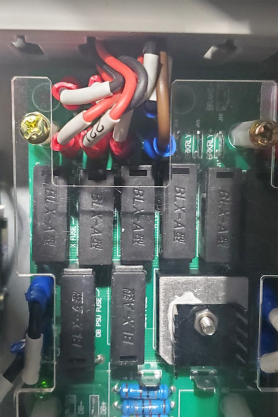

  1. Make sure that all wires on the motor driver and the DC-BUS board are completely connected.
  2. Replace the wire trough covers.

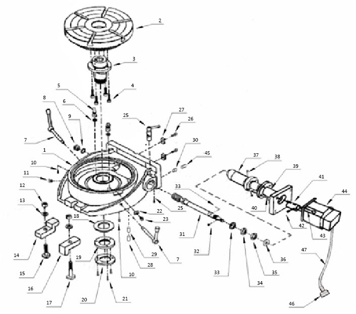

About the Center Hole
The center hole is ground to an MT taper, or a through bore, to fit workholding. On rotary tables with an MT taper, there is also a shallow, concentric pilot hole, used to locate a chuck or other tooling.
Figure 1: Center hole.
Make sure that coolant does not enter the moving rotary table components. If it does, go to "Examine the 4th Axis for Coolant Resistance".
Align the Angle of the Tilt Position
  • Use the Vernier scale to align the angle of the 6 in. Tilting Rotary Table or 8 in. Tilting Rotary Table when moving from horizontal to vertical.
Figure 2: Vernier scale.

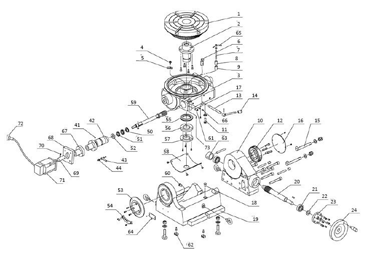

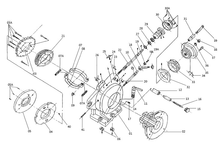

Power is transmitted from the A-axis motor driver to the rotary table by a worm gear at the end of the drive shaft. The eccentric lock stops the eccentric sleeve from rotating.
To turn the rotary table by hand, you must disengage the worm gear. To disengage the worm gear:
  1. Loosen the eccentric lock.
  2. Rotate the eccentric: Turn the motor mount as far as it will rotate in the clockwise direction (counterclockwise on super spacer rotary tables).
  3. Tighten the eccentric lock.
    The worm gear is disengaged.
To reengage the worm gear:
NOTICE! You must use the eccentric lock before engaging the worm drive. If you do not, there is a risk that the motor driver could disengaging during use.
  2. Rotate the eccentric: Turn the motor mount as far as it will rotate in the counterclockwise direction (clockwise on super spacer rotary tables).
    The worm gear is engaged.
  4. Make sure that the worm is completely engaged: If necessary, rotate the rotary table slightly (by hand) to engage the worm gear in the ring gear.
NOTICE! The worm must be completely engaged. If it's not, the rotary table will exhibit excessive backlash.

Standard Rotary Table Exploded View
Standard Rotary Table Parts List
ID
Base
Table
Taper sleeve
Socket head bolt*
Table clamp
O-ring dash 110*
Handle assembly
Sight glass
O-ring
Dog point set screw
11
Plug
12
Hex nut*
13
Washer
14
Clamp
15
T-bolt
16
L-clamp
17
T-bolt
18
Ring
19
Table nut
20
Retaining plate
21
Fillister head screw
22
Indicator
23
Knob
24
Set screw dog point
25
Eccentric lock
26
Socket head bolt*
27
Locating key
28
Set Screw*
29
Backlash Adjustment Screw (PN 34380)
30
Block
31
Worm gear
32
Key
33
Dowel pin
34
Spacer
35
Lock nut
36
Spacer with keyway
37
Eccentric sleeve
38
39
Motor mount
40
Socket head screw*
41
Coupling
6” (PN 31840)
8” (PN 30715)
42
Set Screw*
43
Socket head screw*
44
Motor complete
6” (PN 32677)
8” (PN 32379)
45
Oil plug
46
Power plug
47
Cable
(not shown)
Oil fitting (PN 35220)
*Standard hardware items
Tilting Rotary Table Exploded View
Tilting Rotary Table Parts List
ID
Table
Taper sleeve
Base
Knob
Indicator
Table clamp
Bolt
Locking pad
Locking pillar
Supporter
11
Positioning screw
12
Helical gear
13
Eccentric axle
14
Table clamp handle
15
Locking lug
16
Cover
17
Backlash adjustment screw (PN 34380)
18
Positioning block
19
Base
20
Screw bar
21
Bearing
22
Sealing
23
Cover
24
Handle wheel
41
Pin
42
Eccentric sleeve
43
Handle
44
Bolt
50
Spacer
51
Spanner nut
52
Spacer
53
Indicate plate
54
Vernier
55
Spacer
56
Locating nut
57
Locating nut
58
Cover
59
Worm gear
60
Positioning block
61
Pin
62
Locating key
63
Block
64
Name plate
65
Eccentric lock
66
Bolt
68
Socket head screw
69
Motor coupling
6” (PN 31840)
8” (PN 30715)
70
Set screw
71
Motor complete
6” (PN 32677)
8” (PN 32379)
72
Power plug
(not shown)
Oil Fitting (PN 35220)
Super Spacer Rotary Table Exploded View
Super Spacer Rotary Table Parts List
ID
Body
Spindle
Index plate
3A
Screw
Masking plate
Bumper plate
5A
Screw
Centering key w/ screw
Brake shoe
7A
Spring
Brake shoe
Screw
Screw arbor
11
Index handle
12
Sleeve
13
Index pin
14
Gear shaft
15
Cover
16
Spring
17
Screw
18
Clamp handle
19
Bushing
19A
Screw
20
Vernier scale
21
Ring gear
22
Worm gear
23
Indicating plate
24
Pin w/ inclined surface
25
Handle
26
Name plate
27
Spacer
28
Screw nut
29
Eccentric sleeve
30
Shaft sleeve
31
Set screw
32
40
Locating pin for masking plate
41
Screw
(not shown)
