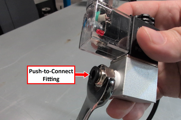

  1. Apply thread seal tape to the 1/4 in. NPT push-to-connect fitting, and then install it into the solenoid using a 15 mm wrench.
Figure 1: Installing the push-to-connect fitting into the solenoid.

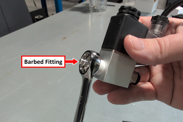

  1. Apply thread seal tape to the 1/4 in. NPT barbed fitting, and then install it into the solenoid using a 15 mm wrench.
Figure 2: Installing the barbed fitting into the solenoid.

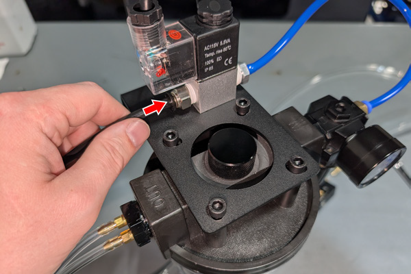

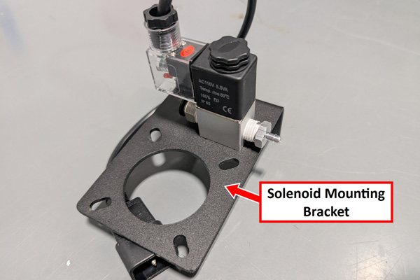

  1. Install the solenoid onto the solenoid mounting bracket with two M4 × 5 mm Phillips head screws using a screwdriver.
Figure 3: Solenoid installed onto the solenoid mounting bracket.

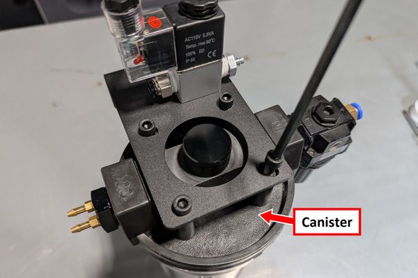

  1. Mount the solenoid and bracket assembly onto the top of the canister with four M6 socket head cap screws using a 5 mm hex wrench. Make sure that the barbed fitting is pointed towards the pressure regulator.
Figure 4: Installing the solenoid mounting bracket onto the canister.

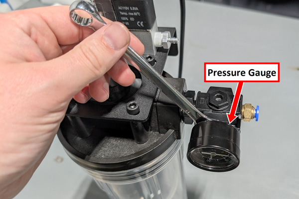

  1. Apply thread sealant tape to the threads of the pressure gauge, and then install it into the air pressure regulator using an 11 mm wrench.
Figure 5: Installing the pressure gauge onto the air pressure regulator.

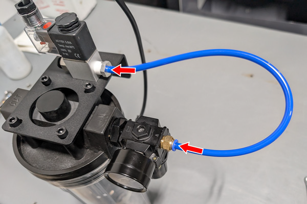

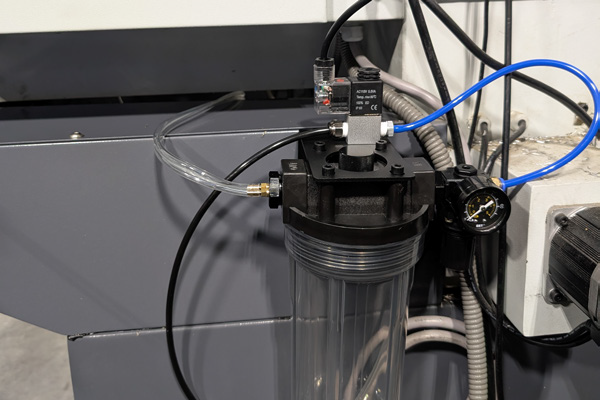

  1. Install one end of the short blue tubing into the pressure regulator and the other end of the tubing onto the barbed fitting on the solenoid.
Figure 6: Blue tubing installed between the pressure regulator and the solenoid.

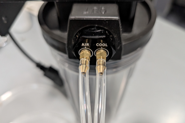

  1. Prepare the duplex tubing:
  • Split the tubes apart on one end and connect them to the barbed outlet fittings on the canister.
Figure 7: Duplex tubing connected to the canister.
  • On the opposite end, separate the tubes approximately 5 in. back from the end.

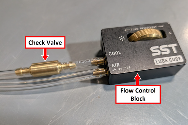

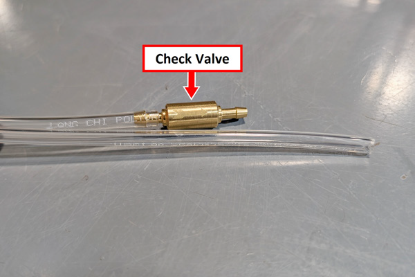

  1. Identify which tube connects to the canister fitting labeled Cool. Trace that tube to the loose end and cut approximately 3 in. from the end. Set aside the removed section.
  2. Install the brass check valve onto the tube connected to the Cool fitting. Make sure that the arrow on the valve points away from the canister.
Figure 8: Check valve installed onto the previously cut tubing.
  1. Install the removed tubing section onto the other end of the check valve.

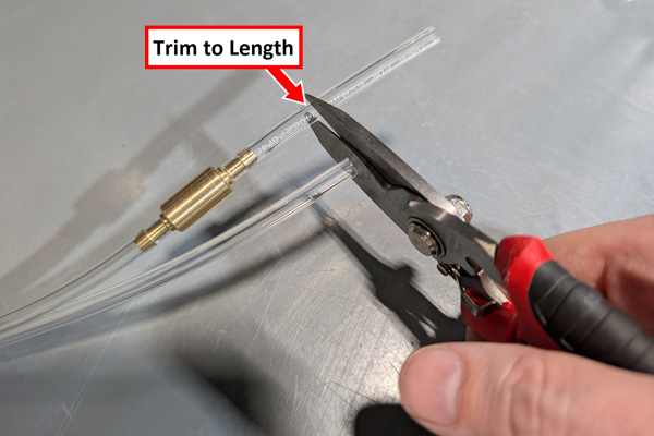

  2. Trim the longer of the two tubes so that both tubes are equal in length.
Figure 9: Trimming the duplex tubing to length.
  1. Connect the duplex tubing to the flow control block. The tube with the check valve connects to the barbed fitting labeled Cool.
Figure 10: Duplex tubing connected to the flow control block.

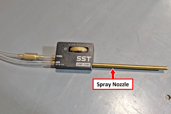

  1. Install the spray nozzle into the flow control block.
Figure 11: Spray nozzle installed on the flow control block.
NOTE: Thread seal tape isn't required because this port is sealed.

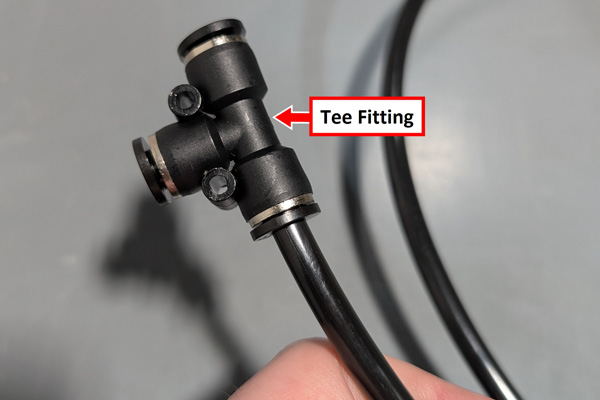

  1. Install the push-to-connect tee fitting onto the loose end of the 1/4 in. black tubing.
Figure 13: Tee fitting installed on the loose end of the 1/4 in. black tubing.

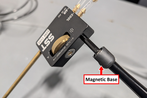

  1. Thread the magnetic base into the bottom of the flow control block.
Figure 14: Magnetic base threaded onto the flow control block.

  1. On the back of the chip pan below the electrical cabinet, locate the two threaded M5 holes. Mount the canister to the chip pan using two M5 button head cap screws.
Figure 15: Lube Cube mounted on the back of the chip pan.

  2. Unthread the magnetic base from the bottom of the flow control block. Then, route the flow control block underneath the electrical cabinet and into the enclosure.
  3. Reinstall the threaded magnetic base into the flow control block.
  4. Mount the flow control block to the machine table or the spindle head sheet metal using the magnetic base.

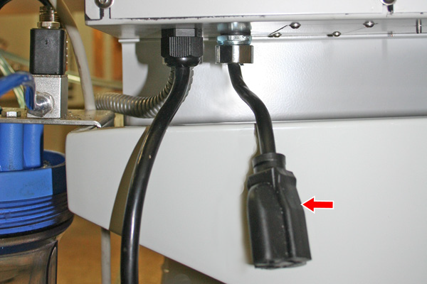

PCNC 440 Mills
  1. Hang the canister onto the back of the chip pan using the solenoid mounting bracket.
  2. Route the loose end of the solenoid power cable to the electrical cabinet, and plug it into the cord end.
Figure 16: Cord end on the bottom of the electrical cabinet.

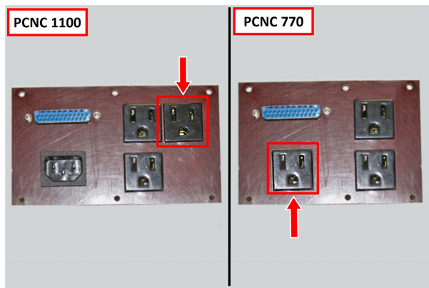

PCNC 1100 and PCNC 770 Mills
  2. Route the loose end of the solenoid power cable to the power connection panel (under the electrical cabinet), and plug it into the Coolant outlet.
Figure 17: Coolant outlets on the power connection panels.

  2. Use the tee fitting installed on the 1/4 in. black tubing to splice into the air supply line.
