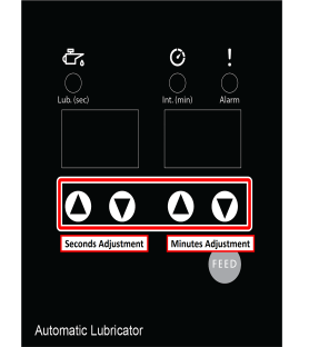

  1. On the oiler's control panel, push and hold either of the Minutes Adjustment buttons. It doesn't matter which button you push.
Figure 3: Automatic oiler control panel.
The oiler beeps.
  1. While looking at the Minutes display, do one of the following:
    1. To increase the interval time, push the Up Arrow. We recommend that you set it to 480 minutes (eight hours).
    2. To decrease the interval time, push the Down Arrow.
NOTICE! Pressure Hazard: To avoid potential equipment damage, don't set the interval time to less than five minutes.

  1. On the oiler's control panel, push and hold either of the Seconds Adjustment buttons. It doesn't matter which button you push.
The oiler beeps.
  1. While looking at the Seconds display, do one of the following:
    1. To increase the interval time, push the Up Arrow. We recommend that you set it to 12 seconds.
NOTICE! Pressure Hazard: To avoid potential equipment damage, don't set the actuation time to more than three minutes.
