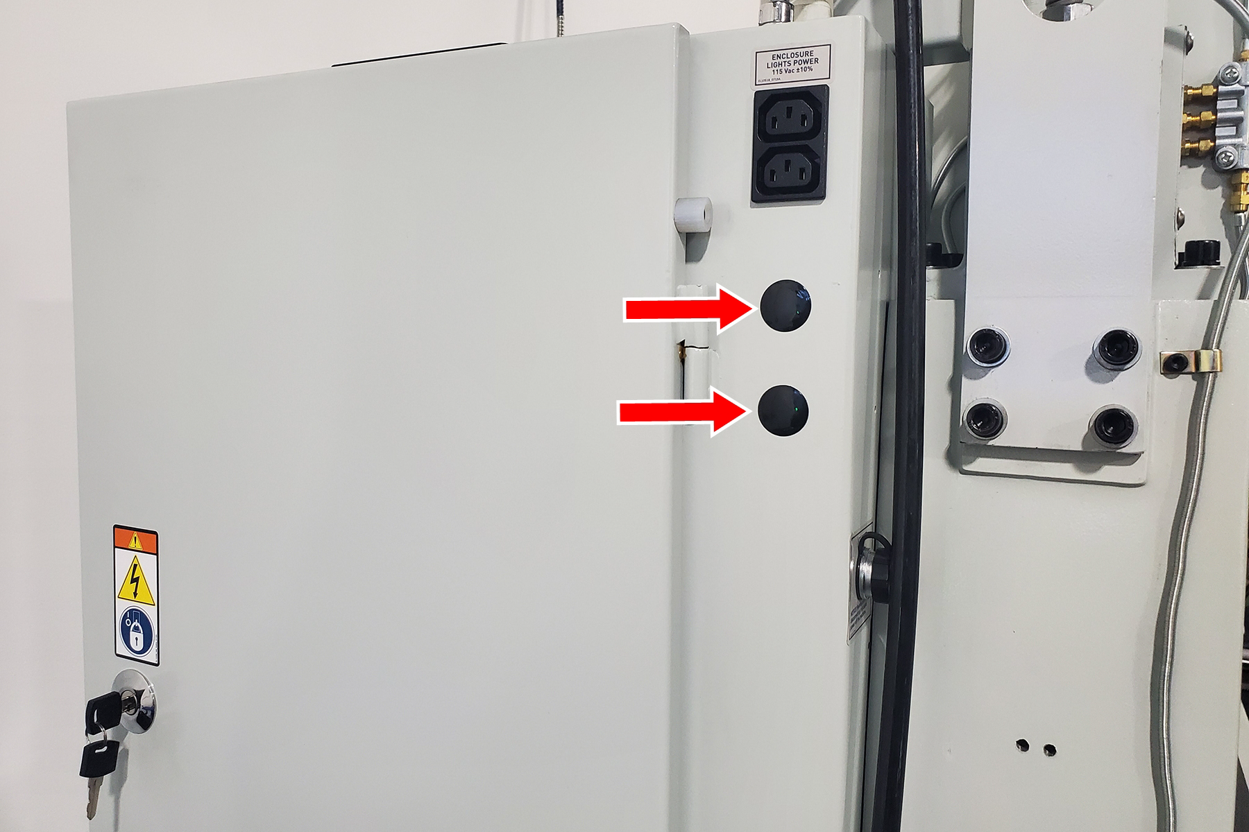

  2. Locate the knockout holes on the machine column as shown in the following image. You’ll use one of them to route the power cord wires into the electrical cabinet.
Figure 1: Knockout holes on the machine column.
  1. Place the cord grip into one of the knockout holes, and secure it in place.
  2. Strip approximately 3 ft of the insulation from the end of the power cord to expose the individual wires.
  3. Crimp ferrules onto the stripped ends of the power cord, and onto each end of the 16 gauge wire.

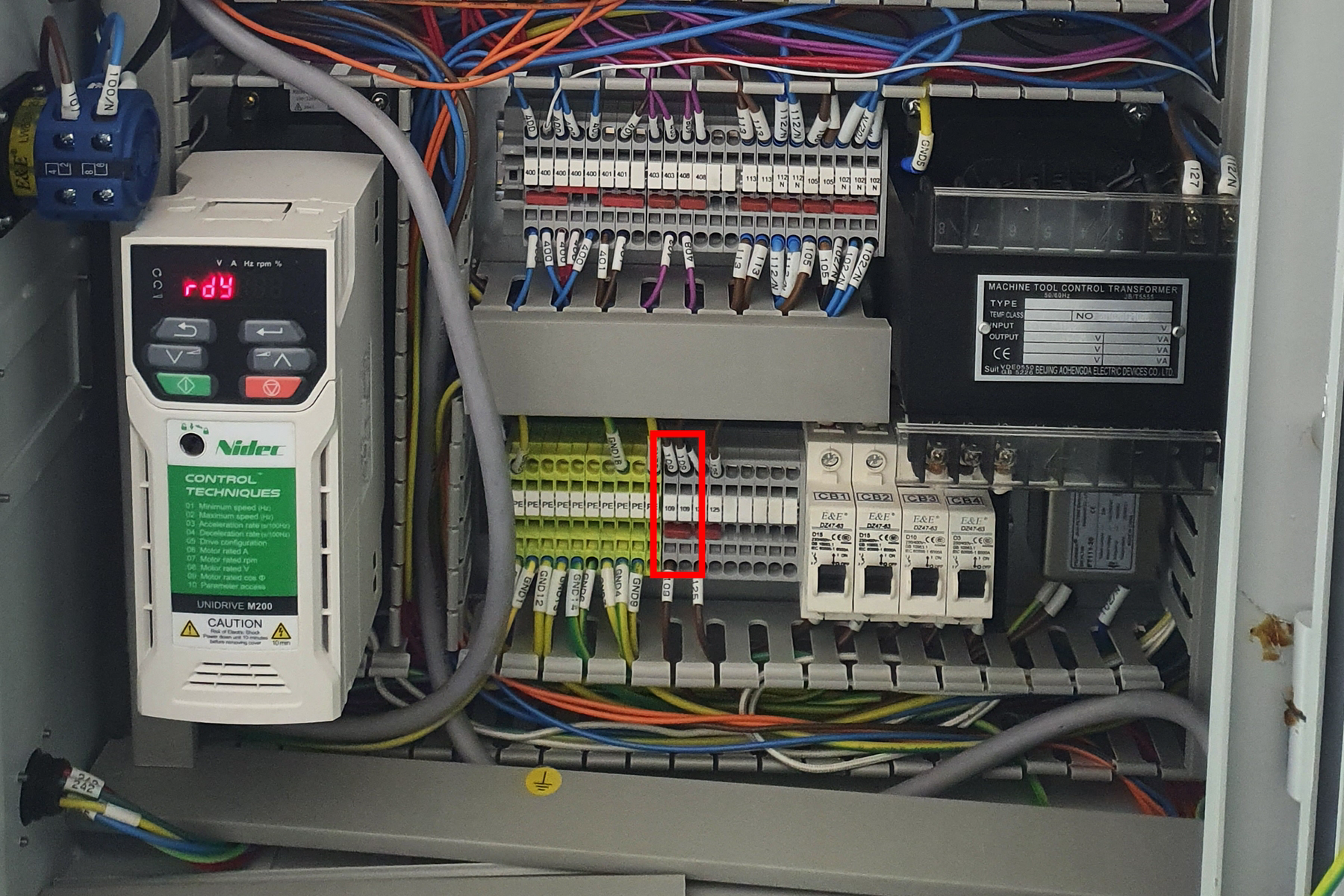

  1. Locate the 109 terminal blocks between the green PE terminal blocks and the circuit breakers.
Figure 2: 109 terminal blocks.

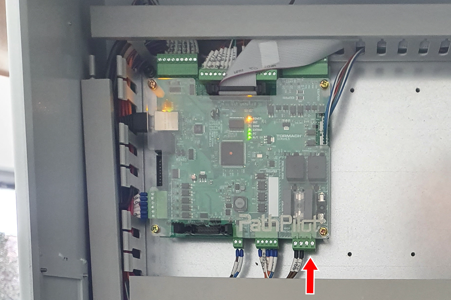

  1. Connect one end of wire 109 (the 16 gauge wire) to the open terminal block position under the “109” label. Run the other end of the wire to J5.3 of the ECM board.
Figure 3: ECM board.
  1. Connect wire 130 (the black wire of the power cord) into J5.4 of the ECM board.

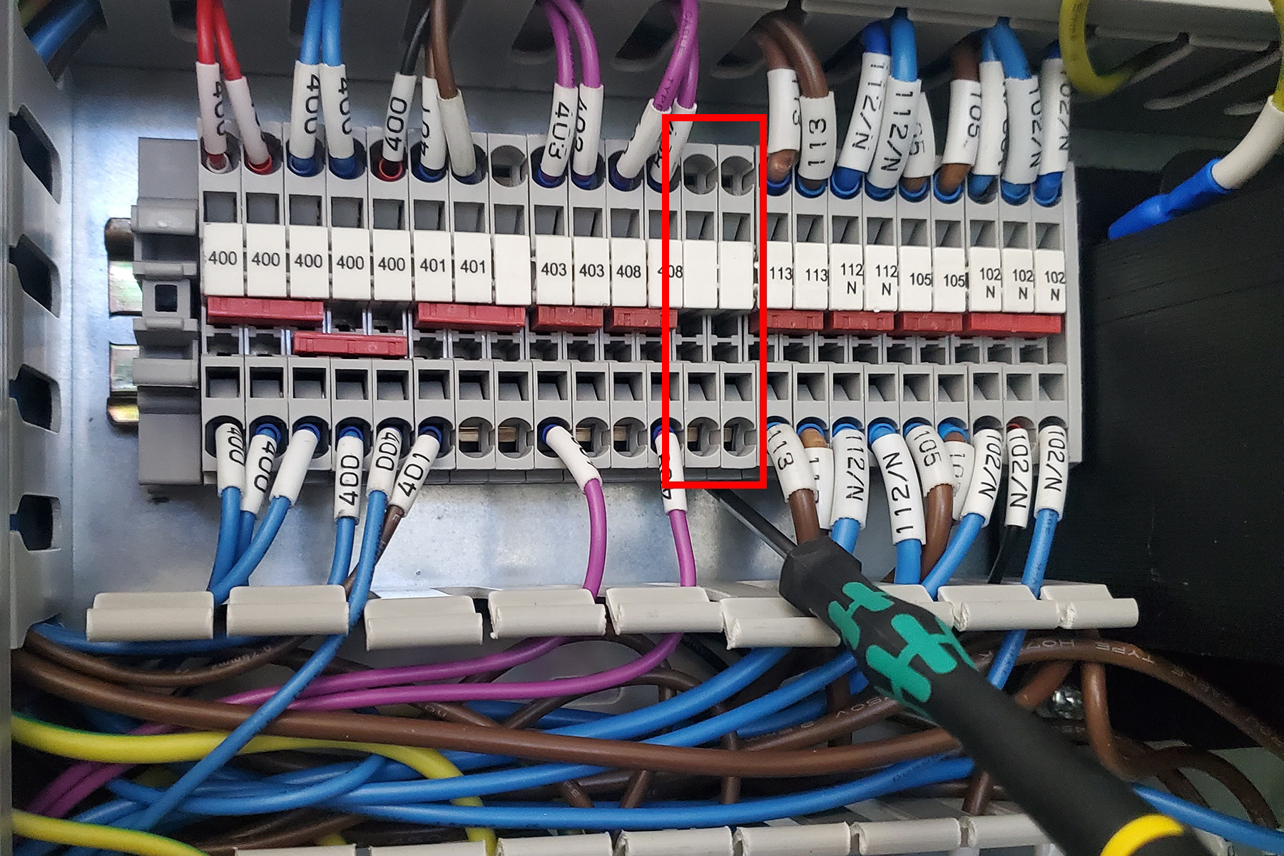

  3. Locate the empty terminal blocks between the terminal blocks labeled “408” and “113”. Remove one of the empty terminal blocks from the DIN rail.
Figure 4: Empty terminal blocks.

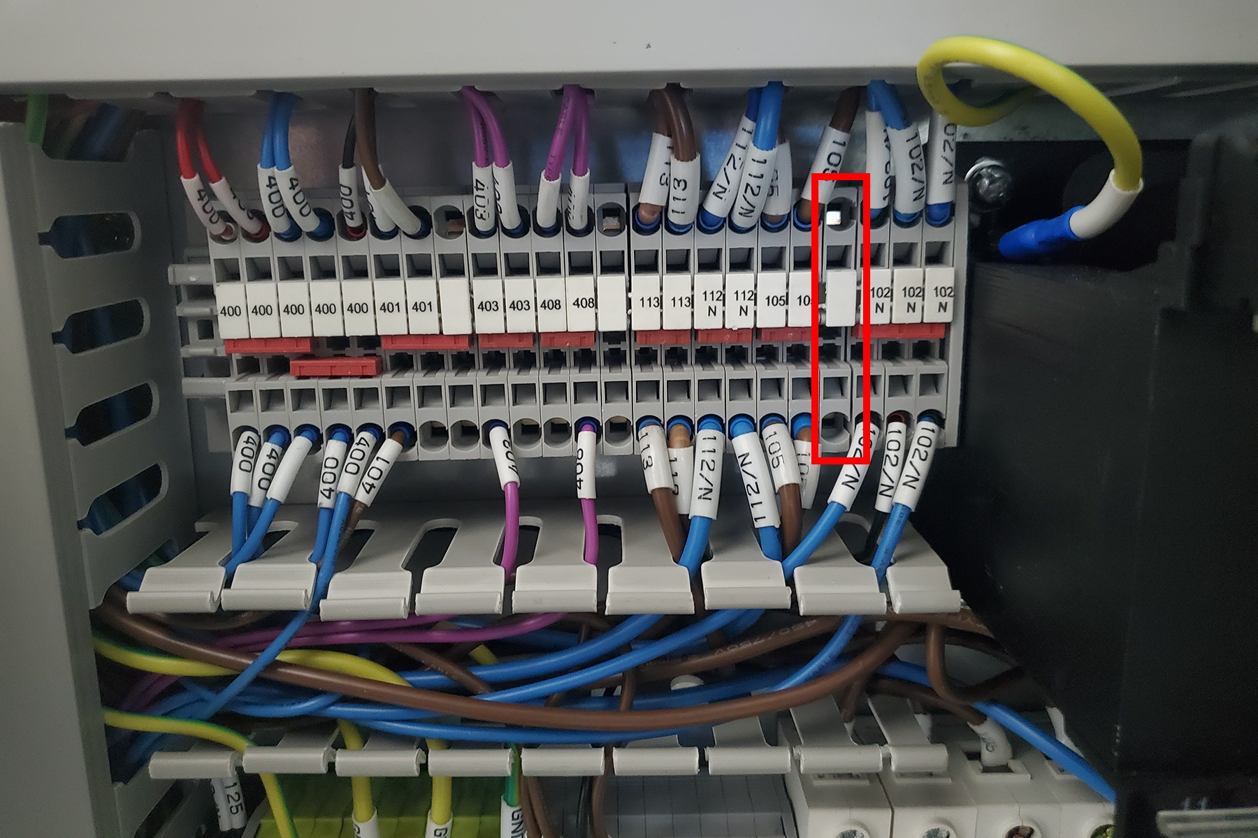

  1. Slide all of the terminal blocks to the left of the “102 N” terminal blocks to the left to make space for the empty terminal block. Insert the empty terminal block on the left side of the “102 N” terminal blocks.
Figure 5: Empty Terminal block moved next to 102 N terminal blocks.
  1. Remove the 3-position red jumper from the “102 N” terminal blocks, and insert the 4-position red jumper across the three “102 N” terminal blocks and the newly inserted terminal block.
  2. Insert wire 102 N (the blue wire of the power cord) into one of the positions of the newly inserted terminal block.

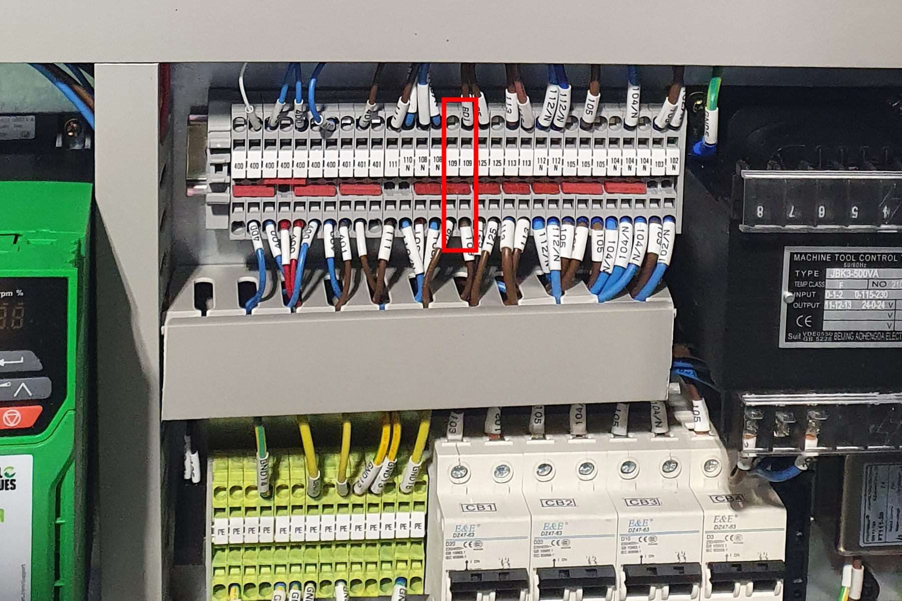

  1. Locate the 109 terminal blocks above the green PE terminal blocks and the circuit breakers.
Figure 6: 109 terminal blocks.

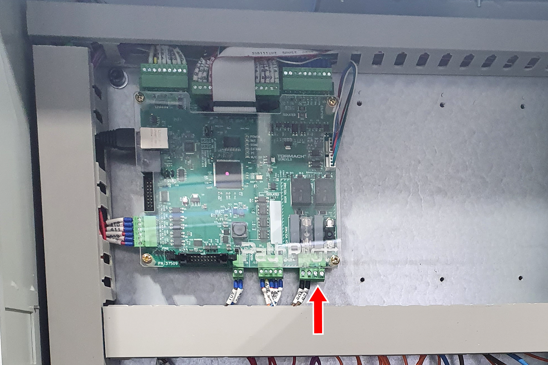

  1. Connect one end of wire 109 (the 16 gauge wire) to the open terminal block position under the “109” label. Run the other end to J5.3 of the ECM board.
Figure 7: ECM board.
  1. Insert wire 130 (the black wire of the power cord) into J5.4 of the ECM board.

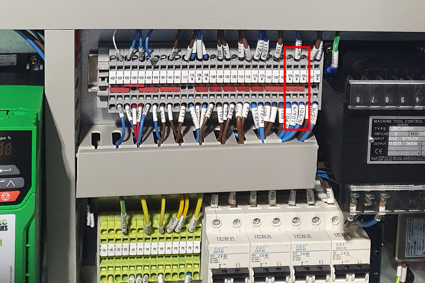

  3. Locate the 104 N terminal blocks, and insert wire 104 N (the blue wire of the power cord) into the terminal block.
Figure 8: 104 N terminal blocks.

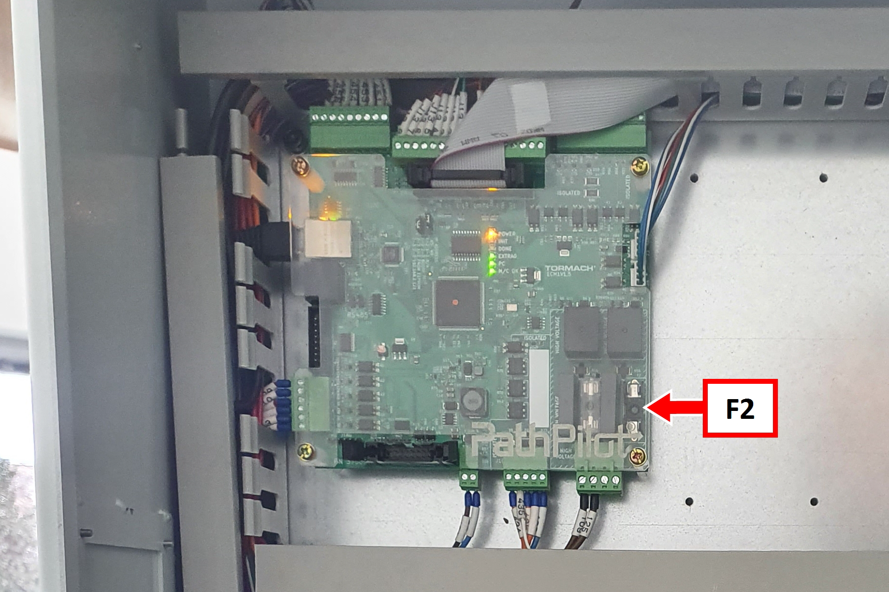

Install Fuse F2
  1. Install a 3 A fuse into the fuse holder labeled “F2” on the ECM board.
