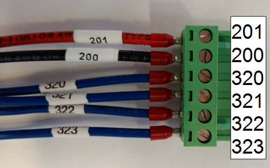

  4. Thread the two spade terminals on wires 200 and 201 through the Z column and connect them to V- (200) and V+ (201).
    NOTE: If you already have a SmartCool™ or an ATC installed, the 4th axis shares those terminals.

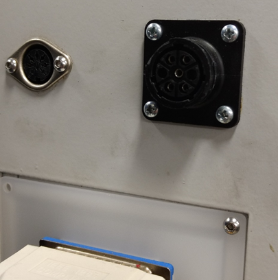

  1. Remove the square knockout panel on the side of the cabinet and install the circular connector.
    You will need to disconnect wires 320 through 323 from the green terminal block to feed them in from the outside.

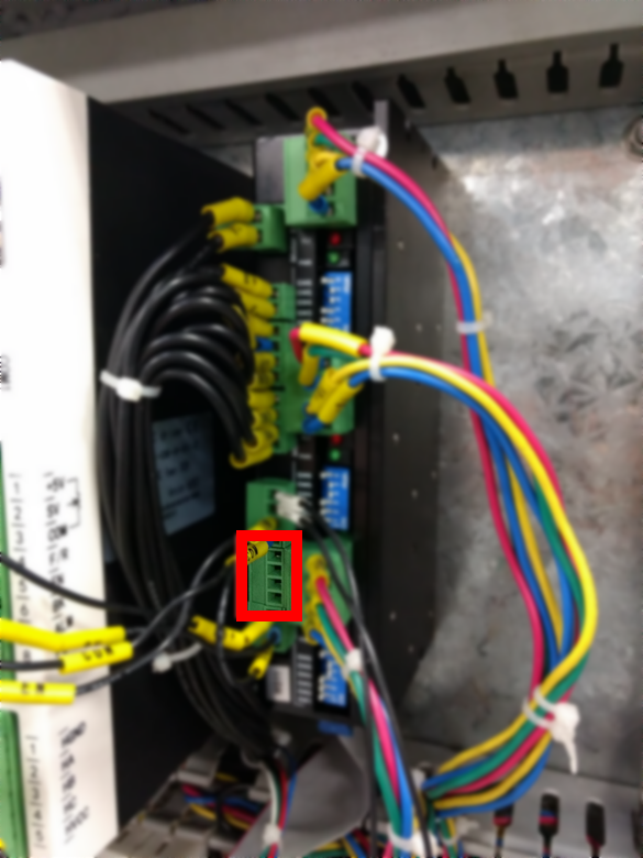

  1. Reconnect the four wires (320 - 323) that you fed through the knockout to the 4th axis terminal block in the order shown in the following image.

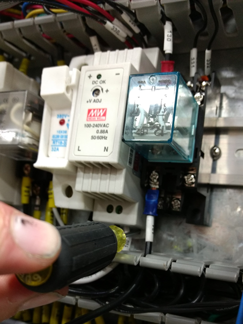

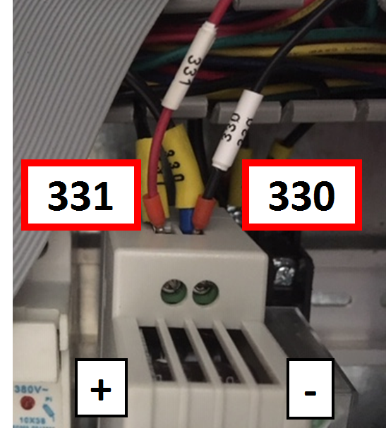

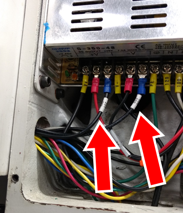

  1. Using a flat blade screwdriver, unclip the 24V power supply from the DIN rail and tilt it out of the cabinet.
  1. Connect the wire labeled 331 alongside the existing wire on the + output side of the 24V power supply.
  2. Connect the wire labeled 330 alongside the existing wire labeled 330 on the - output side of the power supply.
  1. Gently tug on each of the power supply wires to verify that they're firmly seated in the terminals. Then, clip the power supply back to the DIN rail.

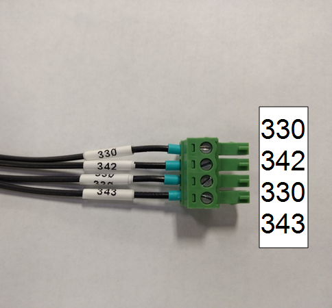

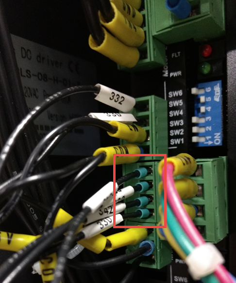

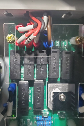

  2. Remove the empty green connector from OUT3 and OUT4 on the machine control board. You'll replace it with the one supplied on your 4th axis wiring harness.

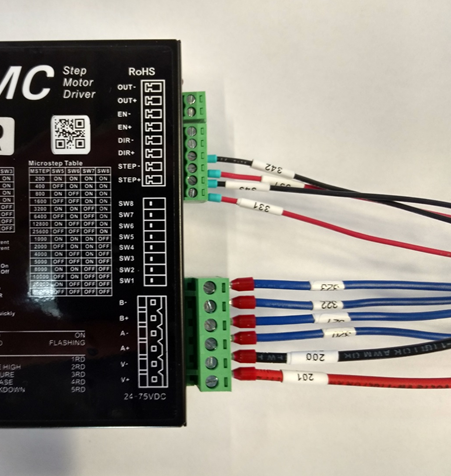

  1. Wires 343, 330, 342, and 330 are already preinstalled in a replacement connector, corresponding to positions 3+, 3-, 4+, and 4- on the machine control board.
  1. Install the connector on the machine control board.
  1. Plug the remaining two 6-pin connectors into the 4th axis stepper driver.

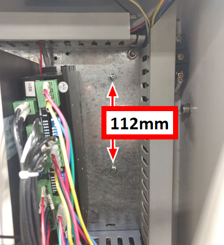

  1. Drill and tap two M4 holes with a 112 mm spacing on the back panel of the electrical cabinet to mount the stepper driver.
  1. Tuck all wires into wire troughs and reinstall the rear panels on the machine.

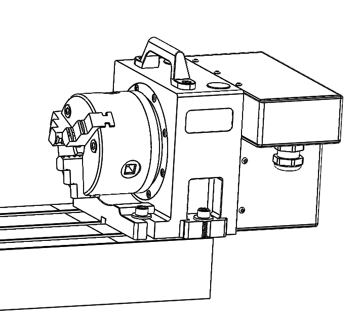

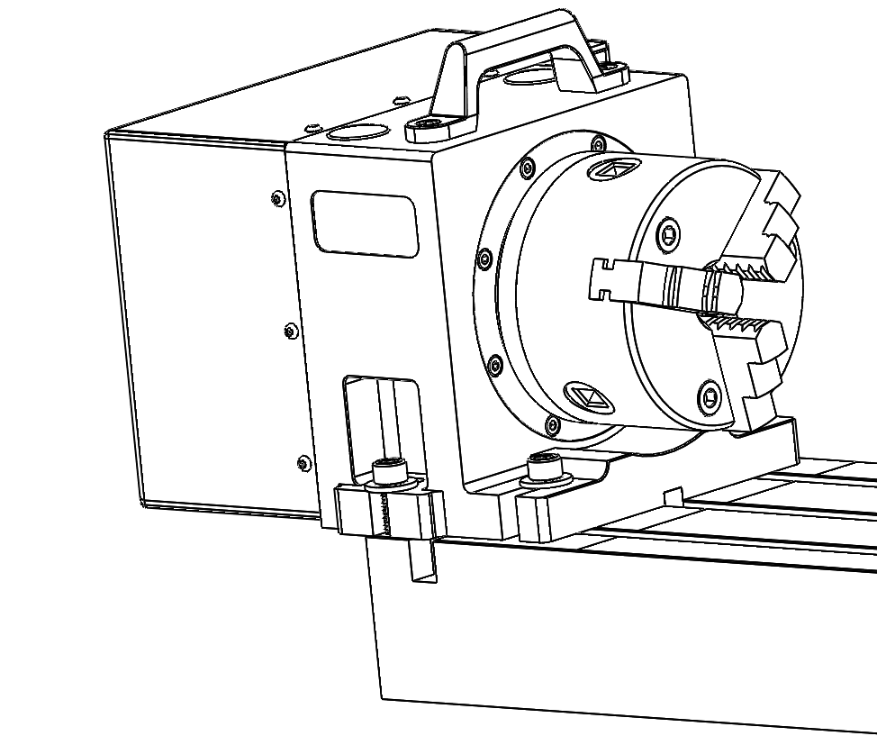

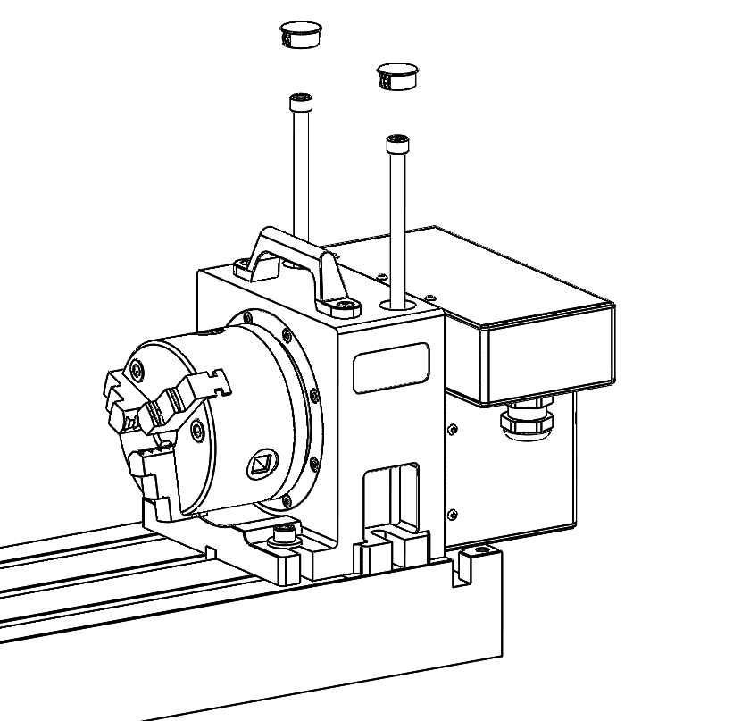

  2. Put the microARC 4 on the machine table. There are several mounting configurations available, depending on the particular needs of a given project:
    1. Left Side (Using Accessory Mounting Holes) This configuration provides the maximum available X work space. If used with an ATC, the available tool clearance is 10 cm from TTS flange to tool tip with the 4th axis carrying handle removed.
b. Right Side (Using Accessory Mounting Holes) Using the 4th axis on the far right side of the machine table provides the most X work envelope, but interferes with the right side enclosure window, if installed.
c. Right Side (Using 6" Through-Bolts into T-Slots) X work envelope is reduced in this configuration, but it provides clearance for long tooling in the ATC.
  1. Feed the motor cable under the electrical cabinet and plug it into the 7-pin connector you installed with the driver kit.
  2. Loosely install the 5/16" mounting bolts, using either the threaded accessory mounting holes on your machine table or T-nuts.
  3. Use the key on the bottom of the 4th axis to perform a rough alignment of the unit to the T-slots in your machine's table. If you need to perform a precise alignment, put a straight test bar into the chuck and sweep along it in X with an indicator. Adjust the orientation of the 4th axis until the reading does not deviate during the sweep.
  4. Tighten the mounting hardware with a hex wrench.

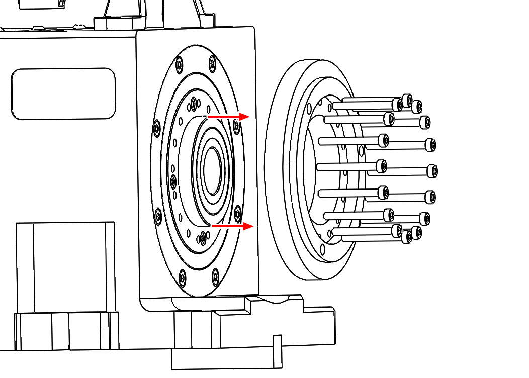

  1. Remove the chuck from the 4th axis, if installed.
  2. From the PathPilot interface, verify that you can rotate the 4th axis with either the jog keys on the keyboard or the jog shuttle.

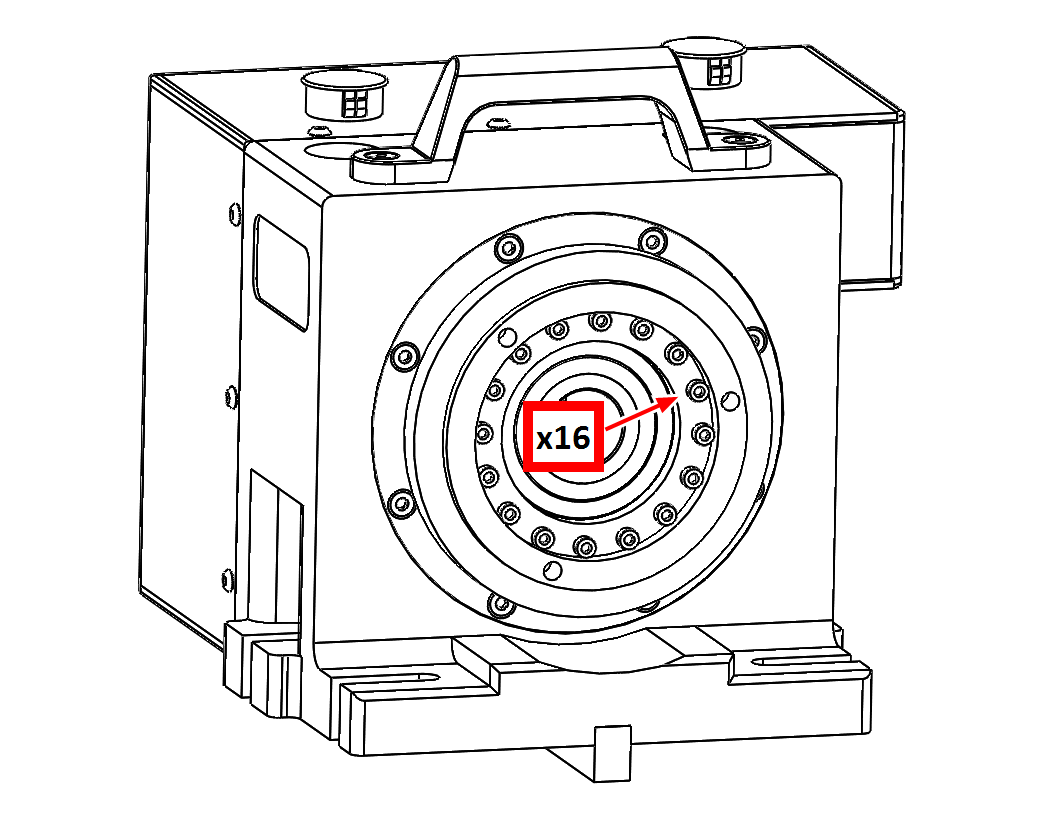

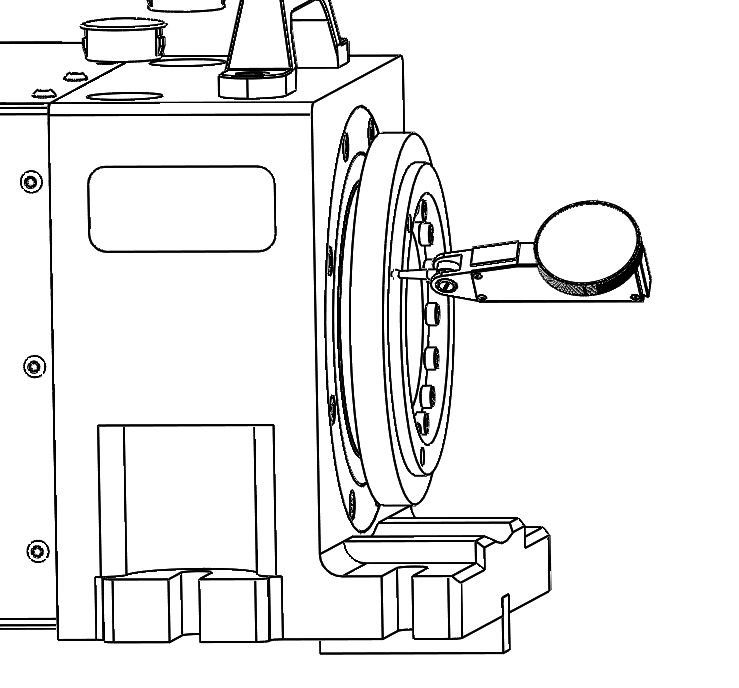

  3. The mounting plate is designed for a loose fit onto the output of the harmonic drive. This allows you to adjust the center of rotation to control runout at the chuck.
  1. Slightly loosen the 16 M3 button head cap screws that hold the chuck mounting plate to the output of the harmonic drive. They should still be snug enough that the mounting plate is held in place by friction but can be nudged with a dead-blow hammer.
  1. Put a the tip of a dial test indicator on the mounting flange for the chuck.
  1. Using PathPilot, jog the 4th axis 360 degrees, noting the spot where the indicator is highest.
  2. Using the dead-blow hammer, gently tap the highest indicated spot towards the center and repeat the 360 degree sweep. Continue adjusting the high spot towards the center of rotation and sweeping until you reach your desired runout.
  3. Tighten the 16 M3 mounting screws by hand to 1.1 Nm.
