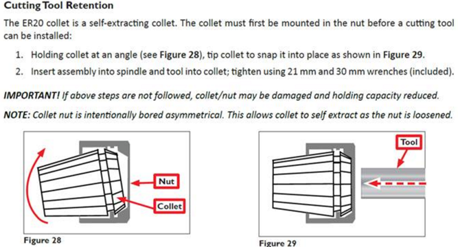

Toolholders
Proper tool holding is a basic, yet, vastly overlooked key to machining. Using proper fitting collets, tool holders, chucks, etc, along with choking up as much as possible on your tool, will give you the most rigid set up as possible. Rigidity in your tooling, gives your tool its best chance at performing to its maximum ability. A common error is ER collets not seating properly. Below is a helpful graphic, that shows the correct alignment of the collet system.
