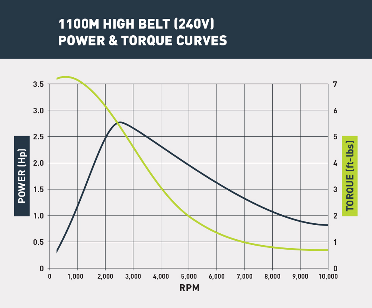

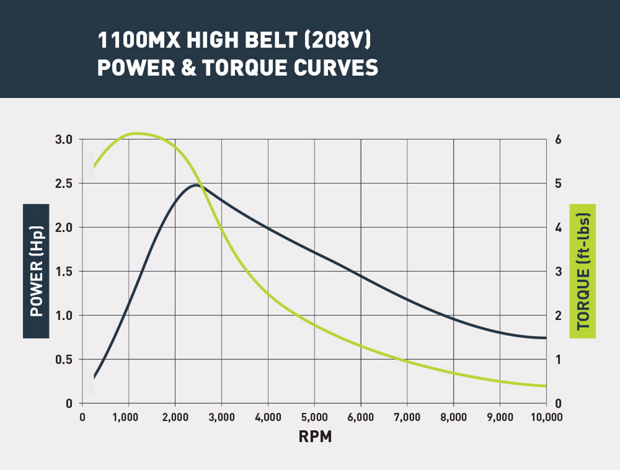

Shown below are the results of motor testing done on the 1100MX spindle.
208V High Belt
240V High Belt
