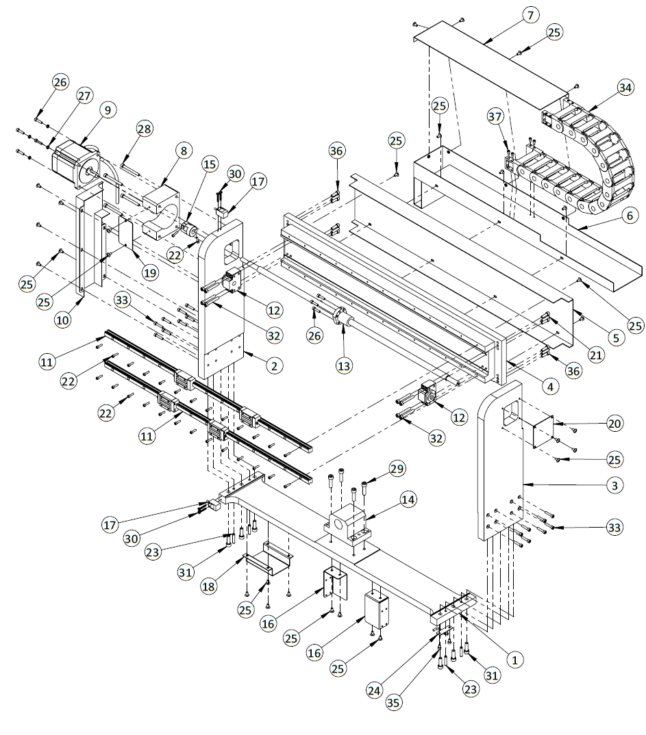

Gantry - 24R
Alternative Part Number
Lower Gantry Cross Beam*
Bridge Support, Left Side (PN 39057)
Bridge Support, Right Side (PN 39058)
X-Axis Bridge*
Rear Cover, X-Axis Bridge*
X-Axis Wire Tray*
X-Axis Wire Track Cover*
Motor Mount, NEMA 34*
Motor, Stepper, NEMA 34, 1.2 deg, 450 Ncm, 3-phase, 400 mm Cable (PN 50374)
Cover, Gantry Left Side*
11
Linear Guideway Assembly, X-Axis (PN 39066)
Linear Rail, X-Axis 15 mm × 800 mm*
X/Z-Axis Linear Guide Block (PN 39301)
Linear Rail Bolt Cap*
13
12
Ball Screw Support Bearing, Fixed (PN 38328)
13
X-Axis Ball Screw Assembly (PN 39302)
Ball Screw, Rolled, 15 mm × 5 mm - 853 mm*
X-Axis Ball Nut (Nut Only)*
14
Ball Nut Carrier, Y-Axis*
15
Shaft Coupling, Jaw, One Piece Split, 10 mm × 0.5 in. - 35 mm (PN 39318)
16
Y-Axis Drag Chain Bracket*
17
Limit Switch, Rectangular Proximity Sensor (PN 39074)
18
Y-Axis Cable Tray*
19
Cover, XY Axis Motor Mount*
20
Access Cover, X-Axis Ball Screw Mount*
21
Pin, 6 mm × 28 mm, Steel, Pull-Out, M4*
22
Screw, Socket Head Cap, M4 × 0.7 - 16
McMaster-Carr: 91290A154
28
23
Pin, 6 mm × 30 mm, Steel, Pull-Out, M4*
24
Remote Oil Line Fitting*
25
McMaster-Carr: 97654A376
29
26
McMaster-Carr: 91290A242
27
Washer, Split Lock, M5
McMaster-Carr: 91111A124
28
Screw, Socket Head Cap, M6 × 1 - 60
McMaster-Carr: 91290A344
29
Screw, Socket Head Cap, M8 × 1.25 - 30
McMaster-Carr: 91290A434
30
Screw, Pan Head Machine, M4 × 0.7 - 25, Stainless Steel
McMaster-Carr: 90116A221
31
Screw, Socket Head Cap, M8 × 1.25 - 25
McMaster-Carr: 91290A432
32
Screw, Socket Head Cap, M6 × 1 - 45
McMaster-Carr: 91290A338
33
McMaster-Carr: 91290A252
16
34
Drag Chain, X-Axis (PN 39061)
35
Screw, Socket Head Cap, M5 × 0.8 - 8
McMaster-Carr: 91290A222
36
Screw, Socket Head Cap, M6 × 1 - 20
McMaster-Carr: 91290A326
37
Screw, Socket Head Cap, M4 × 0.7 - 8
McMaster-Carr: 91290A140
