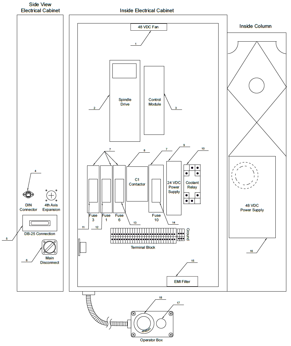

Electrical Cabinet - PCNC 440
48 Vdc Fan (PN 35629)
Spindle Drive (PN 35621)
PCNC 440 Axis Motor Drive - MX3660 (PN 33374)
DIN Connector Assembly (PN 37282)
DB-25 Ribbon Cable Assembly (PN 35721)
Main Disconnect (PN 35720)
Single Fuse Block (PN 30511)
C1 Contactor (PN 31659)
24 Vdc Power Supply (PN 37153)
Coolant Relay (PN 37154)
11
Fuse 3 – 2A (PN 35627)
12
Fuse, 6 A, 500 V, 10 × 38, Glass (PN 30456)
13
Fuse, 15 A, 380 V, 10 × 38, Glass (PN 30455)
14
15
EMI Filter (PN 31440)
16
48 Vdc Power Supply (PN 35628)
17
Push Button (PN 33219)
18
Emergency Stop Button (PN 35980)
19
Emergency Stop Box (PN 39536)
