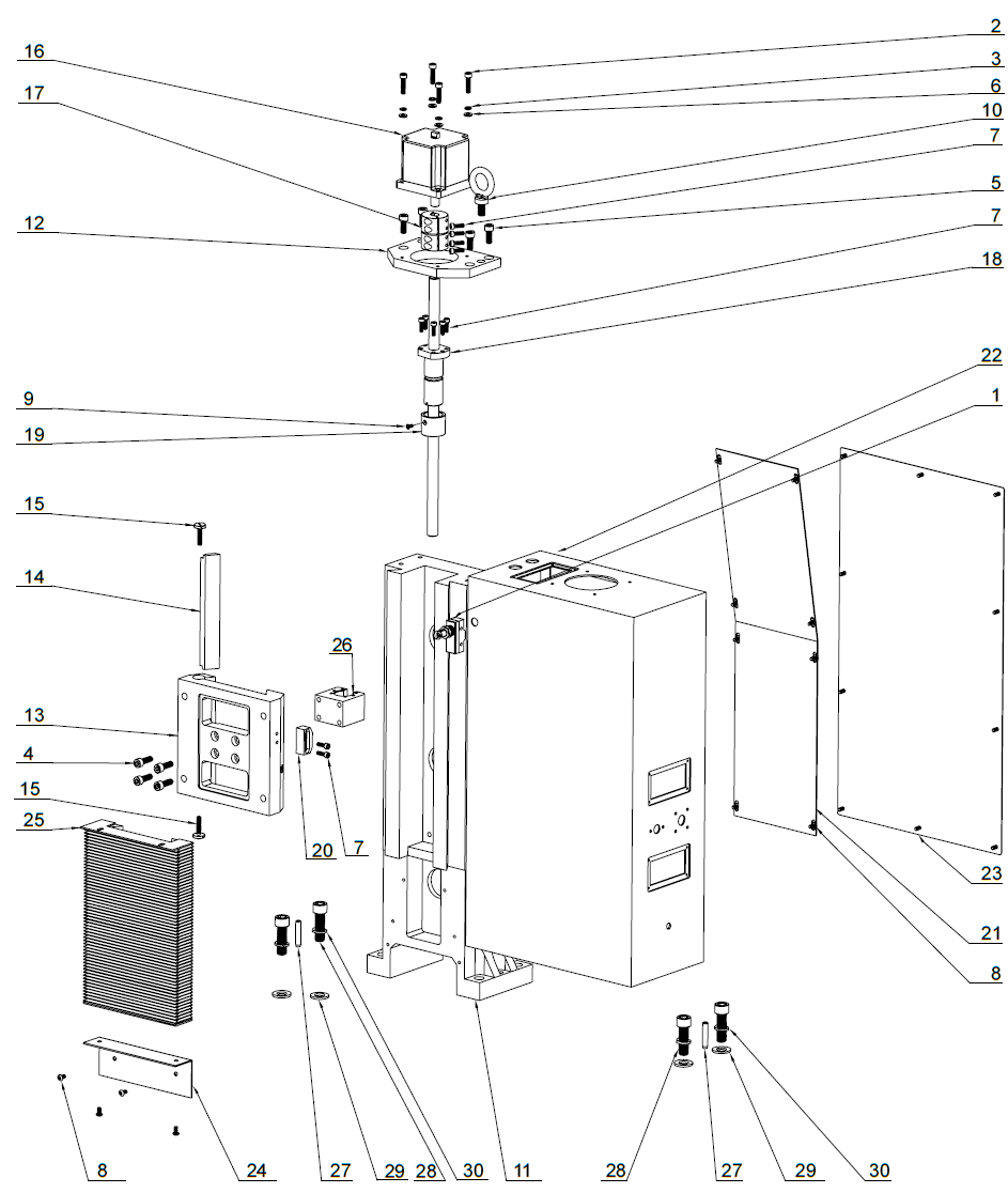

Z-Axis Column - PCNC 440
Alternative Part Numbers
X-/Z-Axis Limit Switch (PN 31860)
McMaster-Carr: 91290A330
Lock Washer
McMaster-Carr: 91169A180
Screw, Socket Head Cap, M8 × 25 mm
McMaster-Carr: 91290A432
Screw, Socket Head Cap, M8 × 20 mm
McMaster-Carr: 91290A426
Washer, Flat, M6
McMaster-Carr: 91455A120
Screw, Socket Head Cap, M5 × 16 mm
McMaster-Carr: 91290A232
Screw, Button Head Cap, M5 × 0.8 - 10
McMaster-Carr: 91239A224
Screw, Flat Head Cap, M3 × 6 mm
McMaster-Carr: 91420A116
Eyebolt, M10
McMaster-Carr: 3040T140
11
Z-column*
12
Z-motor Plate*
13
Z-saddle*
14
Z-gib*
15
Gib Screw, PCNC 440 (PN 35781)
16
Z-Axis Stepper Motor Assembly, PCNC 440 (PN 35782)
17
Z-coupling 0.5 in.-16 mm (PN 35783)
18
Z-axis 16 mm Ballscrew and Nut (PN 35784)
19
Z-ballscrew Bumper (PN 35785)
20
Z-switch Dog*
21
Z-column Cover*
22
Electrical Cabinet*
23
Electrical Cabinet Cover*
24
Z-Bellows Bracket (PN 35790)
25
Z-Axis Bellows Cover, PCNC 440 (PN 35791)
26
Z-ballnut Bracket*
27
Pull Dowel, M8 × 40 mm*
28
Screw, Socket Head Cap, M14 × 45 mm
McMaster-Carr: 91290A727
29
Washer, Flat, M14
McMaster-Carr: 91455A160
30
Washer, Split Lock, M14
McMaster-Carr: 91190A580
