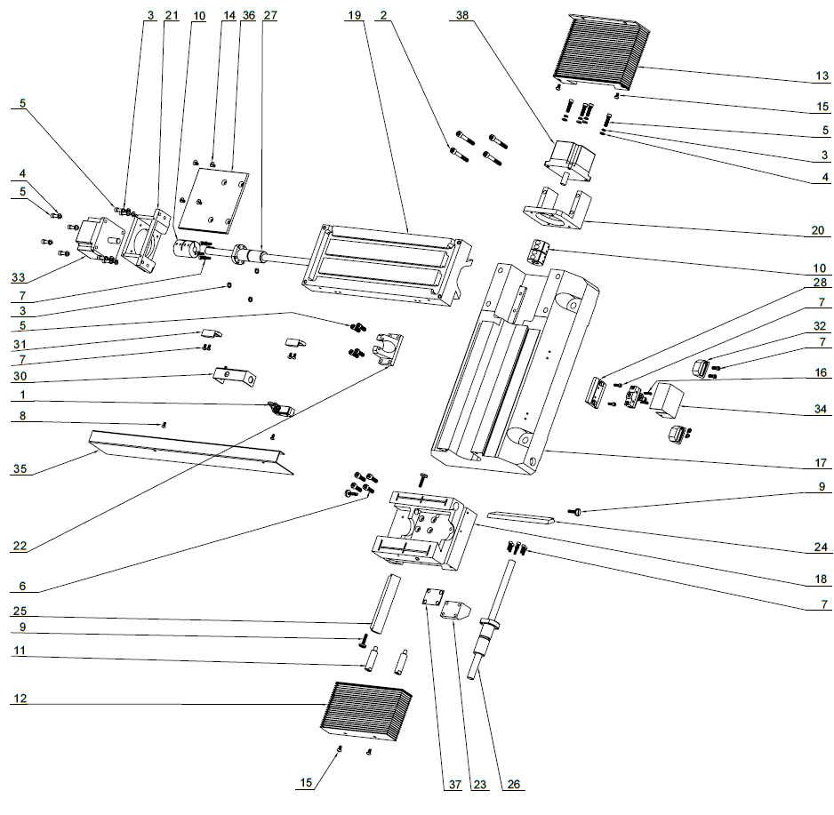

X-Y Axis - PCNC 440
Alternative Part Number
X-/Z-Axis Limit Switch (PN 31860)
Screw, Socket Head Cap, M8 × 55 mm
McMaster-Carr: 91290A452
Washer, Split Lock, M6
McMaster-Carr: 91169A180
Washer, Flat, M6
McMaster-Carr: 91455A120
McMaster-Carr: 91290A330
Screw, Socket Head Cap, M8 × 25 mm
McMaster-Carr: 91290A432
Screw, Socket Head Cap, M5 × 16 mm
McMaster-Carr: 91290A232
Screw, Button Head Cap, M5 × 10 mm
McMaster-Carr: 91239A224
Gib Screw, PCNC 440 (PN 35781)
Coupling 0.5 in.-16 mm (PN 35783)
11
Bellows Stand Off (PN 35793)
12
Y-Axis Front Bellows Cover, PCNC 440 (PN 35794)
13
Y-Axis Rear Bellows Cover, PCNC 440 (PN 35795)
14
Screw, Flat Head, M6 × 10 mm
McMaster-Carr: 91294A234
15
Screw, Button Head Cap, M6 × 10 mm
McMaster-Carr: 91239A316
16
Screw, Pan Head Machine, M3 × 20 mm
McMaster-Carr: 92005A128
17
Machine Base*
18
X-Y Saddle*
19
Machine Table*
20
Y-Motor Mount*
21
X-Motor Mount (PN 35812)
22
X-Ball Nut Bracket*
23
Y-Ball Nut Bracket*
24
X-Gib (PN 35815)
25
Y-Gib (PN 35816)
26
Y-Axis 16 mm Ballscrew and Nut (PN 35818)
27
X-Axis 16 mm Ballscrew and Nut (PN 35817)
28
Y-Switch Plate (PN 35819)
29
Y-Switch Bracket (PN 35820)
30
X-Switch Bracket (PN 35821)
31
X-Switch Dog (PN 35822)
32
Y-Switch Dog (PN 35823)
33
X-Axis Stepper Motor Assembly, PCNC 440 (PN 52930)
34
Y-switch Cover (PN 35825)
35
Front Drip Guard (PN 35826)
36
Table Tray (PN 35827)
37
Y-Ball Nut Shim*
38
Y-Axis Stepper Motor Assembly, PCNC 440 (PN 52929)
