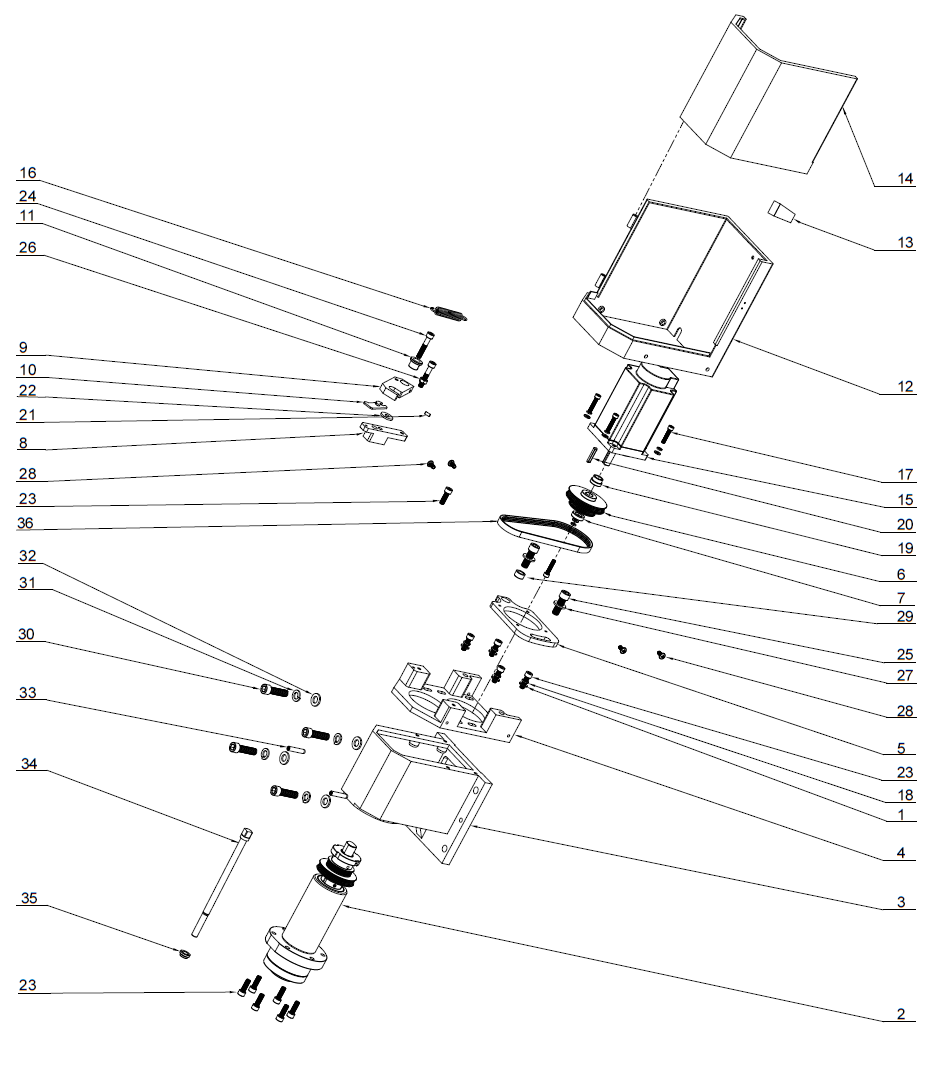

Spindle Head - PCNC 440
Alternative Part Numbers
M8 Flat Washer
McMaster-Carr: 91166A270
PCNC 440 Spindle Cartridge (PN 33163)
Spindle Head*
Spindle Motor Mount*
Motor Pivot Plate*
Spindle Motor Pulley (PN 35744)
Pulley Washer*
Spindle Lock Block (PN 35746)
Spindle Lock, PCNC 440 (PN 35747)
Door Jamb*
11
Jamb Bushing*
12
Spindle Motor Cover (PN 35750)
13
Spindle Cover Latch (PN 37312)
14
Motor Cover Door (PN 35751)
15
Spindle Motor (PN 35422)
16
Spindle Lock Spring*
17
Screw, Socket Head Cap, M6 × 30 mm
McMaster-Carr: 91290A332
18
Lock Washer
McMaster-Carr: 91169A180
19
Spindle Motor Pulley Bushing (PN 35756)
20
Spindle Motor Key*
21
Dowel, M5 × 10 mm*
22
Plastic Washer*
23
Screw, Socket Head Cap, M8 × 25 mm
McMaster-Carr: 91290A432
24
Screw, Socket Head Cap, M8 × 45 mm
McMaster-Carr: 91290A446
25
Screw, Socket Head Cap, M12 × 1.75 × 35
McMaster-Carr: 91290A620
26
Nut, Hex, M8
McMaster-Carr: 90591A161
27
Washer, Flat, M12
McMaster-Carr: 91166A290
28
Screw, Phillips Head Machine, M6 × 12 mm
McMaster-Carr: 92005A422
29
Spindle Motor Plate Bushing*
30
Screw, Socket Head Cap, M12 × 45 mm
McMaster-Carr: 91290A624
31
Washer, Split Lock, M12
McMaster-Carr: 91202A246
32
Washer, Flat, M12
33
Pull Dowel, M8 × 40 mm*
34
Drawbar for PCNC 440 (PN 33014)
35
Drawbar Bushing (PN 33168)
36
Belt: PCNC 440 Spindle (PN 35799)
