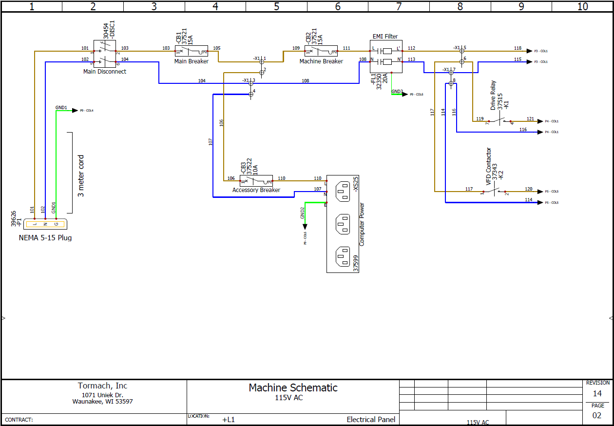

Electrical Schematics
115 Vac Power - 24R
