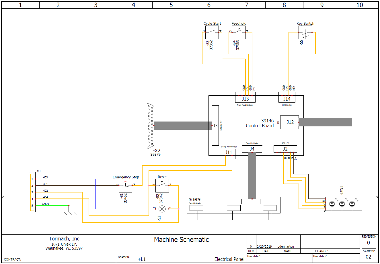

Electrical Schematics
Operator Console - 24R
