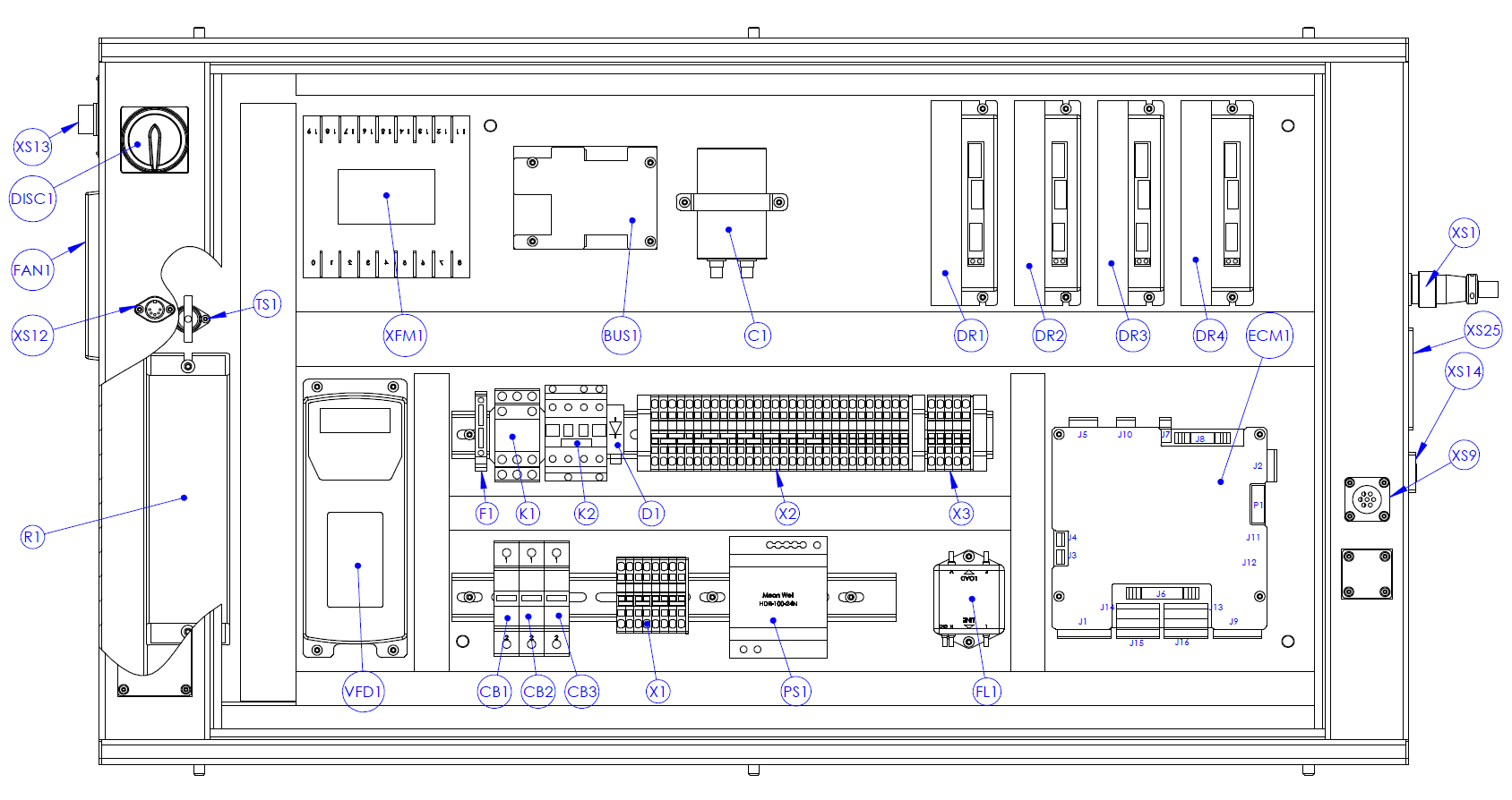

Ref
Part Number
XS13
37936
Chiller Alarm Connector
DISC1
30454
Main Disconnect
FAN1
37526
Cabinet Fan
XS12
30178
Acc. Port 2
TS1
37420
Brake Resistor Thermal Switch
R1
37906
Brake Resistor
VFD1
51124
Spindle Motor VFD
CB1
37521
Main Breaker
CB2
37521
Machine Breaker
CB3
37522
Acc. Breaker
X1
X1 Terminal Strip
PS1
51138
24 VDC Power Supply
FL1
32350
EMI Filter
ECM1
37506
Machine Control Board
F1
38924
38693
Fuse Holder
Fuse
K1
37515
Drive Relay
K2
37343
VFD Contactor
D1
37514
Flyback Protection Diode
X2
34127
X2 Terminal Strip
X3
34127
X3 Terminal Strip
XFM1
30459
Drive Transformer
BUS1
32005
DC Bus Board
C1
30468
DC Bus Capacitor
DR1
53488
X-Axis Drive
DR2
53488
Y-Axis Drive
DR3
53488
Z-Axis Drive
DR4
32793
A-Axis Drive (Option)
XS9
30235
4th Axis Connector
XS14
34130
PPC Com Port
XS25
37351
Computer Power
XS1
37353
Operator Box Connector
