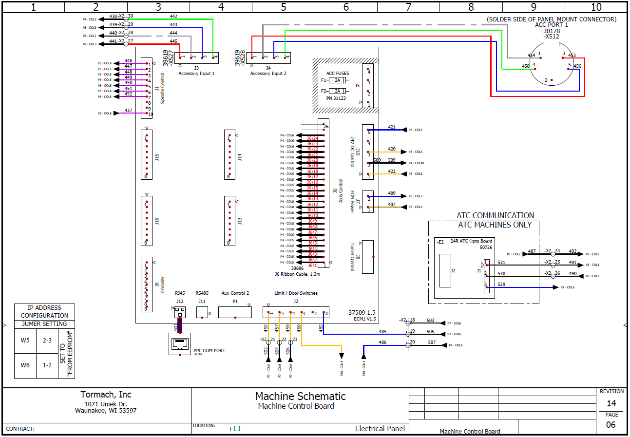

24R Knowledge Base
Electrical Schematics
Machine Control Board - 24R
