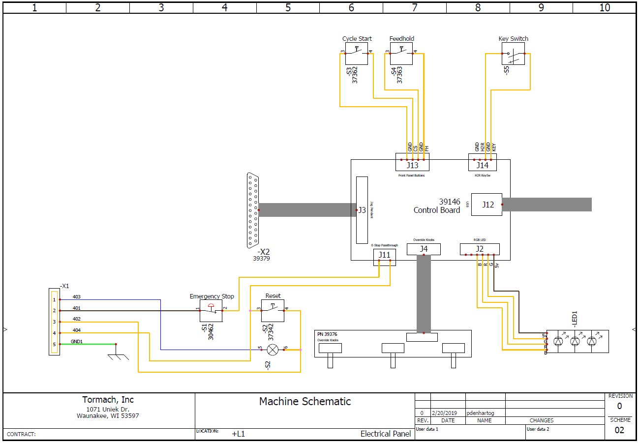

Operator Console Schematic - 8L (LA10506+)
If your serial number is 10505 or lower, refer to Tormach document TD10829.
