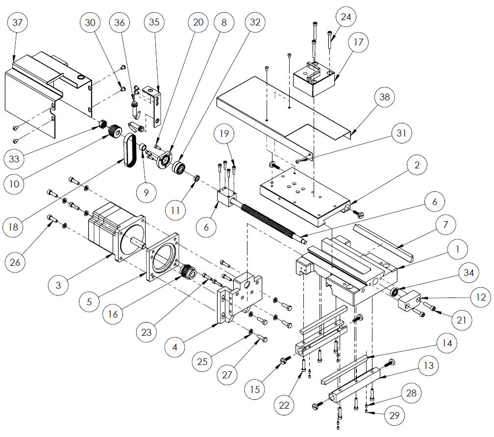

X-Axis - 8L
Alternative Part Number
X-Axis Base*
X-Axis Slide*
Stepper Motor (PN 39533)
X-Axis Motor Mount*
X-Axis Motor Adjustment Plate*
Ball Screw Assembly, 14 mm OD, 4 mm Pitch, 160 mm Threaded Length (PN 53414)
X-Axis Ball Screw, 160 mm Long
X-Axis Ball Screw Nut
X-Axis Gib (PN 37787)
X-Axis Ball Screw Retainer*
Spacer, 7.5 THK, 10 ID × 14.5 OD (PN 37797)
X-Axis Ball Screw Pulley (PN 37790)
11
Spacer, 3.5 THK, 10 ID × 14 OD (PN 37795)
12
X-Axis Ball Screw Support*
13
Gib Retainer, Z-Axis, 8L Lathe (PN 37785)
14
Gib, Z-Axis, 8L Lathe (PN 37786)
15
Gib Adjustment Screw, Z-Axis, 8L Lathe (PN 37799)
16
X-Axis Motor Pulley (PN 37849)
17
Quick Change Tool Post Riser (PN 50603)
18
X-Axis Motor Belt, 8L (PN 53687)
19
Screw, Socket Head Cap, M4 × 0.7 - 16
McMaster-Carr: 91290A154
20
Screw, Socket Head Cap, M4 × 0.7 - 12
McMaster-Carr: 91290A148
21
McMaster-Carr: 91290A330
22
McMaster-Carr: 91290A252
23
McMaster-Carr: 91290A242
24
Screw, Socket Head Cap, M5 × 0.8 - 40
McMaster-Carr: 91290A196
25
Washer, Split Lock, M6
McMaster-Carr: 91169A180
26
Screw, Socket Head Cap, M6 × 1 - 20
McMaster-Carr: 91290A326
27
Screw, Hex Head Cap, M6 × 1 - 20
McMaster-Carr: 91280A330
28
Screw, Extended Tip Set, M4 × 0.7 - 8, (2.25 mm × 2.5 mm Dia Tip) Black Oxide Steel
McMaster-Carr: 92905A087
29
Screw, Flat Point Set, M4 × 0.7 - 6
McMaster-Carr: 93245A112
30
Screw, Button Head Cap, M5 × 0.8 - 8, Stainless Steel
McMaster-Carr: 92095A207
31
Screw, Button Head Cap, M4 × 0.7 - 8, Stainless Steel
McMaster-Carr: 92095A189
32
Bearing, 15 Degree Angular Contact, 7000C, 10 mm ID × 26 mm OD, 8 mm Wide, Sealed, Matched Set of 2 (PN 53685)
33
Lock Nut, M10, 8L (PN 51027)
34
Bearing, Deep Groove, 698, 8 mm × 19 mm × 6 mm (PN 51037)
35
Bracket, X-Axis Motor Cover, 8L (PN 54780)
36
N/C Inductive Proximity Sensor (PN 33334)
37
X-Axis Motor Cover (PN 50522)
38
X-Axis Table Cover (PN 50523)
