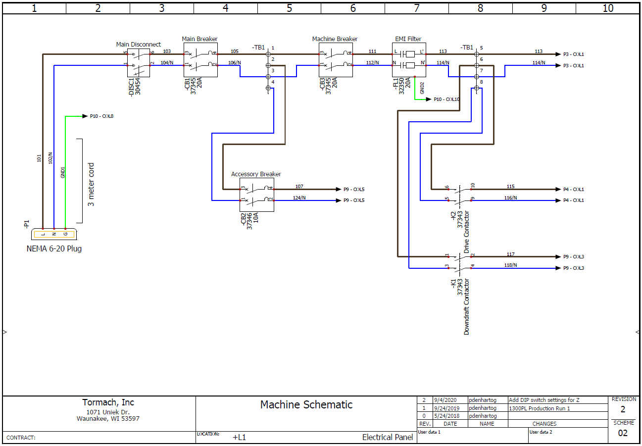

Electrical Schematics
230 Vac Power - 1300PL
