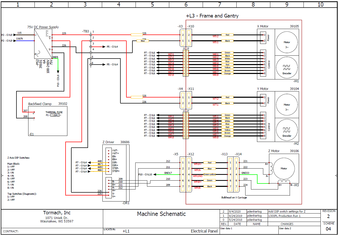

24 Vdc Controls - 1300PL
Axis Driver Control - 1300PL
