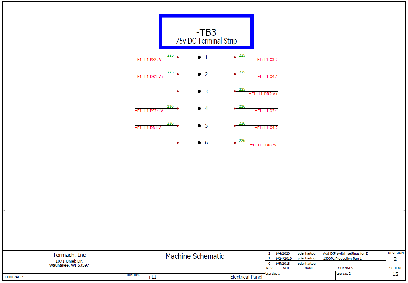

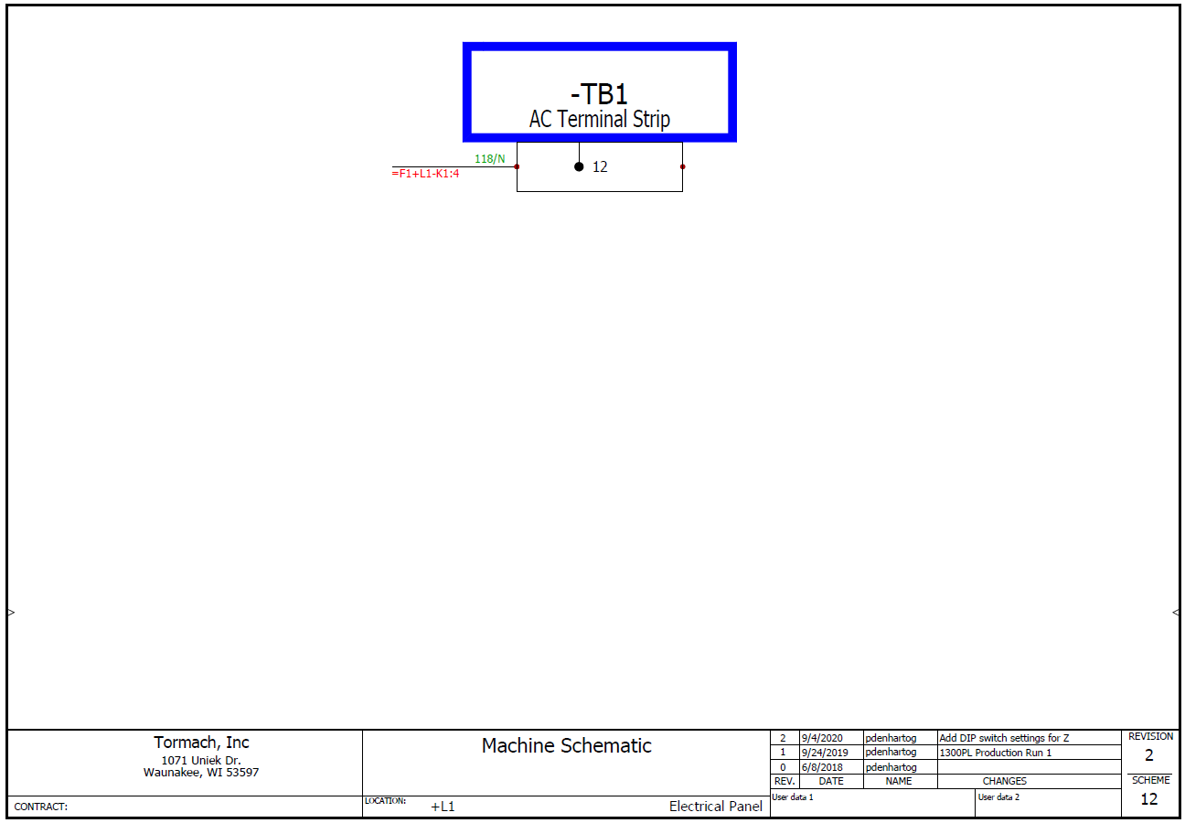

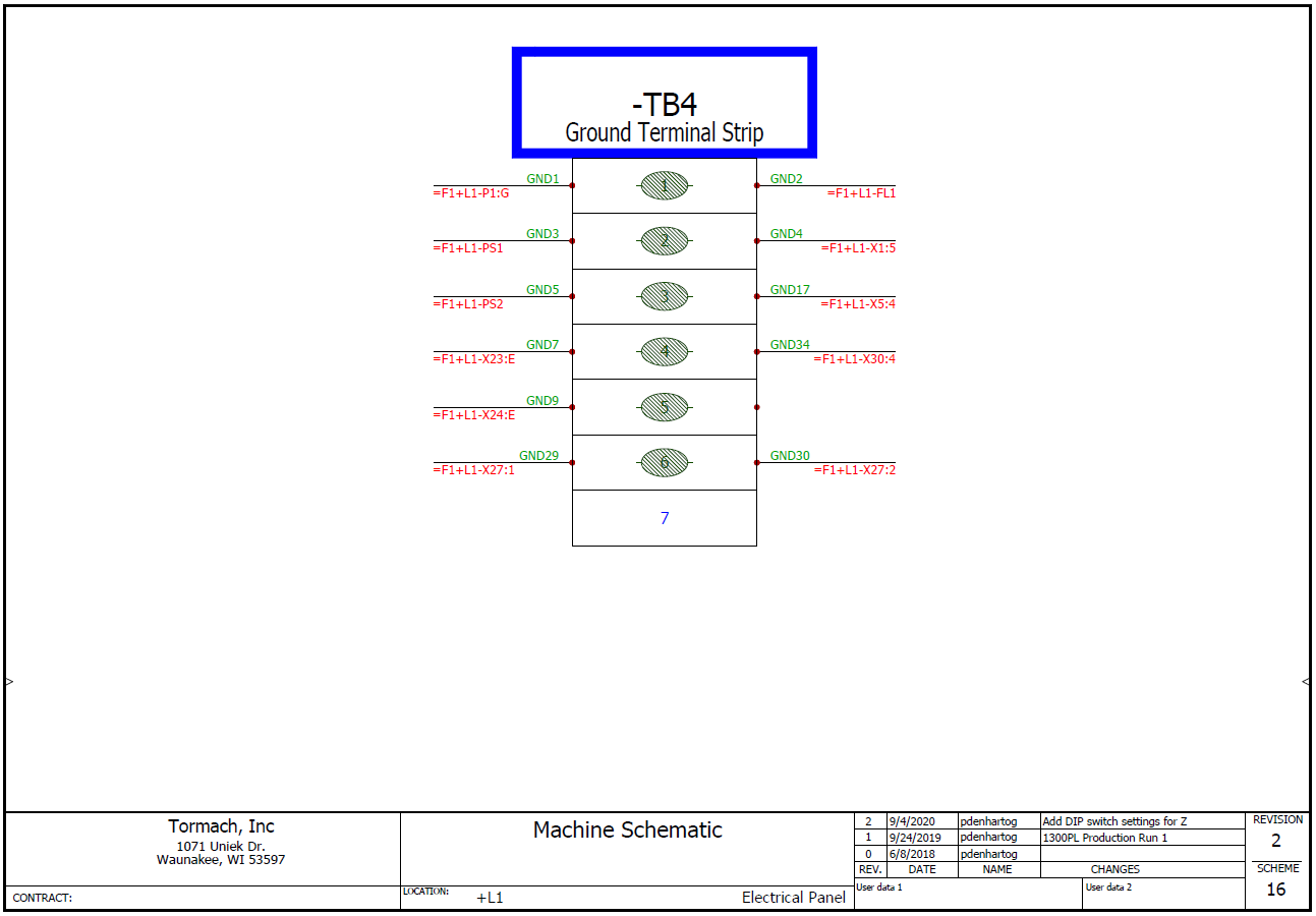

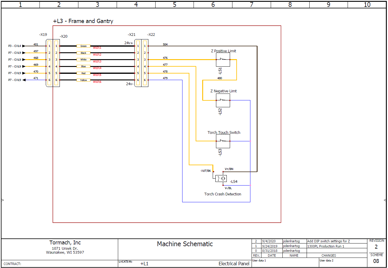

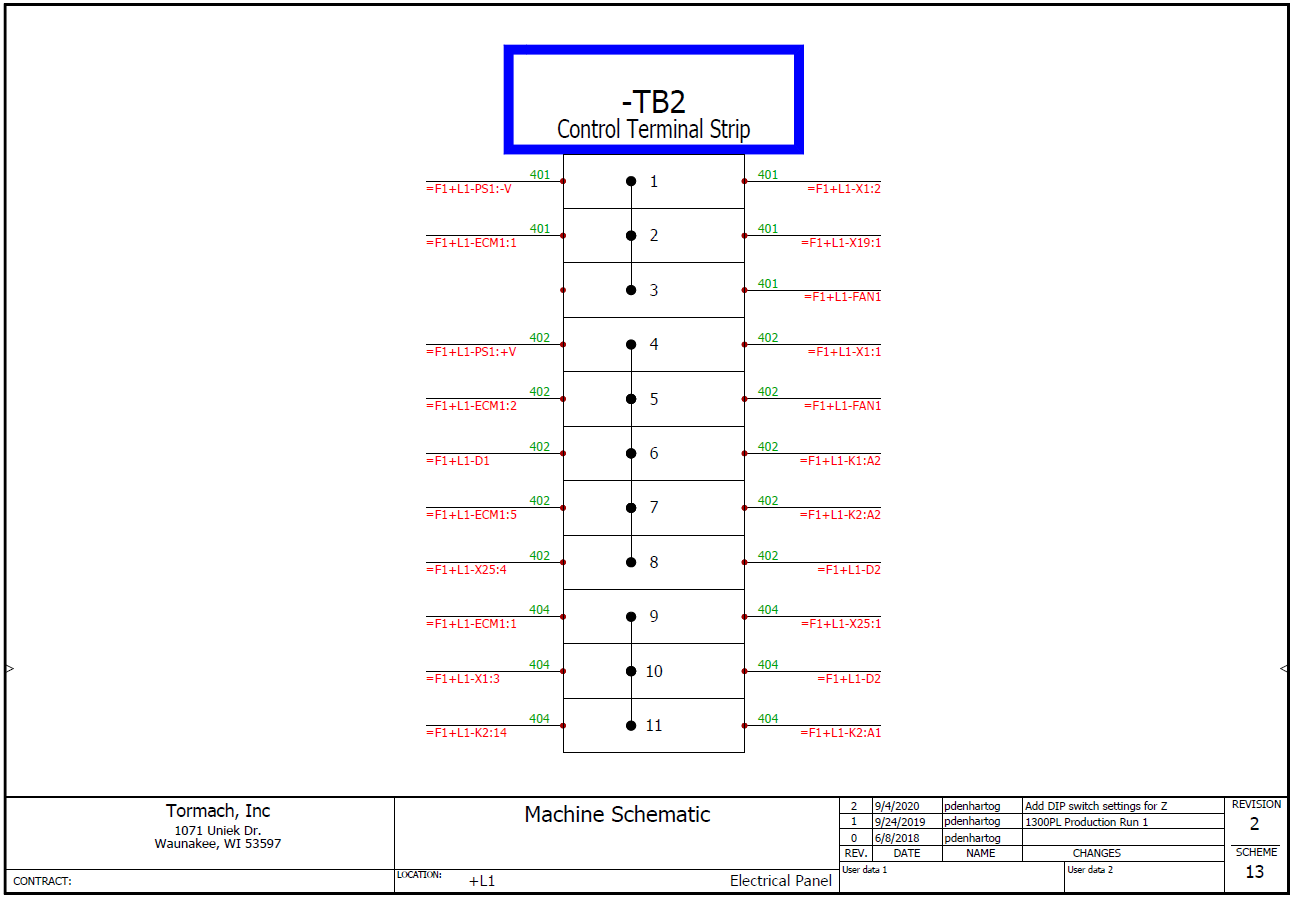

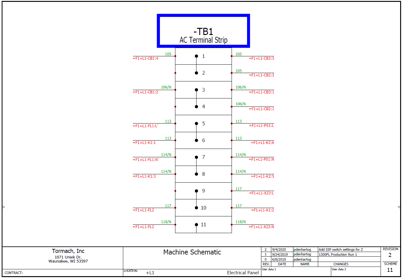

Electrical Schematics
230 Vac Power - 1300PL
24 Vdc Controls - 1300PL
Axis Driver Control - 1300PL
Grounds - 1300PL

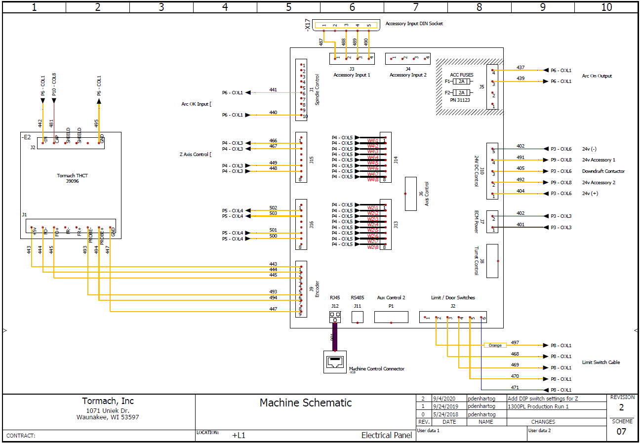

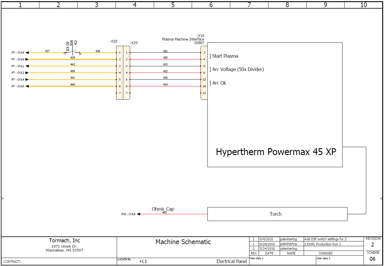

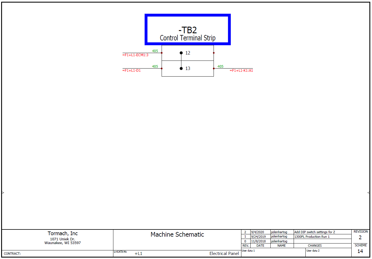

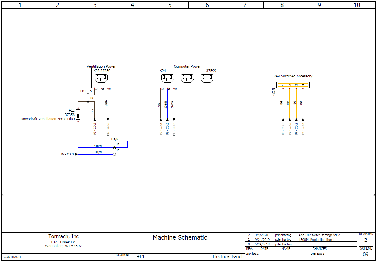

1300PL Knowledge Base
