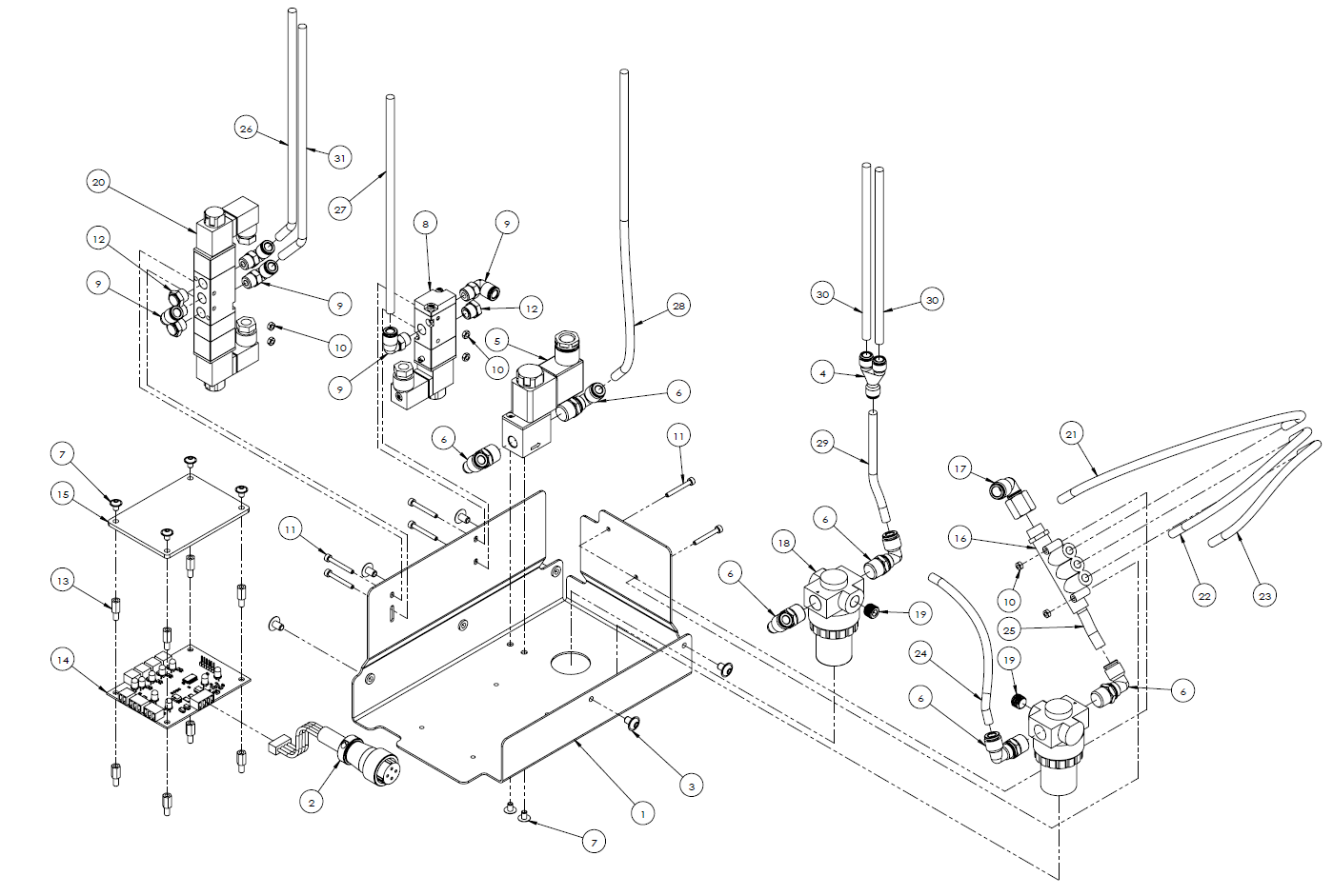

24R ATC Solenoid Control Panel (PN 50661)
Circular Connector, Plug, PVC Jacket, 20 mm, 4-Pin Male, Solder (PN 35193)1
Screw, Button Head Cap, Flanged M5 × 0.8 - 8, 18-8 Stainless Steel
McMaster-Carr: 90909A721
Fitting, Wye, 1/4 in. PTC (PN 38550)
Two Port, Two Way, Two Position, 24 Vdc, Single Solenoid Valve, 1/4 in. (inlet/outlet), Normally Closed (PN 38827)
Fitting, Elbow, 1/4 in. NPT (Male) - 1/4 in. PTC (PN 31324)
Screw, Button Head Cap, Flanged M4 × 0.7 - 6, 18-8 Stainless Steel
McMaster-Carr: 90909A716
Three Port, Three Way, Two Position, 24 Vdc, Single Solenoid Valve, 1/8 in. (inlet/outlet), 1/8 in. (exhaust) (PN 50647)
Fitting, Elbow, 1/8 in. NPT (Male) - 1/4 in. PTC (PN 34886)
Nut, Hex, M3, Zinc Plated
McMaster-Carr: 90591A250
11
Screw, Socket Head Cap, M3 × 0.5 - 25
McMaster-Carr: 91290A171
12
Ftg, Muffler (Flat), 1/8 NPT (PN 37297)
13
Standoff, 10 mm, M4 × 0.7 - 8 mm Male, M4 × 0.7 - 5 mm Female, Steel (PN 50765)
14
PCB, 24R ATC Board (PN 50683)
15
24R ATC Board Shield, Acrylic (PN 50766)
16
Fitting, Male Manifold, 1/4 in. NPT - 1X 5/16 in. PTC Ports - 3X 1/4 in. PTC Ports (PN 50685)
17
Fitting, Elbow, 1/4 in. NPT (Female) – 5/16 in. PTC (PN 50840)
18
Pressure Regulator, 1/4 in. NPT × 1/4 in. NPT, 1/8 in. NPT Gauge Port, 7-125 PSI, 150 PSI (PN 39356)
19
Fitting, Plug (Internal Hex), 1/8 in. NPT (Male), Brass (PN 35892)
20
Five Port, Four Way, Three Position, 24 Vdc, Double Solenoid Valve, 1/8 in. (inlet/outlet), 1/8 in. (exhaust), Exhausted Center Position (PN 50705)
21
Tubing, Polyethylene Air Line, 1/4 in. OD, Black, 35 cm Long (PN 31457)
22
Tubing, Polyethylene Air Line, 1/4 in. OD, Black, 20 cm Long (PN 31457)
23
Tubing, Polyethylene Air Line, 1/4 in. OD, Black, 14 cm Long (PN 31457)
24
25
Tubing, Polyethylene Air Line, 1/4 in. OD, Black, 5 cm Long (PN 31457)
26
Tubing, Polyethylene Air Line, 1/4 in. OD, Black, 125 cm Long (PN 31457)
27
Tubing, Polyethylene Air Line, 1/4 in. OD, Black, 140 cm Long (PN 31457)
28
29
Tubing, Polyethylene Air Line, 1/4 in. OD, Black, 23 cm Long (PN 31457)
30
Tubing, Polyethylene Air Line, 1/4 in. OD, Black, 115 cm Long (PN 31457)
31
124R ATC Cable Board Harness includes PN 35193, wires and board connector.
