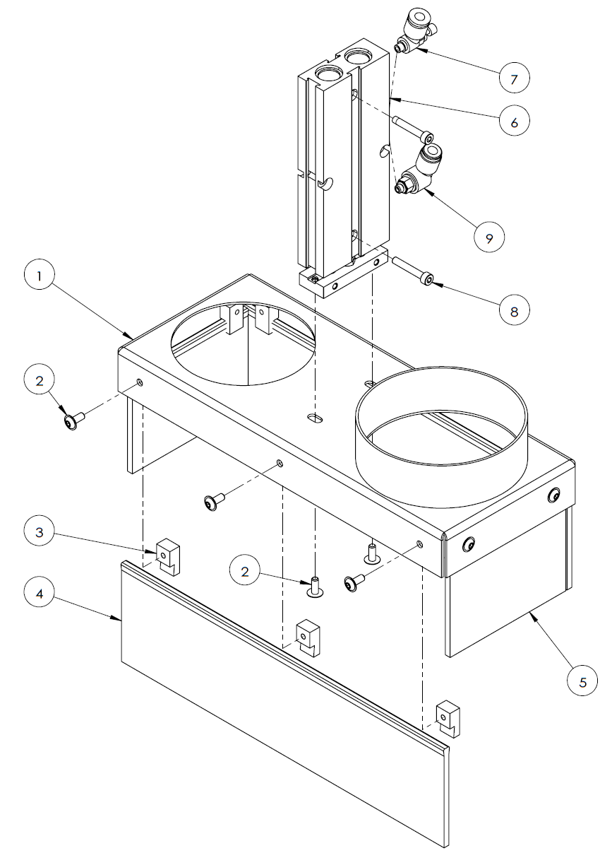

Lifting Dust Shoe Body, 80 mm, 24R ATC (PN 39089)
Screw, Button Head Cap, Flanged M4 × 0.7 - 10, 18-8 Stainless
McMaster-Carr: 90909A718
12
Dust Shoe Brushes Clamp (PN 50376)
Brushes, Dust Shoe, 4 mm wide × 70 mm tall 26.5 cm (PN 52948)
Brushes, Dust Shoe, 4 mm wide × 70 mm tall 9.5 cm (PN 52940)
Air Cylinder, Double Acting, Double Rod, 16 mm Bore × 80 mm Stroke (PN 50648)
Fitting, Metering Out Elbow, M5 × 0.8 (Male) - 6 mm PTC (PN 51157)
Screw, Socket Head Cap, M4 × 0.7 - 25
McMaster-Carr: 91290A176
Fitting, Elbow, M5 × 0.8 (Male) - 6 mm PTC (PN 50652)
