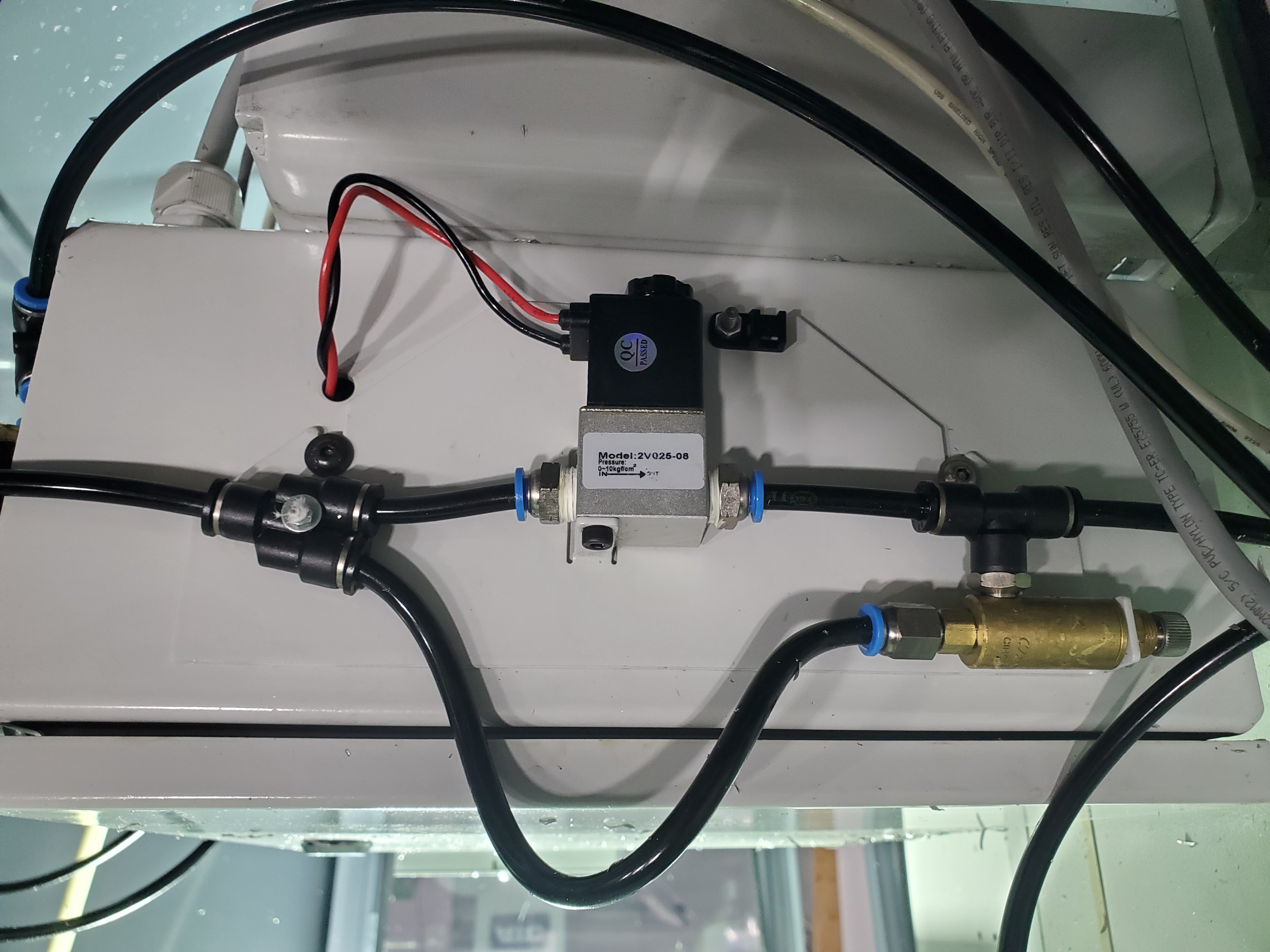

The brake assembly is located on the back of the ATC.

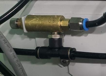

  3. Start by turning the brass needle valve clockwise 1/4 turn.
  1. Execute a tool change, and check for improvement. If none is seen, continue the process from step 3, until the early drop stops.
