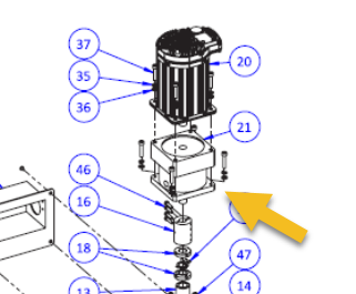

  3. If the error is still present, power down the machine. Inside the electrical cabinet, and locate wire 435 on the J10 connector on the ECM board. Remove this wire, and power back up and attempt to come out of Reset and E-Stop condition. Attempt the reference only the X and Y axis. As wire 435 is the Z brake wire, so the brake will still be applied to the axis. If you are able to come out of Estop and Reference X and Y, the Z brake needs to be replaced. (PN 38399)
Z Axis Brake
