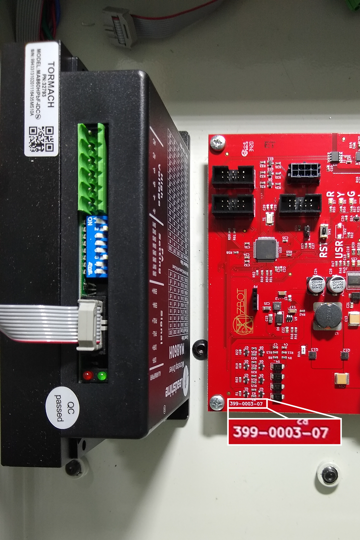

  3. Identify the current ATC board's version number. Find the number printed on the bottom left-hand corner of the control board (as shown in the following image).
  1. Depending on the number that you identified in Step 3, do one of the following:
    1. 399-0003-06 (ATC control board v1.6) or 399-0003-07 (ATC control board v1.7) Go to Step 5.
    2. 399-0003-10 (ATC control board v1.10) Go to Step 7.

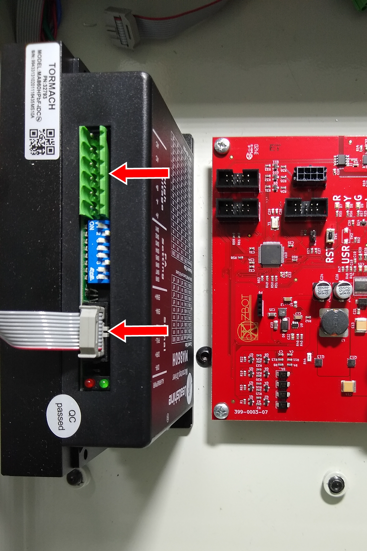

  2. Disconnect and remove the two cables connected to both the stepper driver and the control board.
  1. Remove the stepper driver from the ATC.
  2. Disconnect all cabling from the control board.

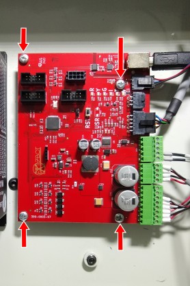

  3. Remove the old control board from the ATC. Set aside its four screws for reuse later in this procedure.

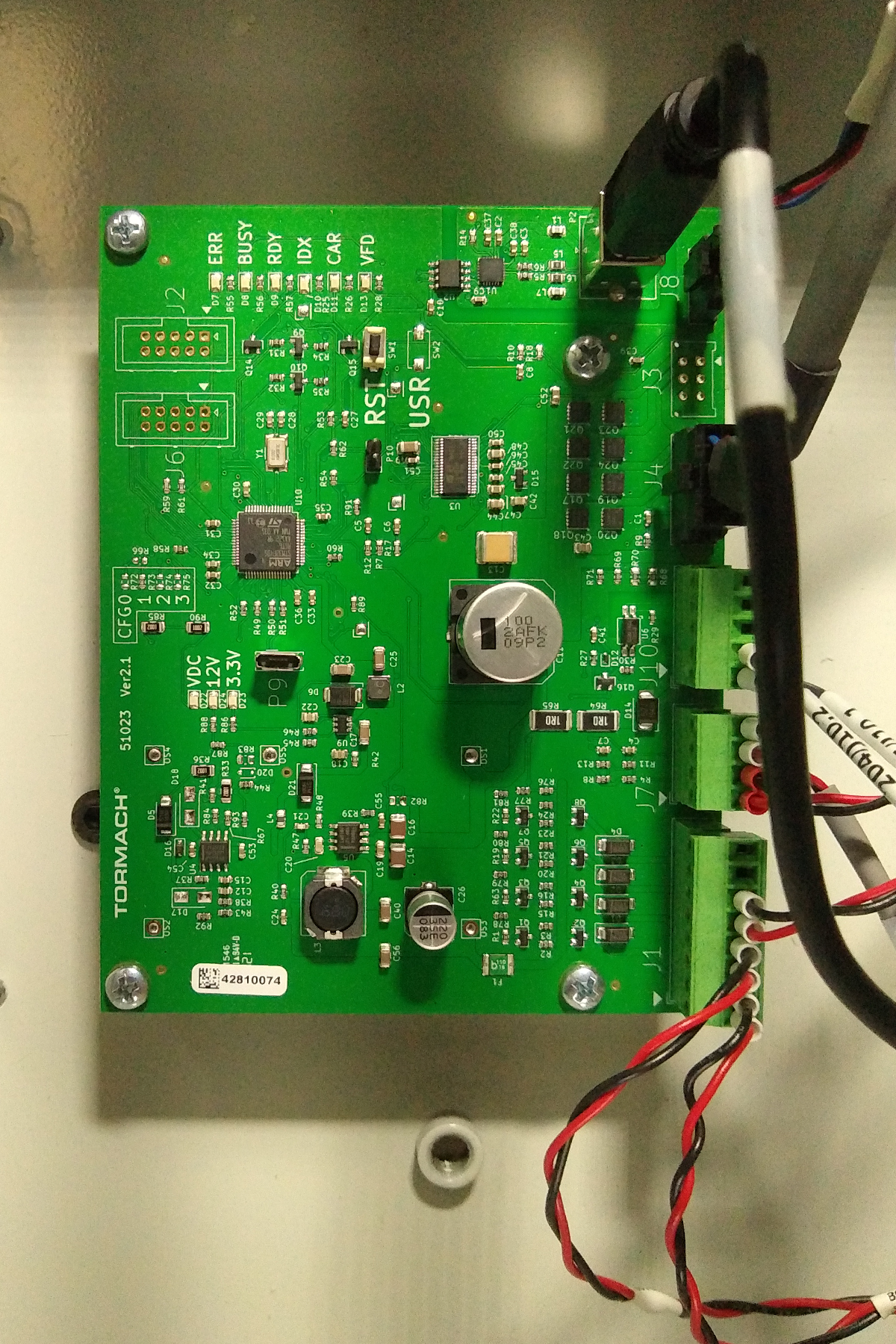

  1. Install the new ATC module into the enclosure using the four screws that you set aside in "Disassembly".
  2. Make all connections to the ATC control board as shown in the following image.
